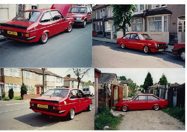

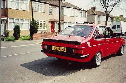

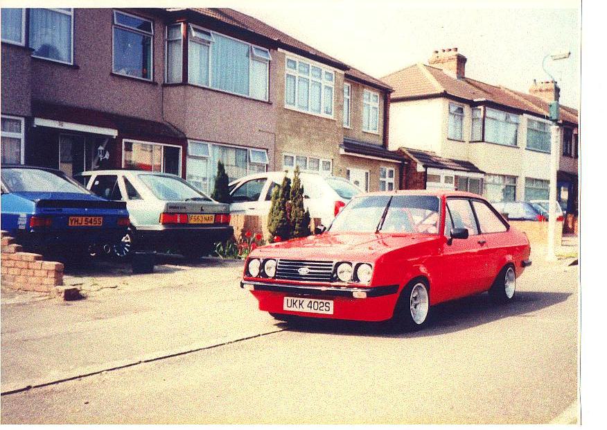

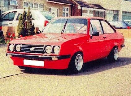

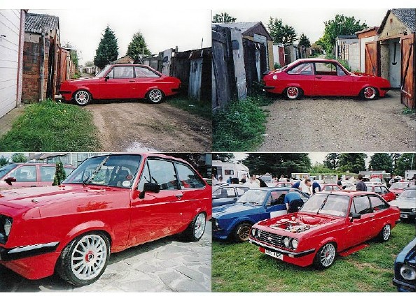

                          #42
                          Re: Kevmk2 - Mk2 Escort - YB Cosworth Turbo
                          Found a few more pics Gary

                            #43

                              #44
                              I can see my car in the background there Kev,proper car

                                #45
                                cheers kev , it looks much better on the 13 inch wheels , put em back on , don't worry about only having small brakes under them , just only use full boost on clear straights !!!!!!
