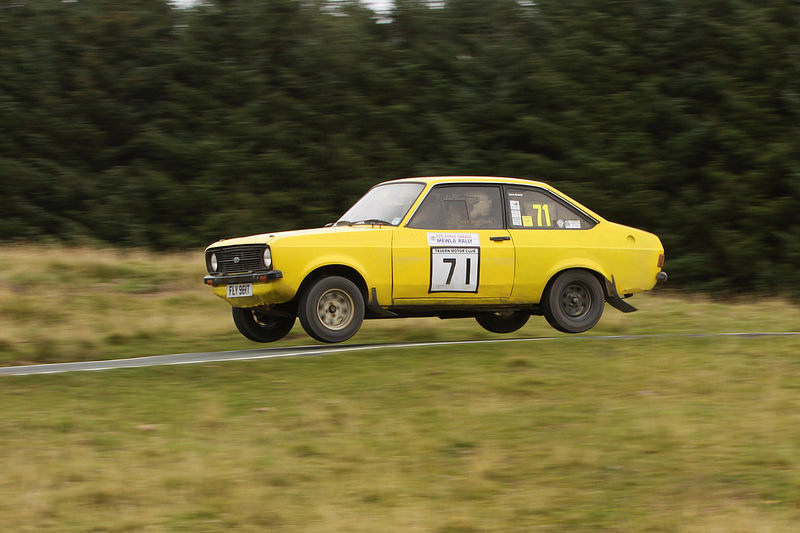

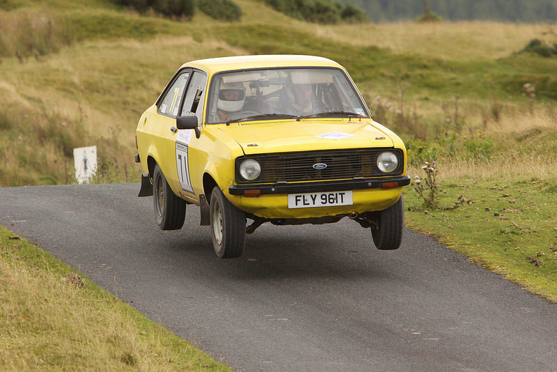

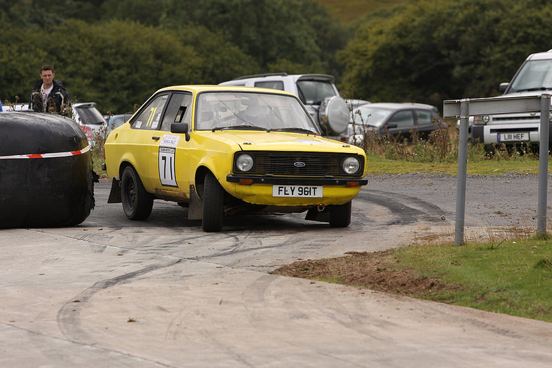

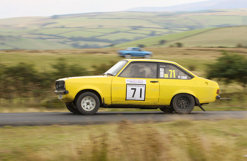

    Some great pics there Marchy, thanks for posting them up

    My photos from Epynt the number plate made us laugh
