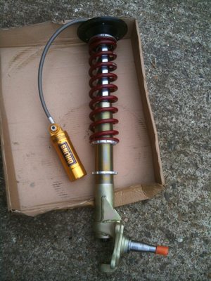

I've got my new Ohlins dampers for the front to match my rears now.
Rears are 2 way, seperate bump and rebound adjustment but I went the whole hog and went for 3 way fronts, seperate high and low speed bump and rebound adjustment. They use a Bilstein casing with all new Ohlins internals. I supplied my Gartrac top mounts and they did the rest.

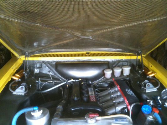

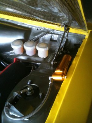

Canisters are now mounted in a similar place but on proper mounts, not just cable tied to the bonnet hinge like some I have seen. This pic was taken before but it was too dark by the time I had finished
They sit up the back to keep them out of the way and hopefully stay clean.

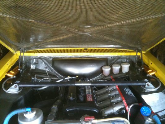

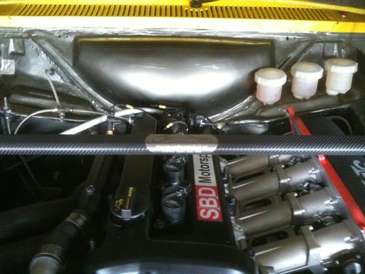

I also got my new Carbonfibre strut brace from SP racing, looks really nice. Cheers Shaun
Big thanks to Steve at SBD for helping me spec the dampers and do the necessary mods to get the right castor adjustment on the top mount, onto the next rally now. Tom and I are planning on doing a couple of pace note events either over Otterburn or Epynt. I looks forward to getting some air now it's got better damping
