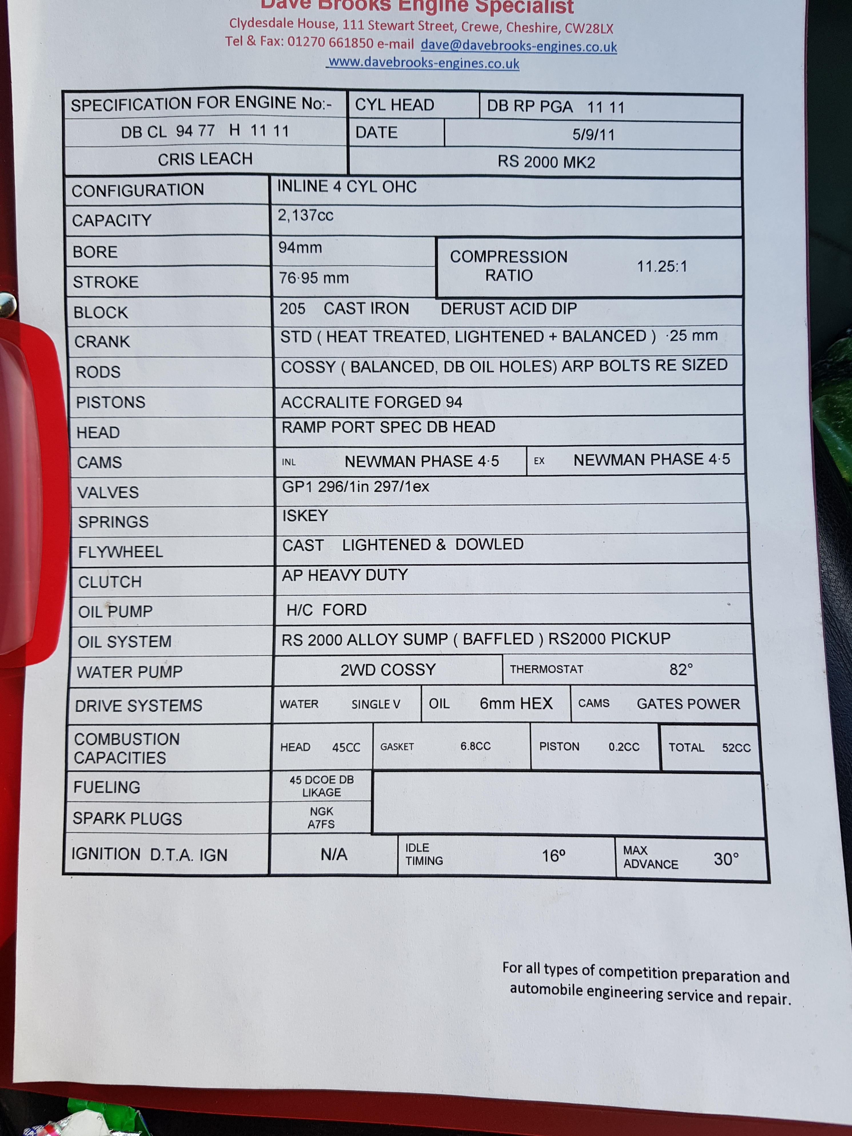

    A nice professional spec sheet there from DB.

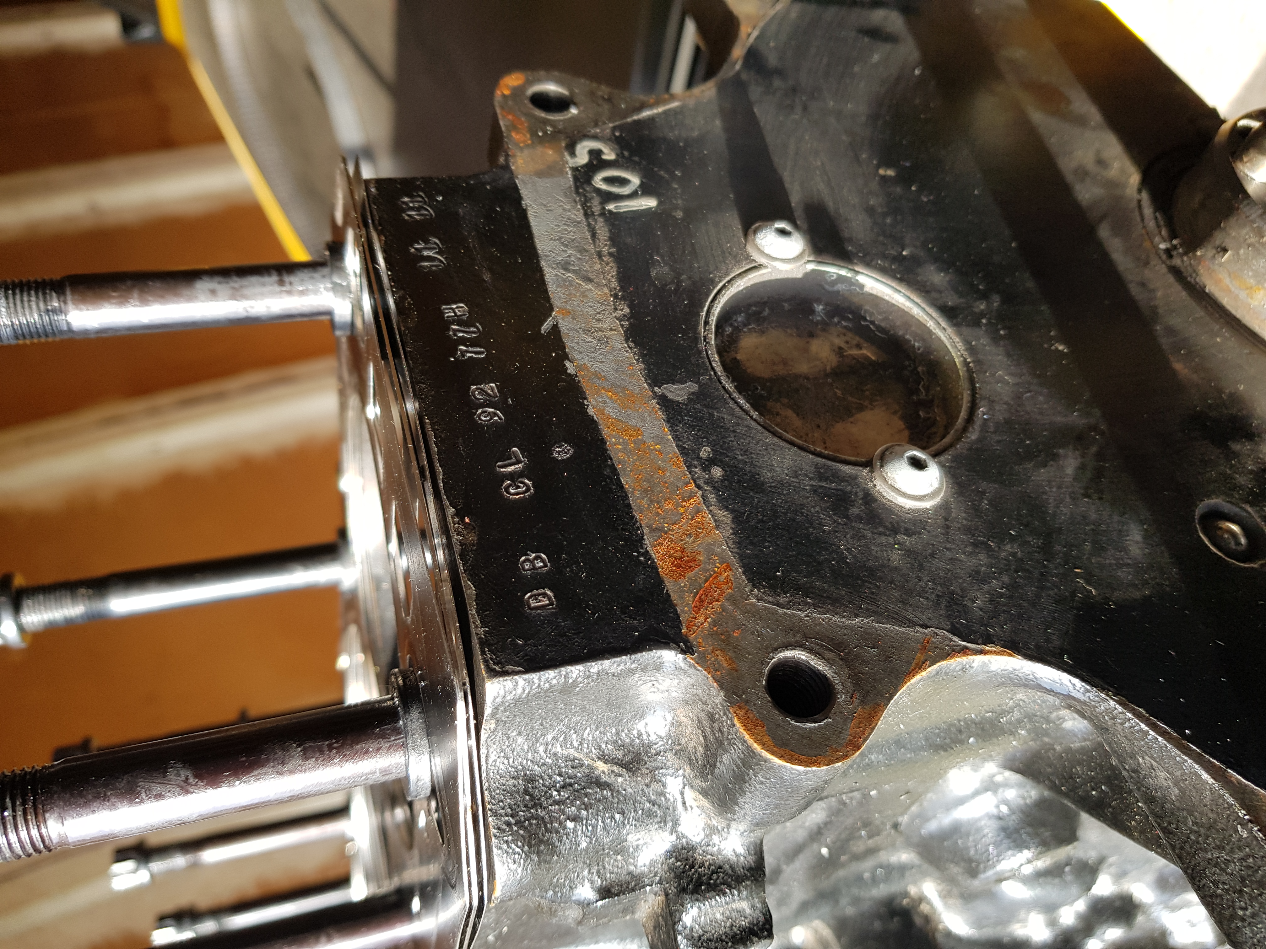

            The spec sheet has a slightly different number to the one stamped into the block is that a typo?
              Well noticed..

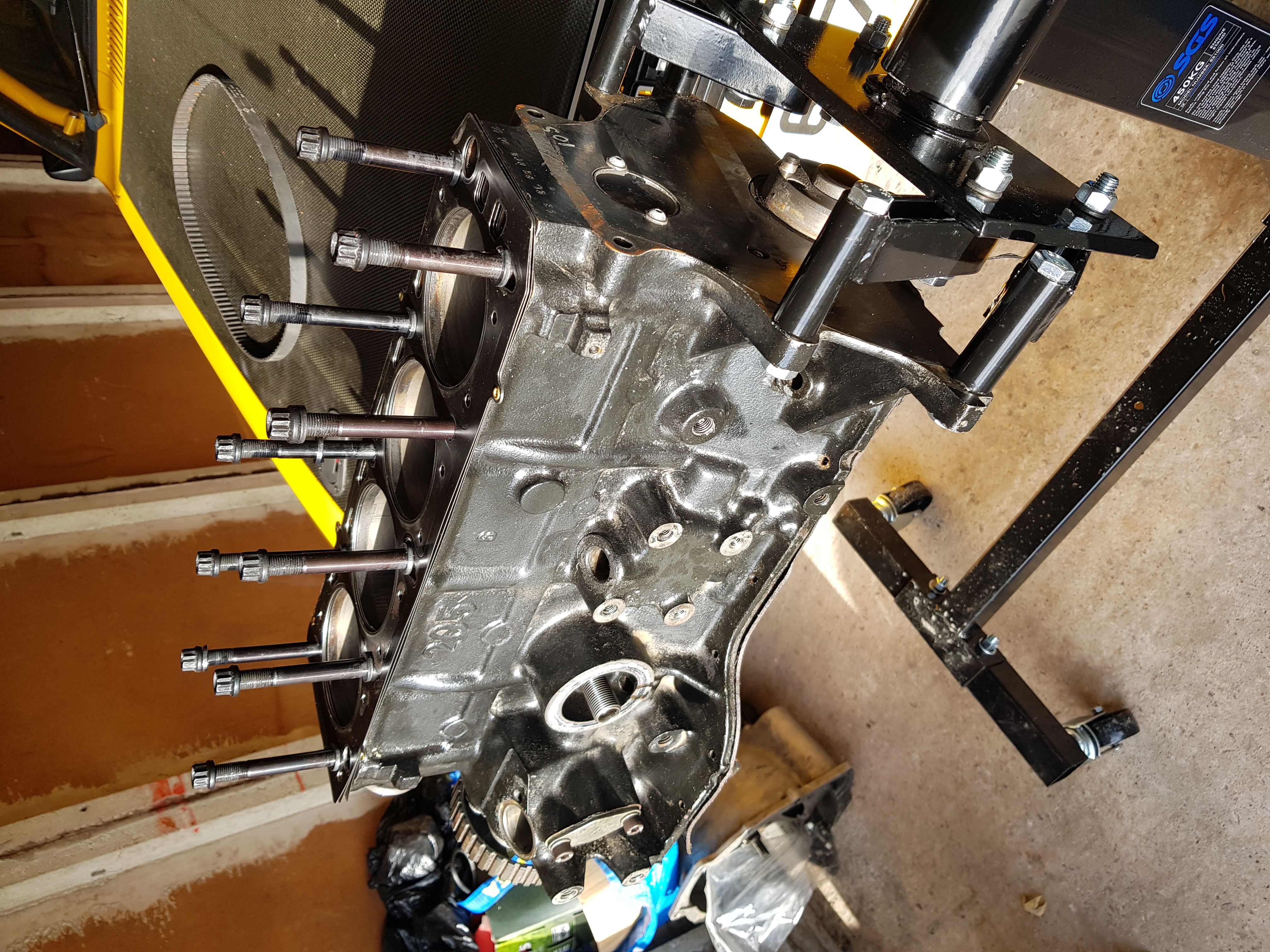

                                I bought the bottom end off the guy that had the engine built by Dave Brooks, CL is his initials, not sure if it was originally built with 92mm bore then re-done to 94mm bore as that what it is now, and am assuming the 92/94 numbers refer to bore size. He's just had a steel bottom end built by brooks hence selling it. It had done 2 road rallies since last freshen up by Dave Brooks.
                                SRD cylinder head is now on the engine and is ready to go in imminently. Also bought the SRD exhaust manifold to go with the head which is a work of art. Waiting on Dave Brooks to finish some split inlet manifold at the mo.
