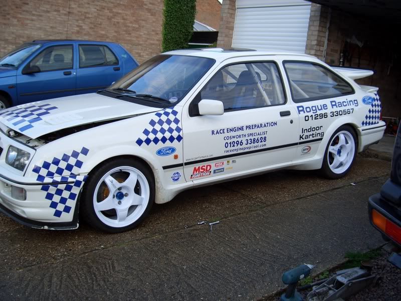

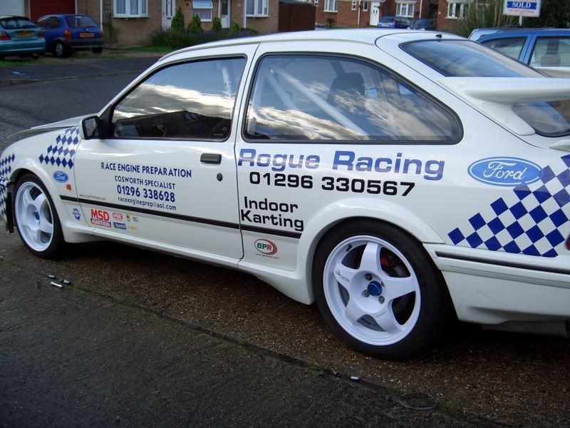

    All finished and ragging it around now
    A pair of rears lasted 2 tanks of fuel (12 gallon tank)
    No speedo so I don't know the mileage, around 120miles I would guess
