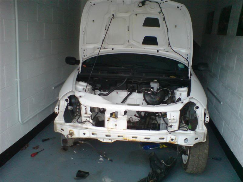

    So to cut a long story short, I decided to undertake the engine work myself, with the help of my mate (a qualified mechanic - so cheating a little!). The engine was well and truly screwed, having run lean and made a mess of the block. Cue spare engine, which happened to also have all the Ford Racing bits and next to zero miles on it. We used the best bits from both engines, along with getting new valve guides pressed into the (very trick!) Endura head.

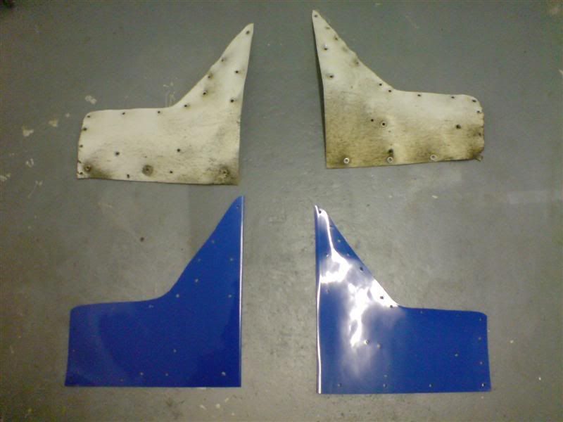

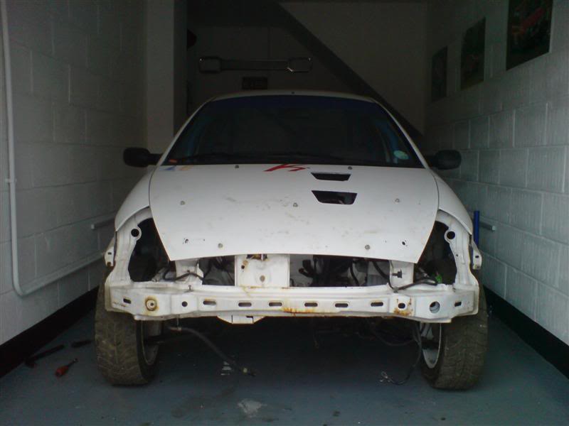

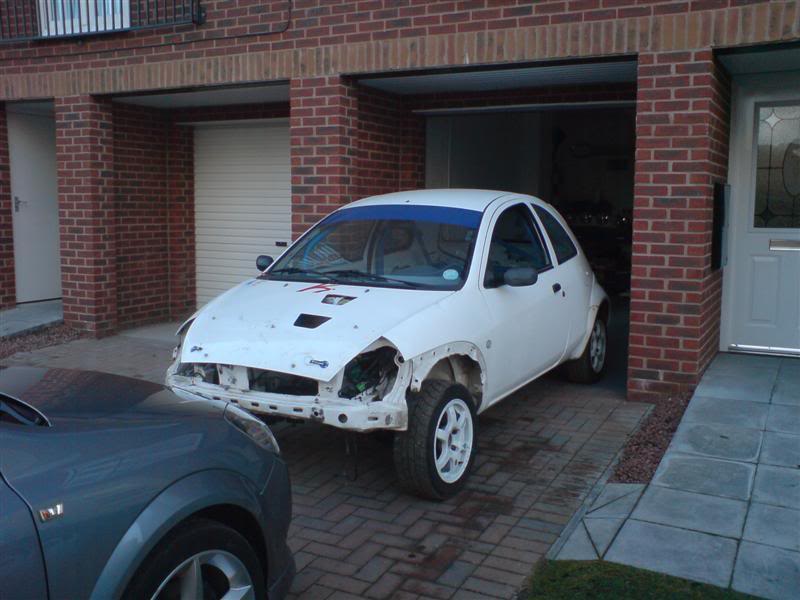

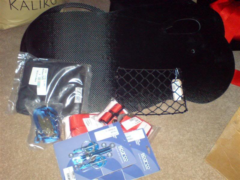

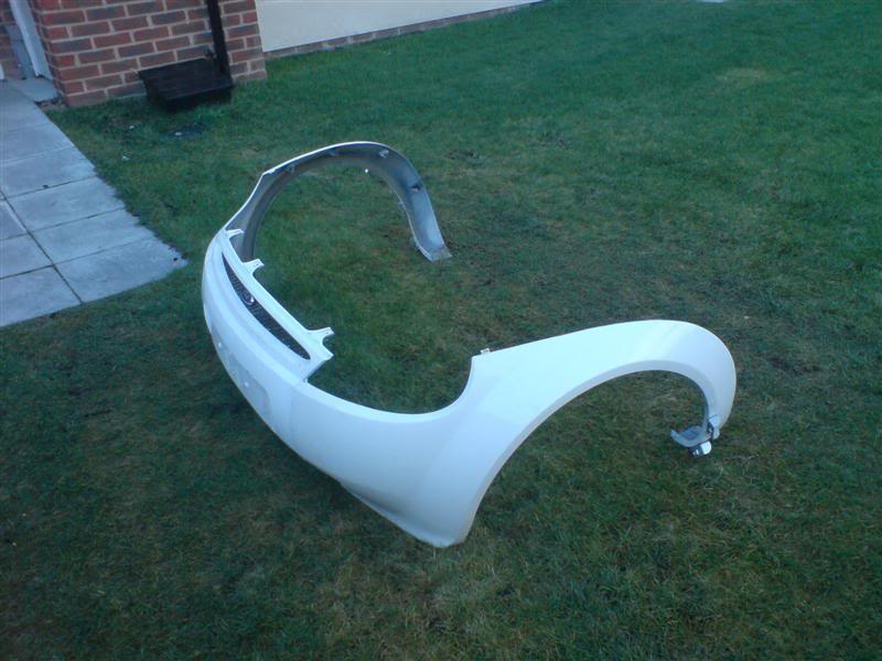

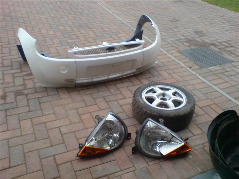

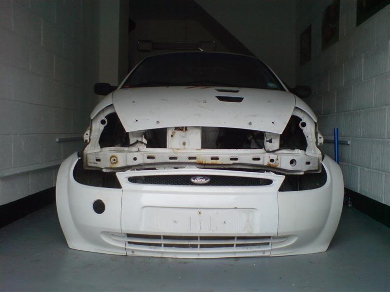

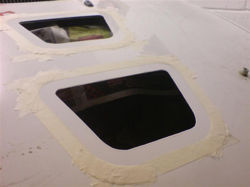

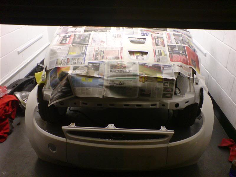

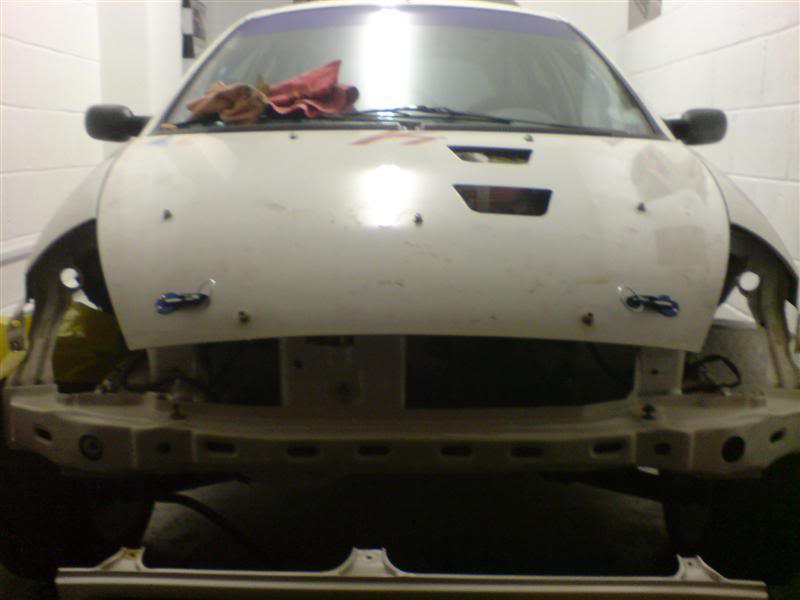

    Meanwhile, with the engine in bits at my mate's workshop the car was sitting looking a little used and sorry for itself in my garage at home. While I had sternly promised myself (and my girlfriend!!) that I wouldn't go to the lengths I had on the XR2 build for fear of not daring to use it for its intended purpose, I just had to pass the time while we waited for pockets of time here and there to build the engine back up. So, pretty much a full shell rebuild ensued (mainly a tidy up from top to bottom, but you get the idea), with new parts on the outside, inside and literally everything inspected, cleaned, tidied and replaced if necessary.
    The engine, as of the end of January is now in, and I'm awaiting an appointment with Bogg Brothers in North Yorkshire for a proper rolling road set up and a full suspension service for the Proflex. But at least it runs and is looking the part.
    I didn't plan a project as much as this one had been, but at this stage I find it easy (and somewhat relaxing) to sit back on the sofa as I write this and think "I'm glad things turned out the way they did". The engine failure has given me chance to check everything, tidy everything up and learn a hell of a lot that will no doubt come in useful when I'm competing, and generally maintaining the car.
    Anyway, without further a-do; and sorry that took so long, I fully intended it not to - some pictures to document my life (!) over the last few months...

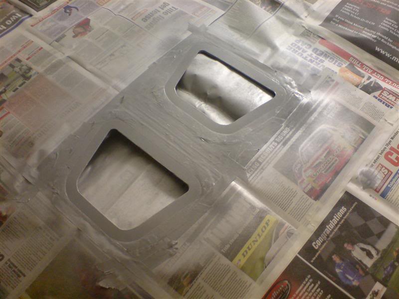

      Some will remember the wiper mod I made to the XR2 - well it's even more important to have effective windscreen wash/wipe on a rally car, so I've also done it to the Ka...
      New brakes…
      My Dad also dropped off the strut brace and master cylinder brace bar he's been painting...
      And here are a few pics of the car in action on various rallies over the last few years; believe me these served as great motivation during the 'dark hours' of the rebuild!
      Sorry if some of the pictures are out of sync - that's roughly chronological! Didn't realise I had so many if I'm honest, you don't notice it when you're only posting a couple a day oops!
      Hope you like - comments and questions welcome.
