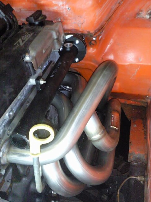

      Not been updated in ages so one zetec droped in! Sump dont catch the xmember like it does in an Escort so no need to mod the sump!
      One nice manifold thanks to neil at 105speed for that and all the help and advice!
      Its an Anglia rather than an Escort manifold.
      Home made engine mounts one side mounts on the xmember and one side in the chassie. Big thanks for my dad for fabricating them will be using Escort rubber mounts.

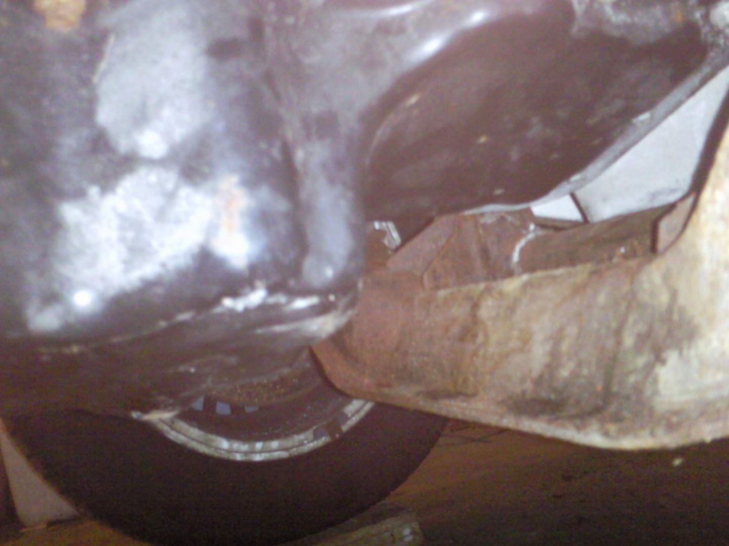

          As you can see the standard sump clear's the cross member
          unlike an escort!
          Home made engine mounts will do the job!

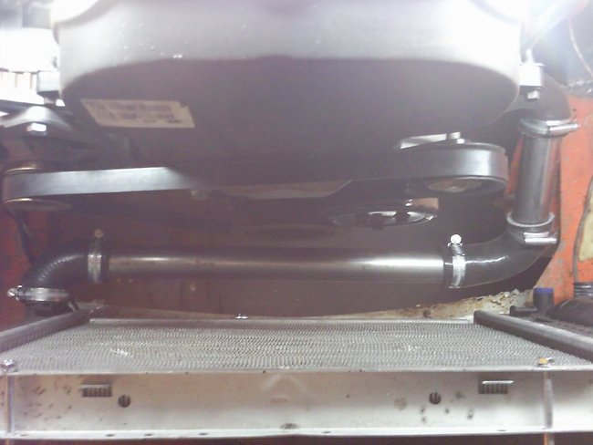

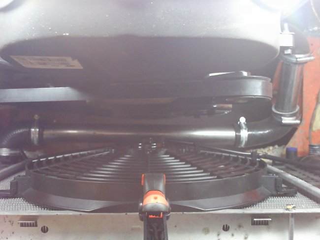

              Not been on for ages so some updated pix.
              As you can see BMW rad fits no problem

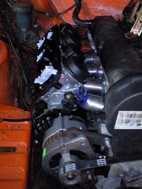

                    few more bits and bobs dun
