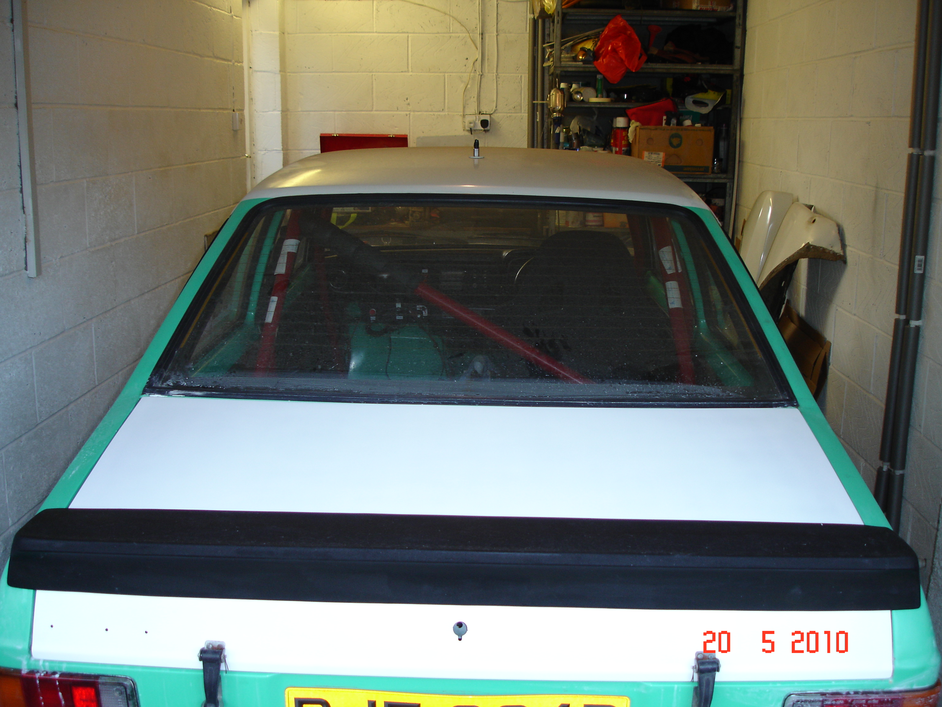

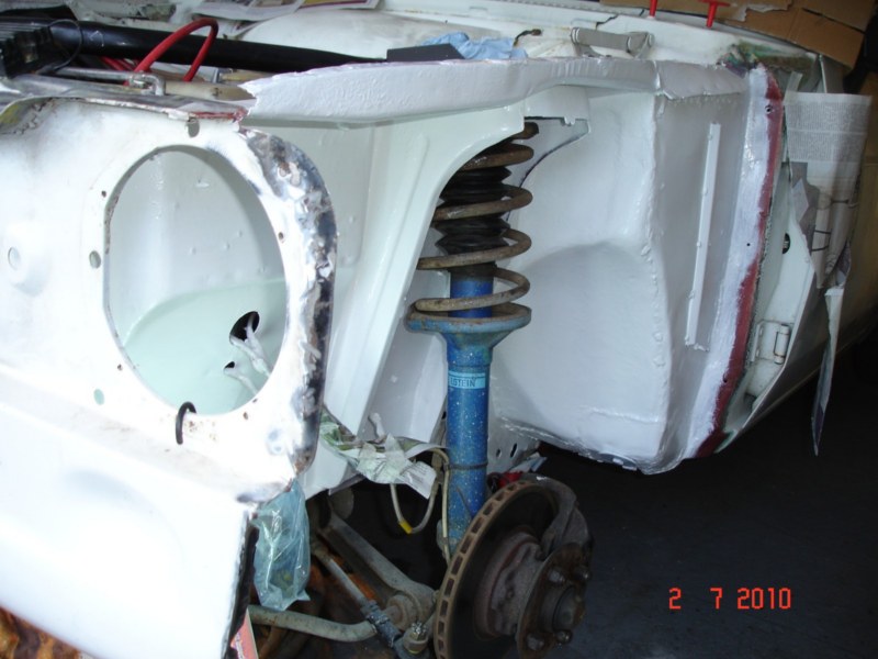

      Re: Northeee hill/Sprint mk2
      pic 2

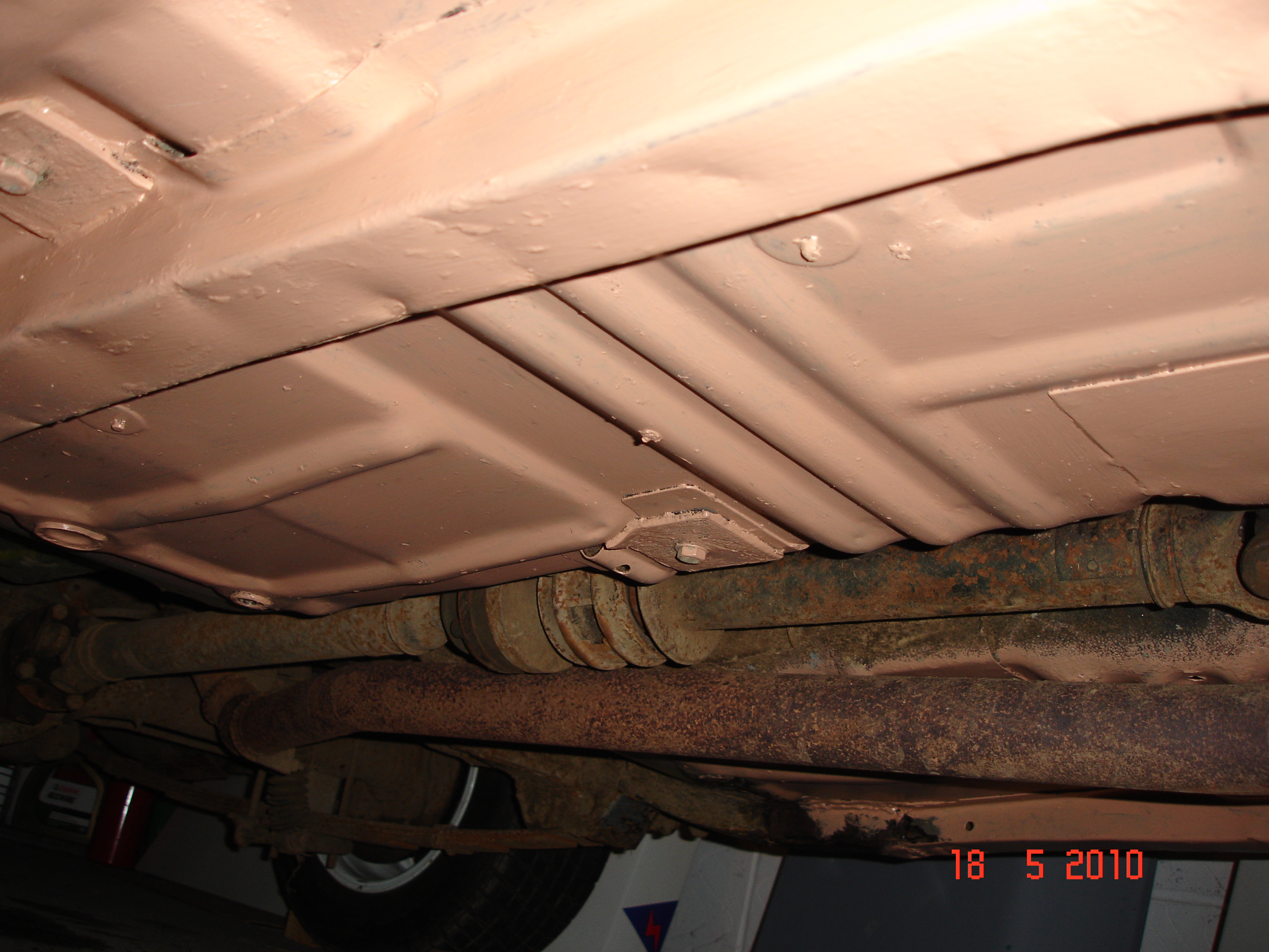

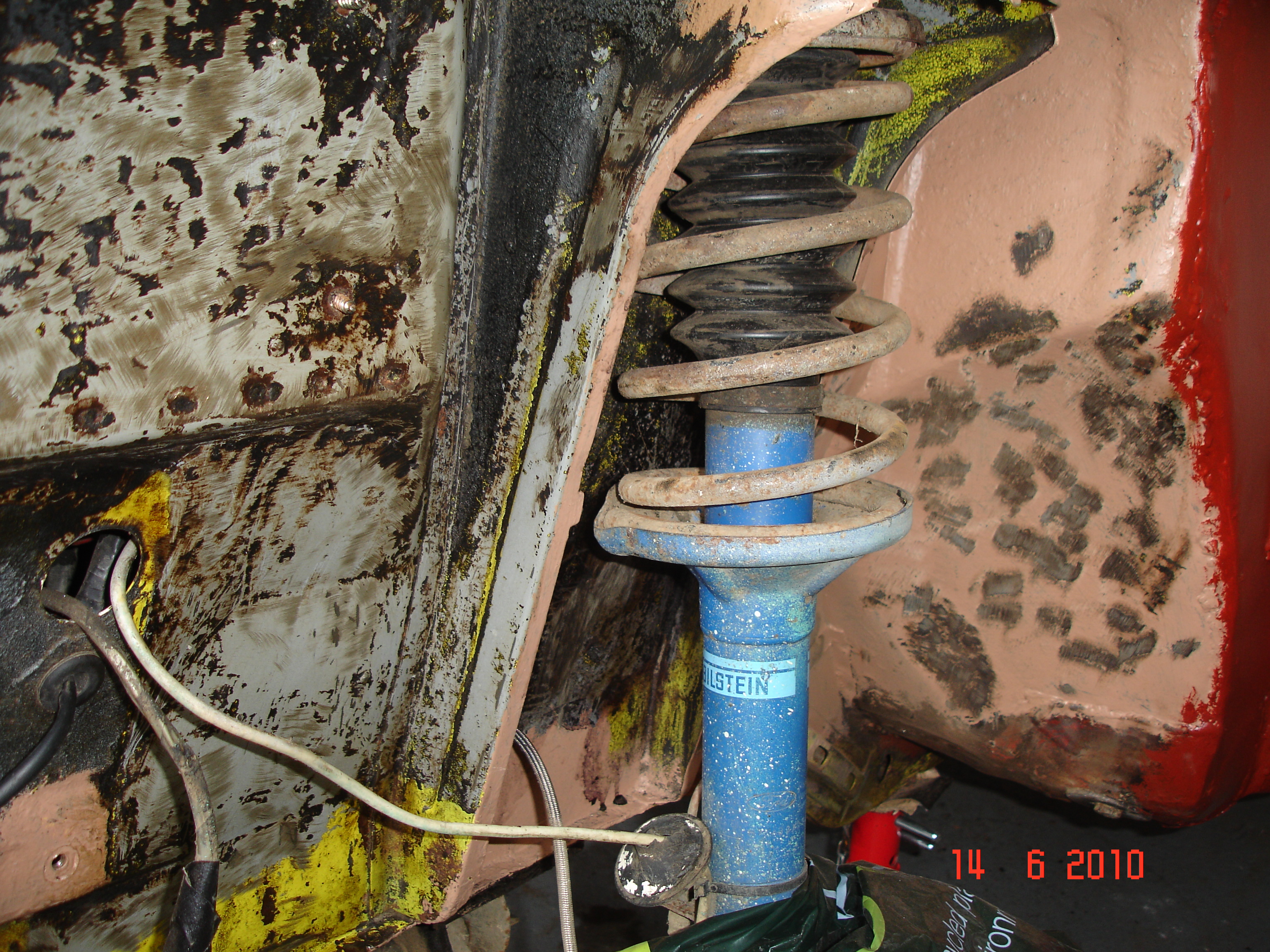

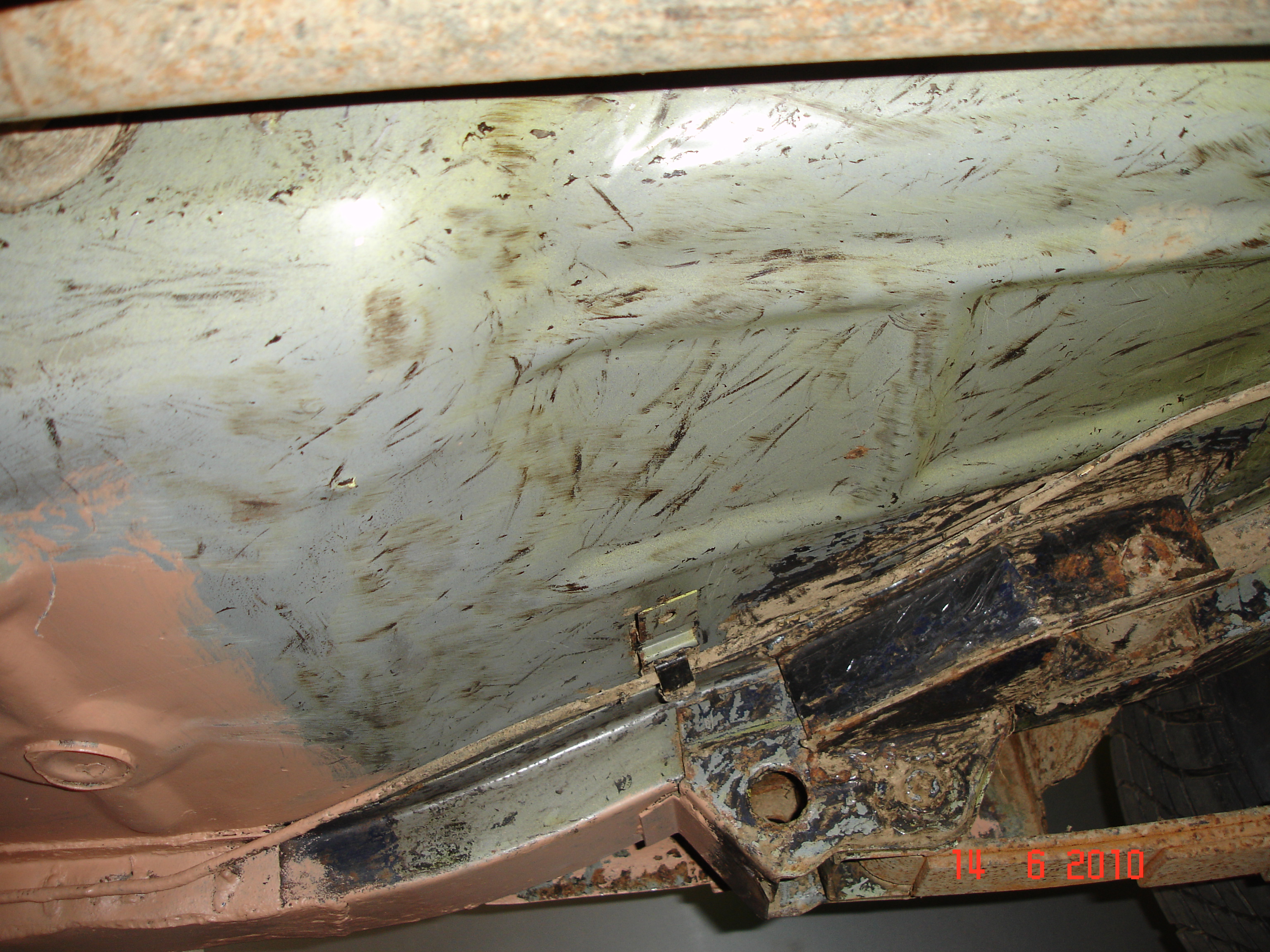

        done a bit more under the car still a hell of a lot more underseal to clean off but did a bit of painting instead of scraping for a change , will be all white when done
        the prop needs to be cleaned up now as it looks like crap its never ending

          #19
          Getting the underseal off is the worst job ever,most nights after work for about 2 months scrapping it off the mk1 its worth it in the end as you know just what under there

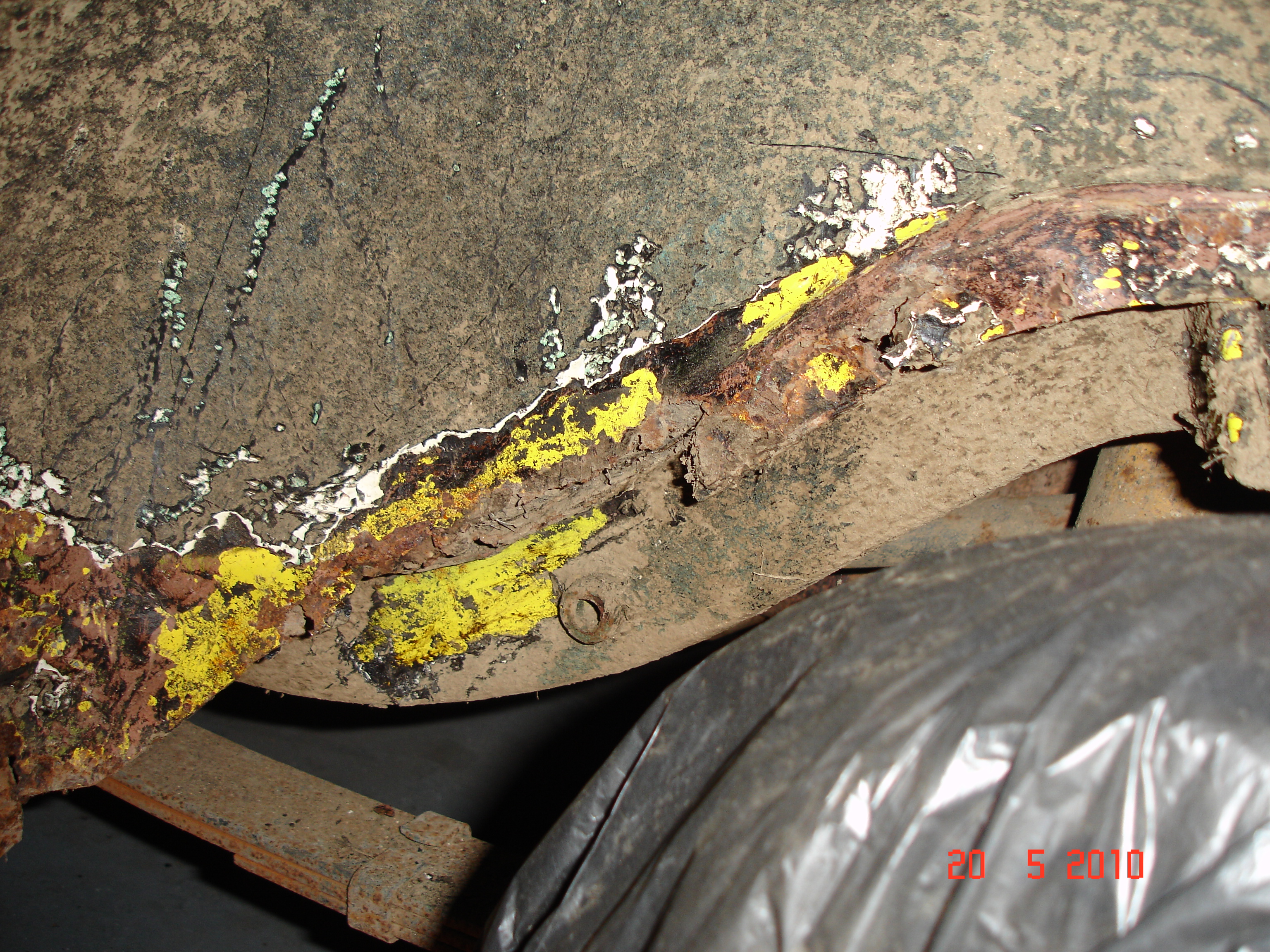

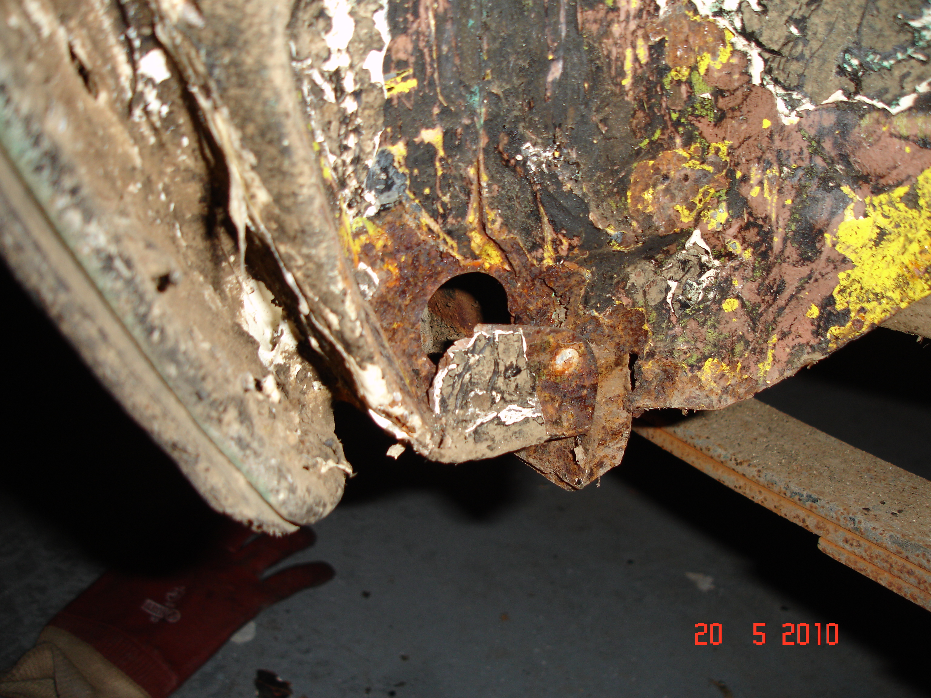

            yes your so right had a look at the rear n/s arch today and found this bit of rust is there a repair section for this area ? going to fully clean up all round so i can check it all.

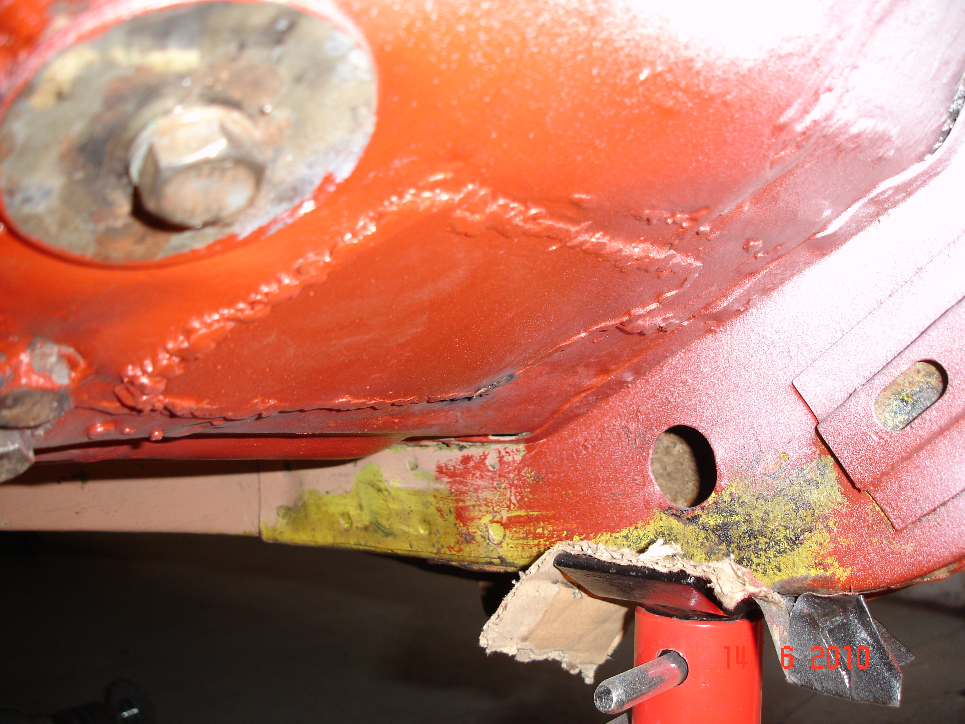

              • northeee
                #22

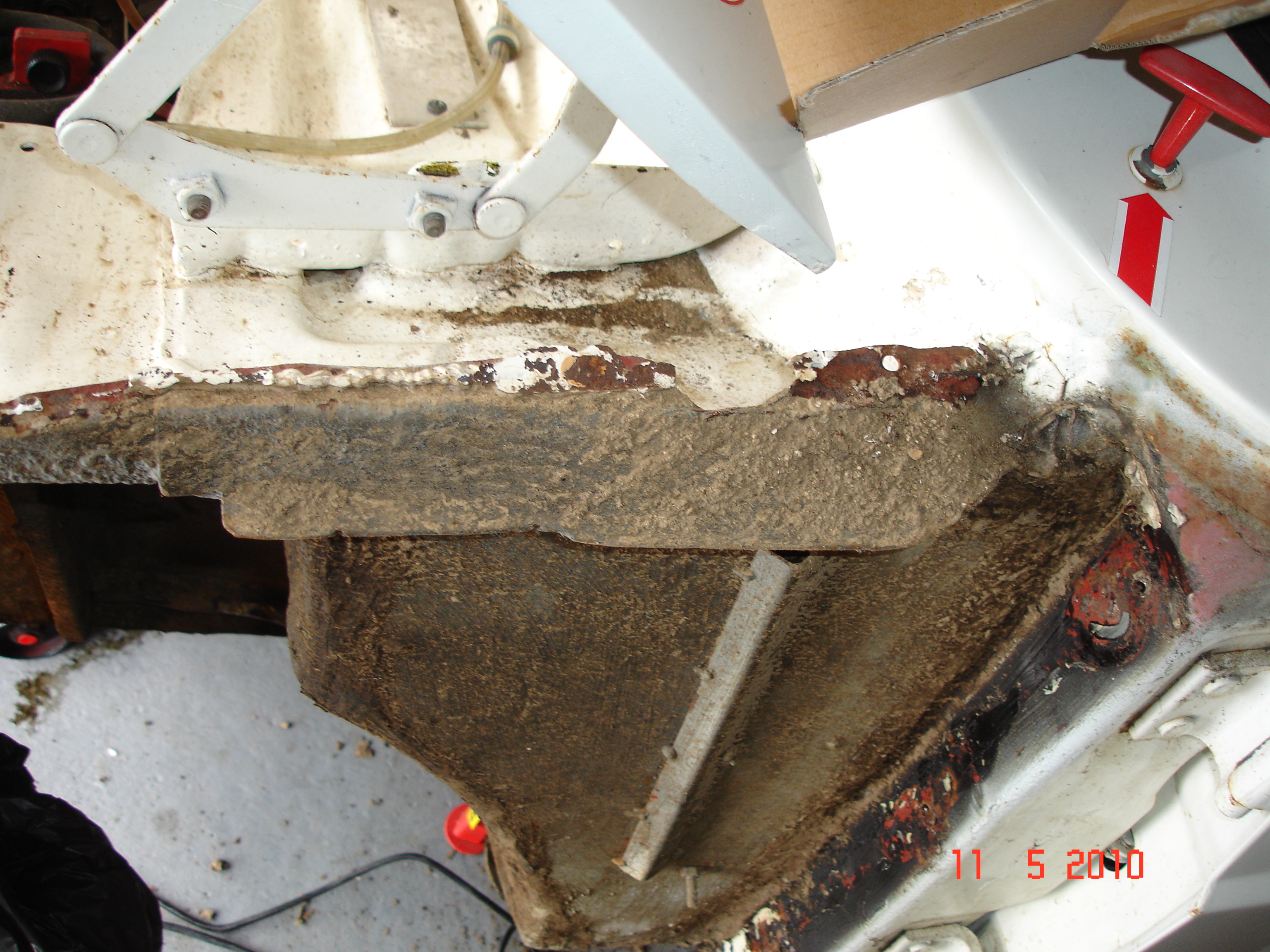

                pulled of some more underseal and found this hole going into the sill should it have a rubber bug over it?

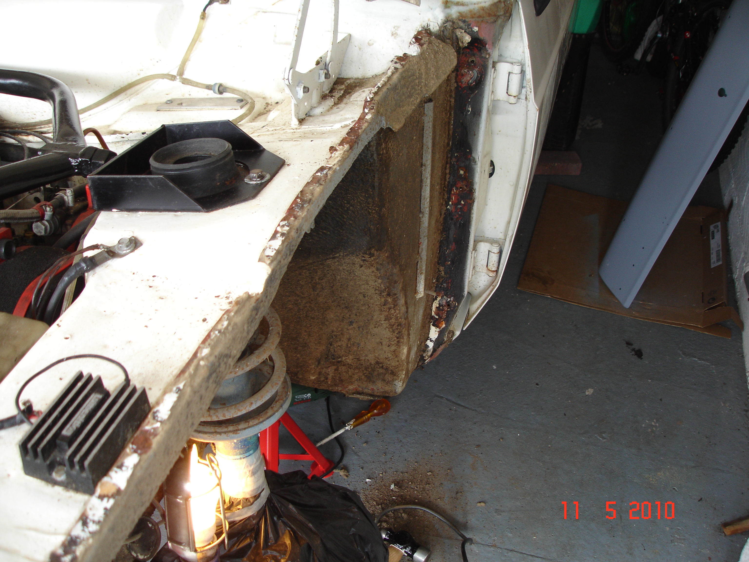

                    #24
                    Originally posted by duncan
                    just spotted this mate remember you saying ages ago about buying one
                    finally a proper car
                    think its gonna keep you out of trouble thats for sure don't start pulling it apart too much you will end up bareshell resto

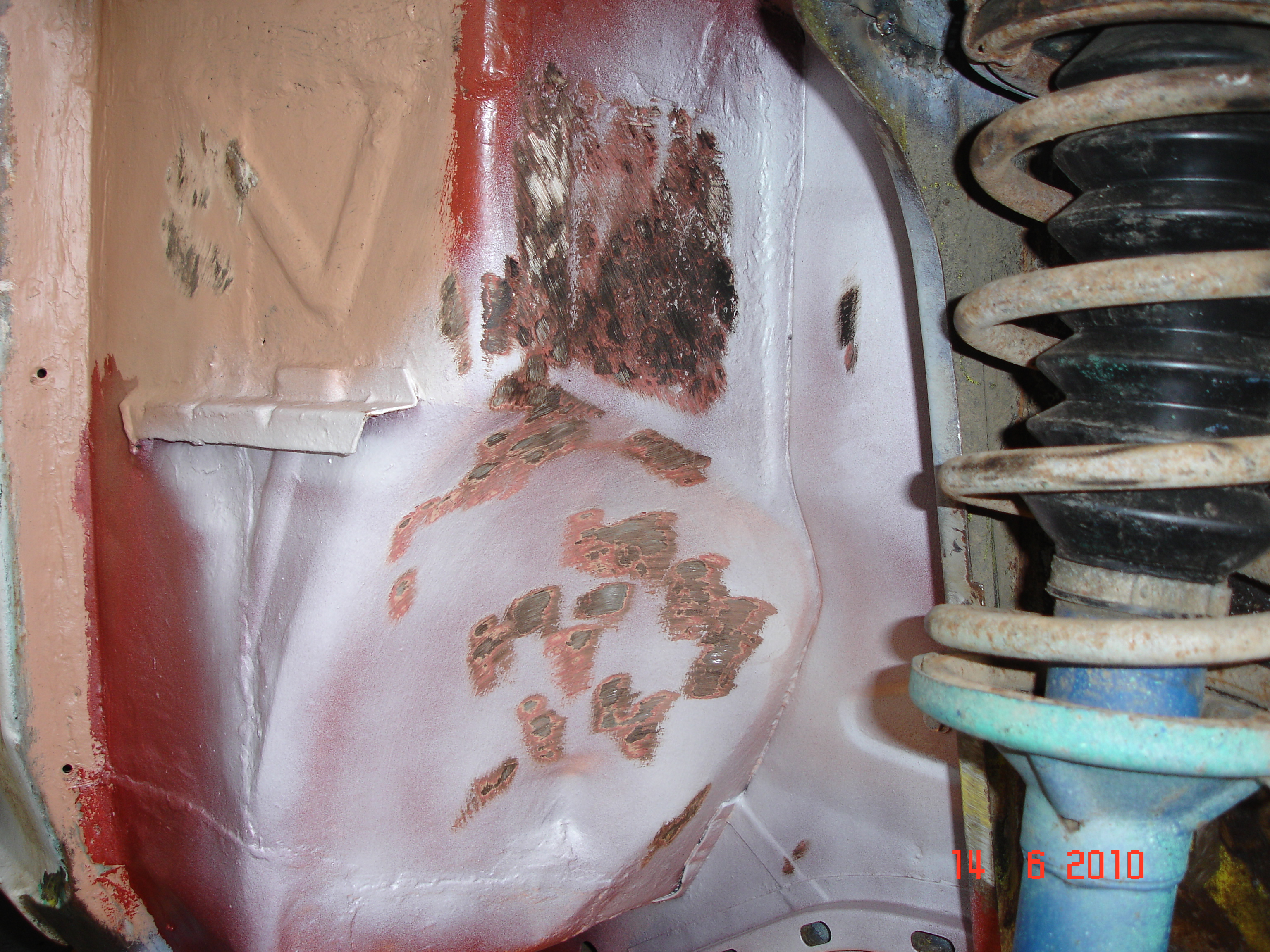

                    yep have to stop myself or i will never get it back on the road almost taken off all underseal now and the rest of the car is spot on solid just need to do the drip rails going to keep them just make a patch as there ok really and rear arch as in pic and small sill patch then re paint underside in white underseal ,going to buy a new wing as the old one was a mess and buy new front group 4 arch kit ,have also put green track rod ends on .

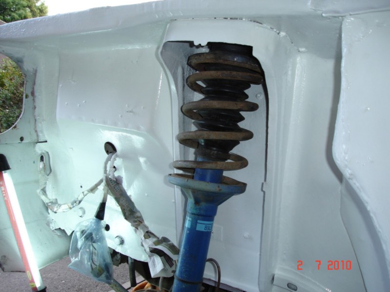

                      still working hard on the car most days just to get to this stage must have put in 30+ hours on it by now and really is great to get into working on the car ,this is how its going anyway .

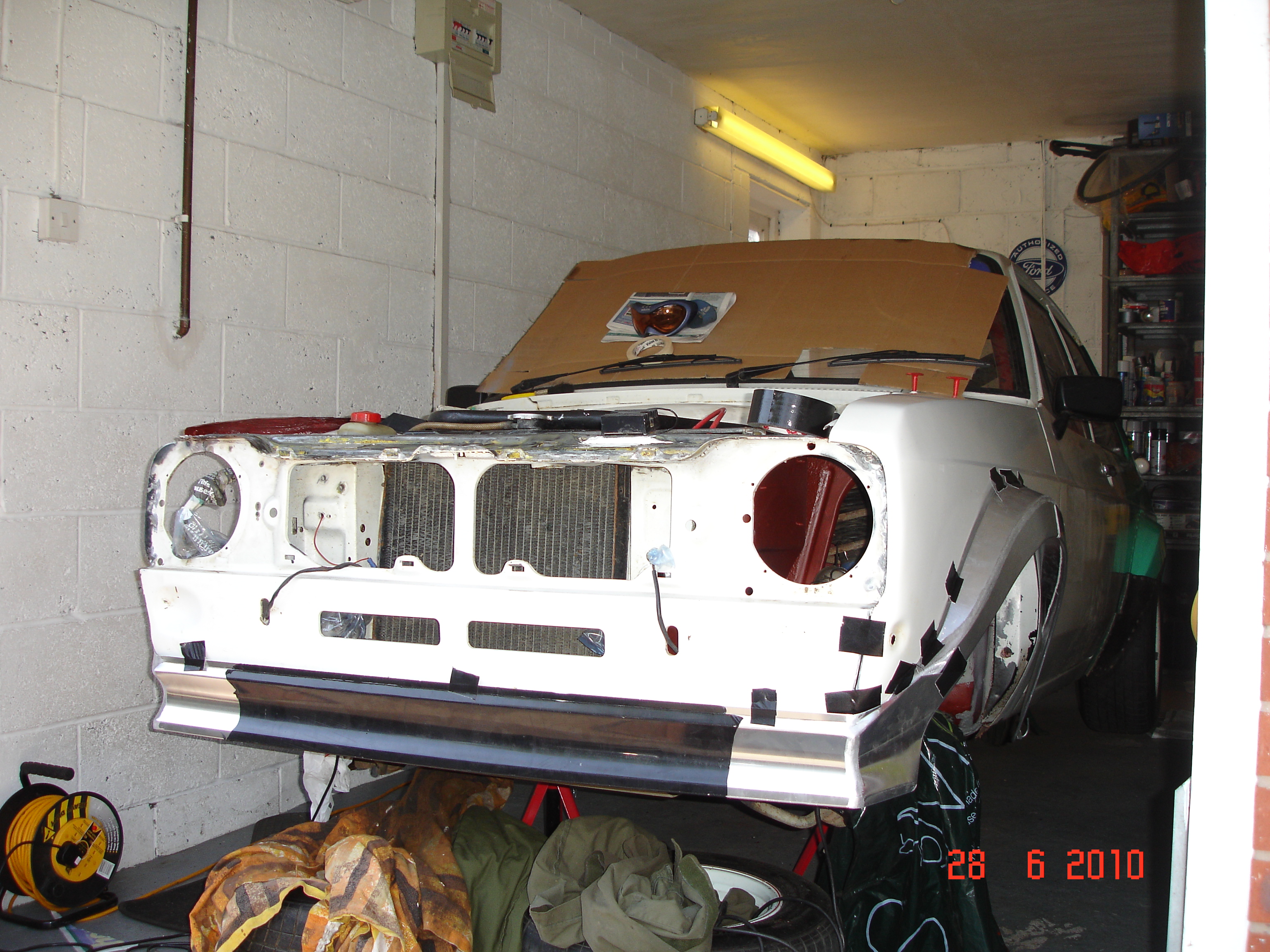

                        trial fit of new group 4 body kit ,pulled off the old kit and will have to weld up the old rivit holes before i drill for the new ones as there a bit bigger.
                        going to try this with some copper plate at the back and plug weld them up.

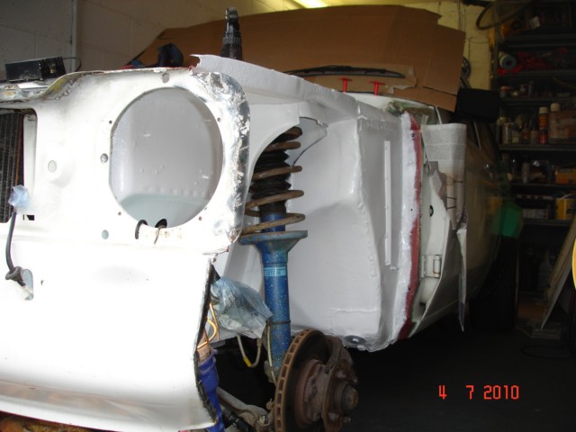

                          #27
                          just a bit of painting today to tidy the wing area.

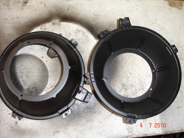

                              cleaned up the headlight bowels then sprayed them also repainted the white as i was not really happy with it , bit to glossy now re done with satin looks good to me now
