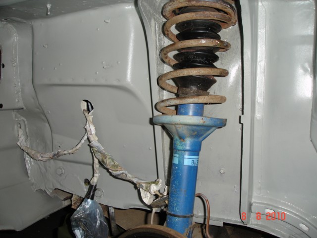

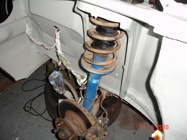

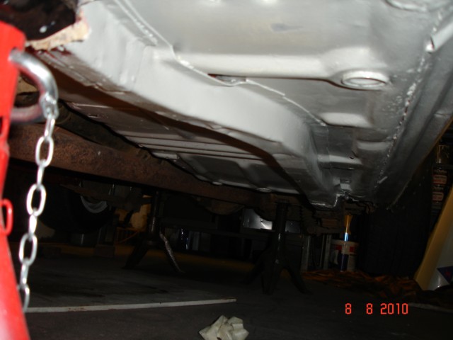

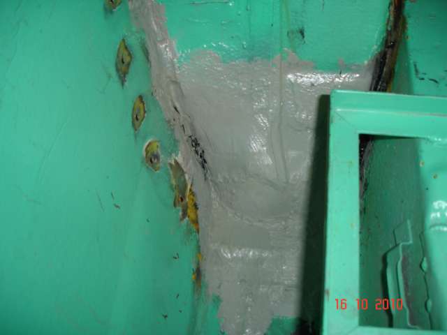

        found an ad for epoxy mastic 121 in RETRO CARS mag going to do all the underside with it .
        its a two pack paint and cost a lot £65 for the two tins plus thinners going to need some more as well.
        can brush or spray it on then going to spray in white very happy with it

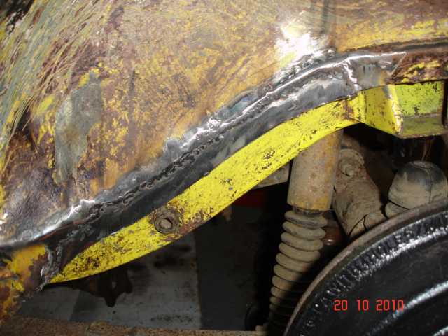

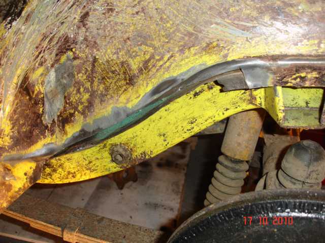

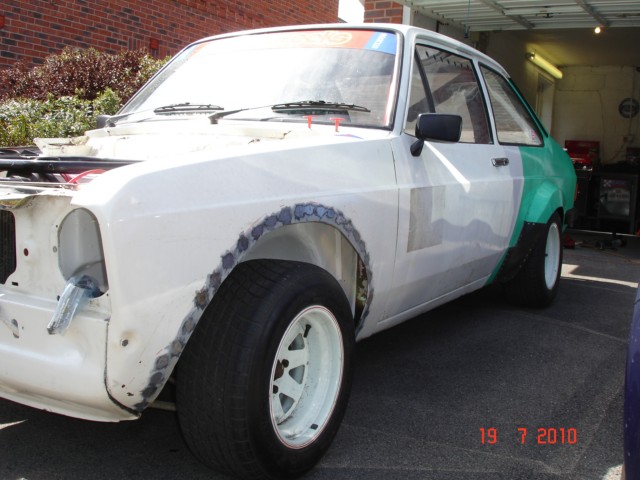

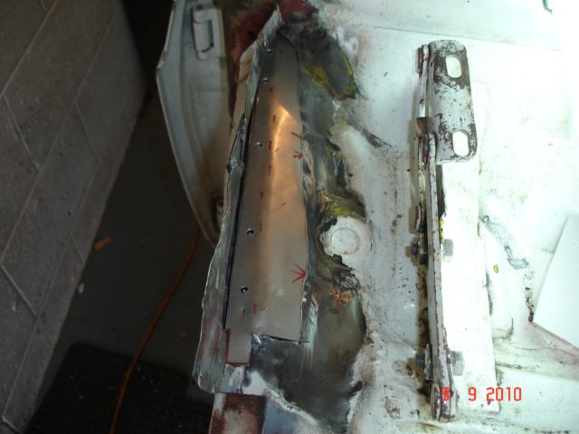

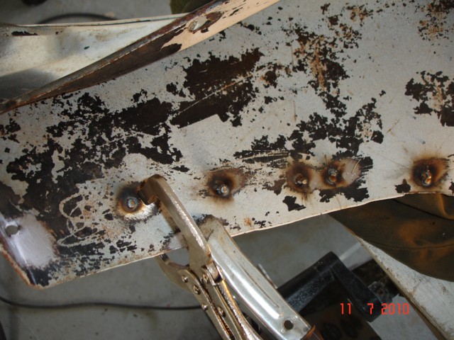

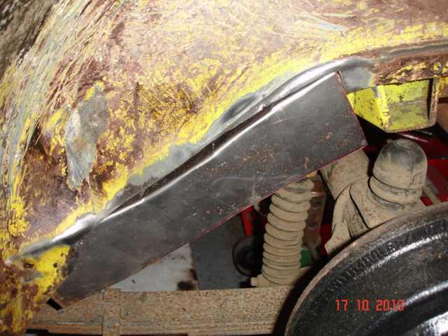

          also welded up my old rivit holes ready for new arch to go on

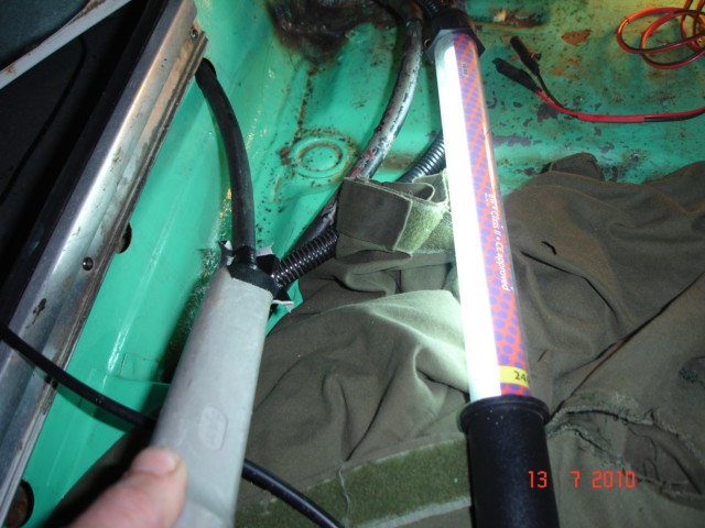

          and stuck some old fuel hose on the end of the hover to clean out my sills dont tell her indoors

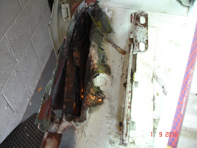

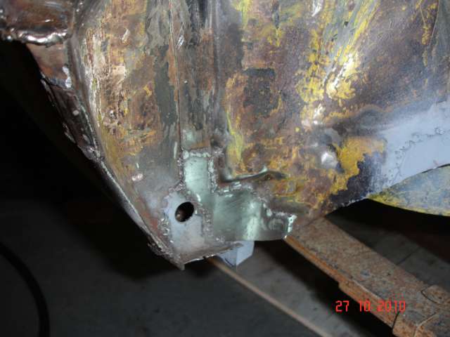

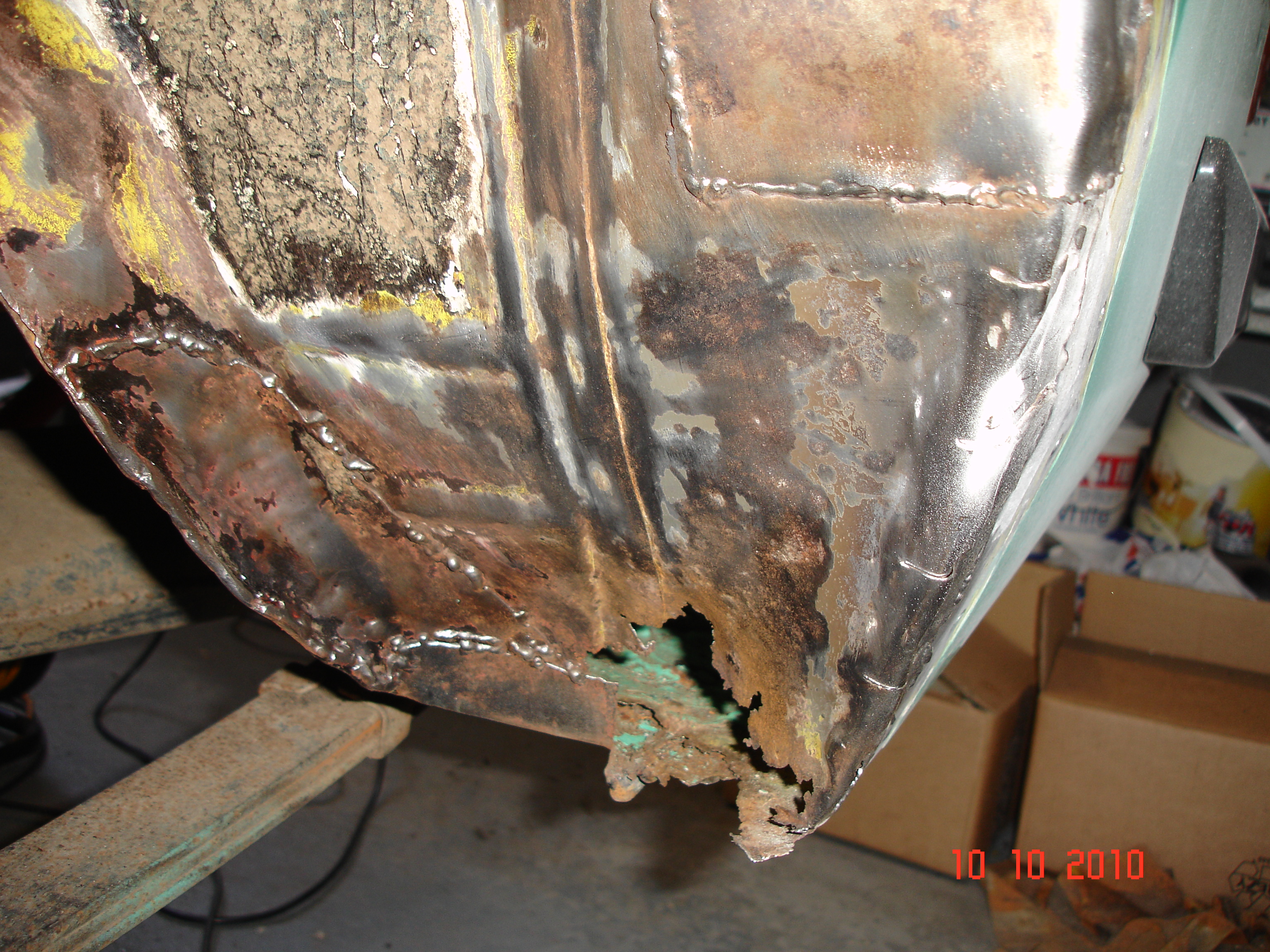

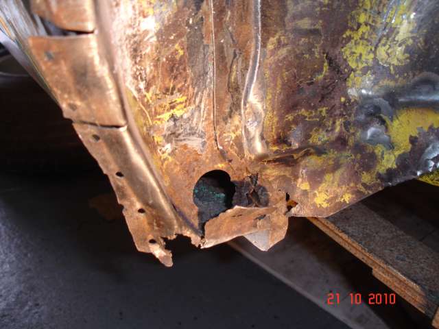

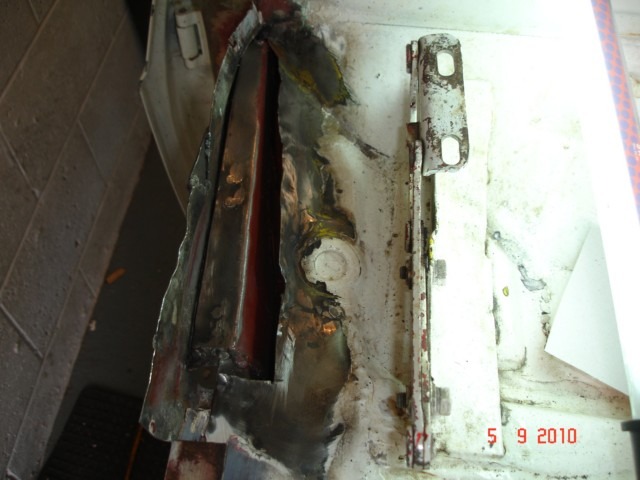

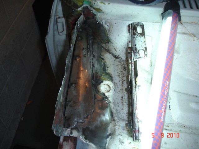

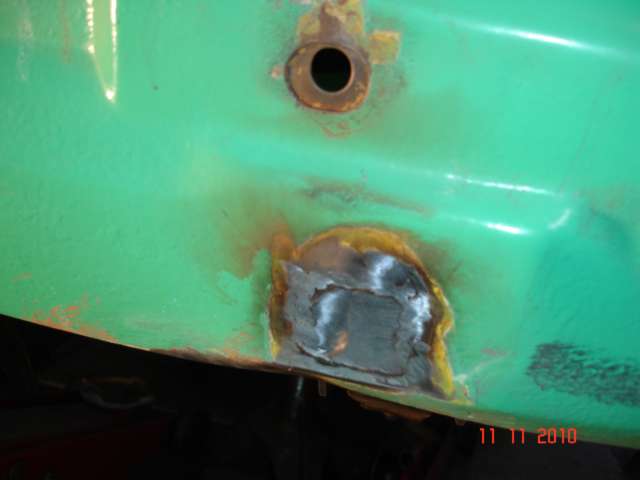

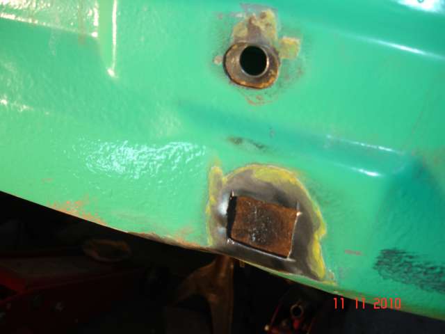

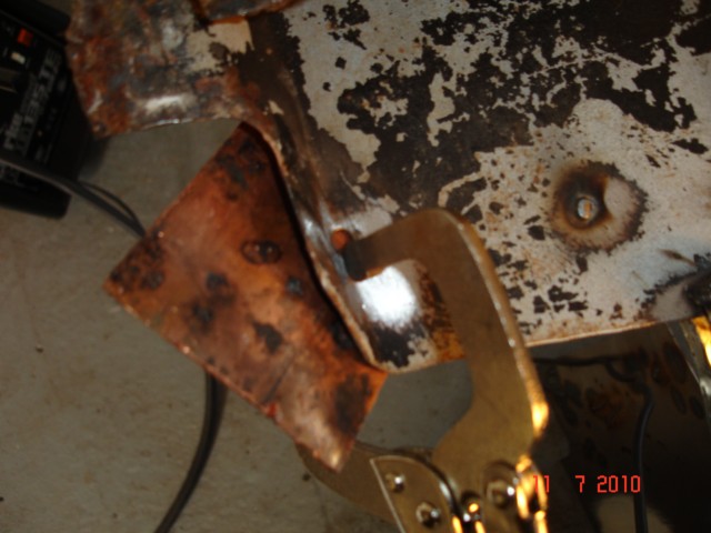

            Also cut out an old patch someone had put on the offside most off it was seam sealer

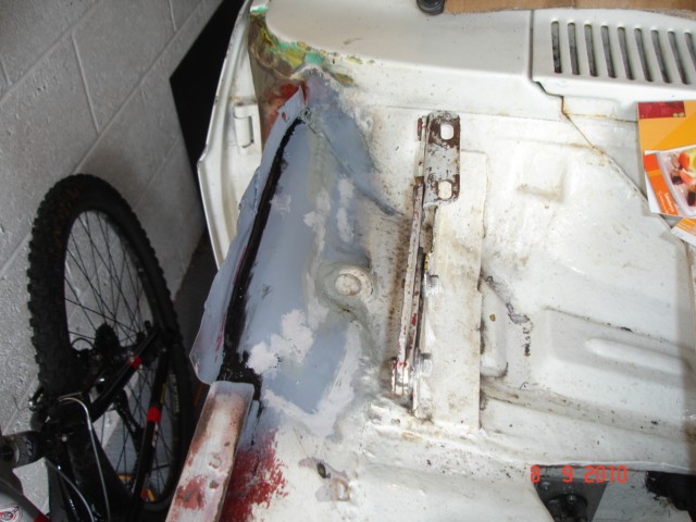

                Re: Northeee hill/Sprint mk2

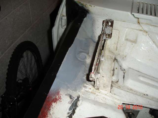

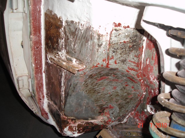

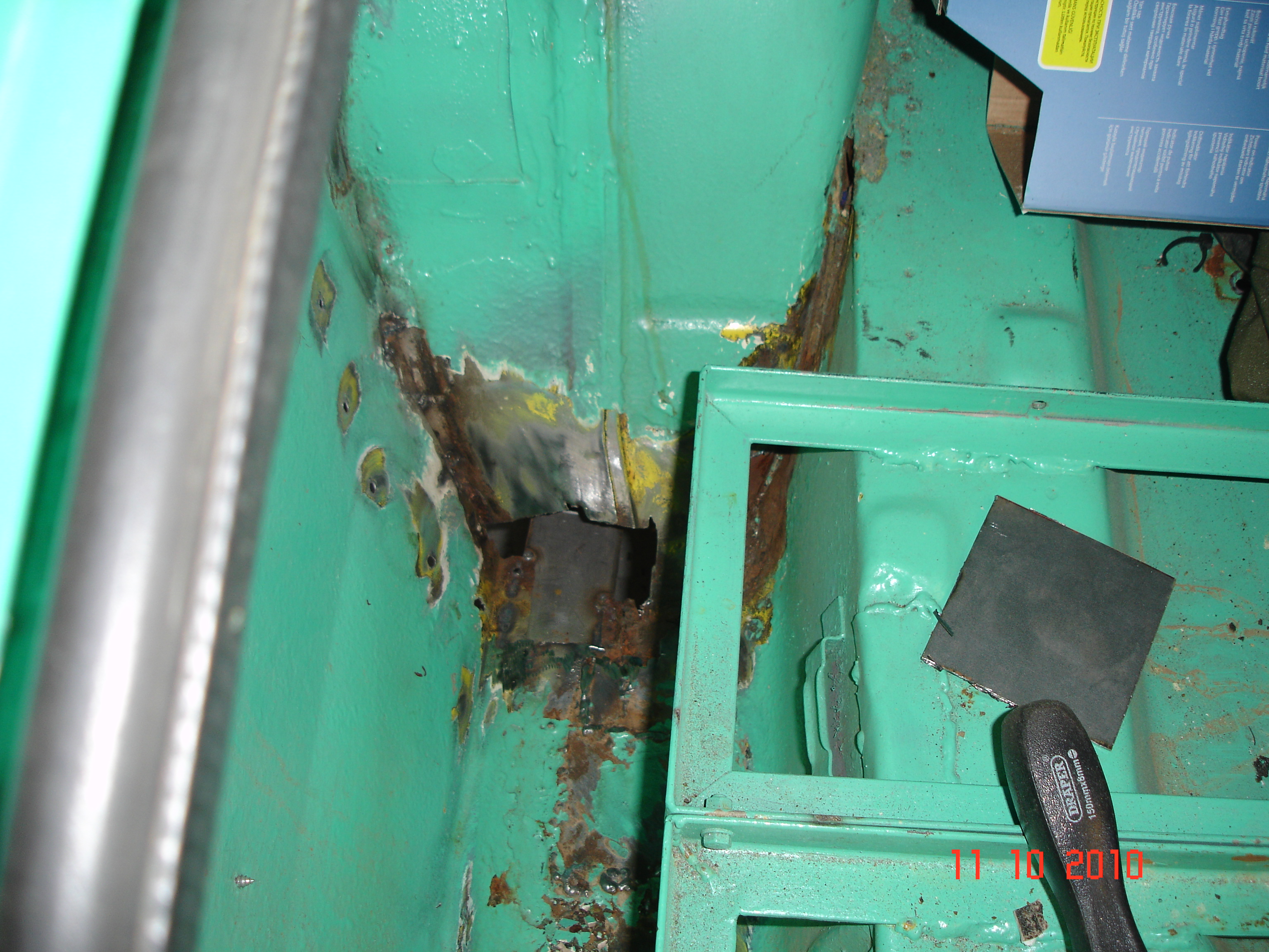

                some more work to do in the spare wheel well
                getting there all nice and solid

                  also have some new Tarmac arches to go on from wast wales rally

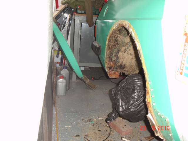

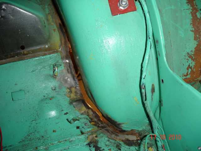

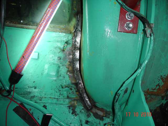

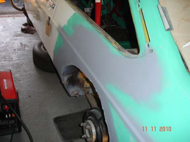

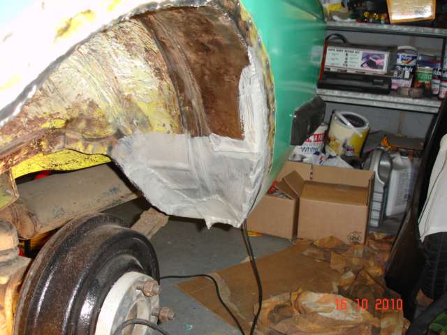

                        bit of a tidy on the near side rear arch, getting it ready to put on my new tarmac arches
                        looked worse than it was ,very happy to find very little rust on the car.

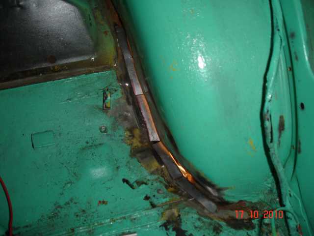

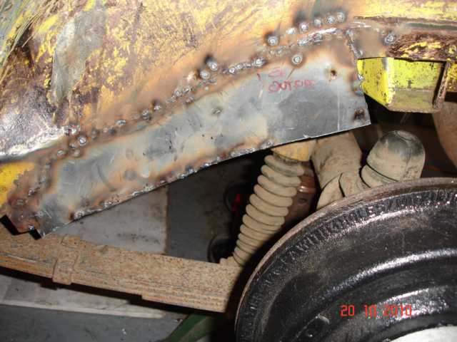

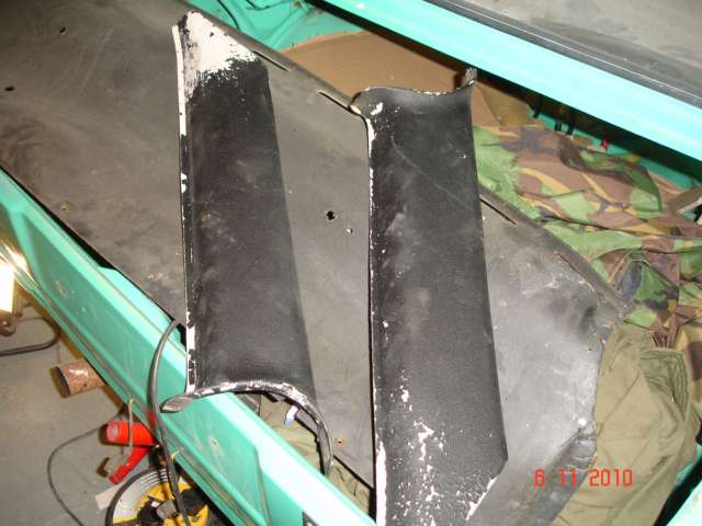

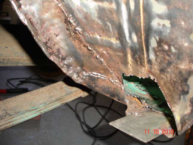

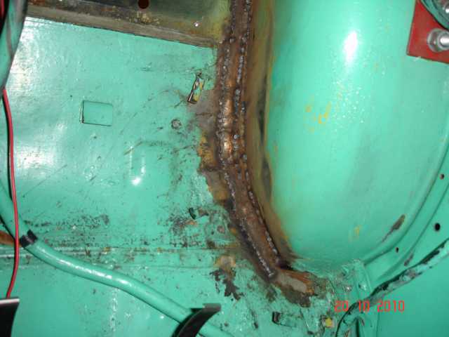

                          some butt welding on the rear panel

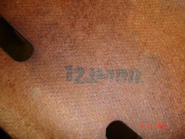

                          rear shelf out and still has date made on the back jan 12th 1977 as on log book for the mex will re spray the rear side pillers covers when i have cleaned them back

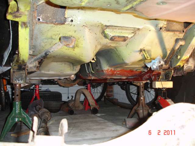

                            still working on the car when i can been a bit cold in the garage of late, with lots of swearing and cursing trying to work in a single garage theres never any room.
                            as you can see trying to clean it up on the underside ready for paint. i keep finding more bits to take off and clean up
                            it also going to need a new rear box as most of the inside fell out on the garage floor when the exhaust was taken off

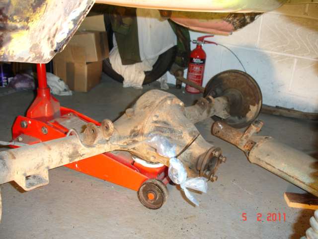

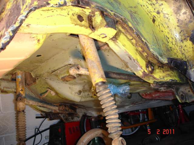

                                had lots of fun today

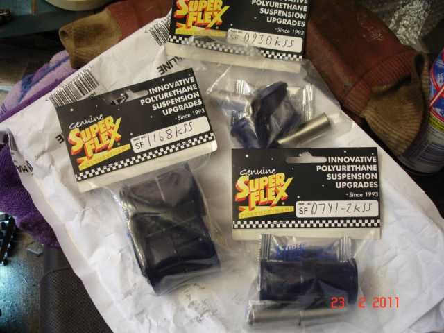

                                taken the anti tramp bars and rear bilsteins off to clean round the mounting on the body ,then paint the bars an fit new poly bushes ,to tramp bars and dampers

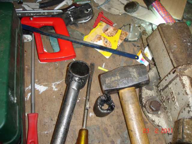

                                what an arse of a job small rubber bushes came out not to bad but the large ones have the metal shell to come out,so i used a junior hacksaw to very carefully cut making sure i did not cut the tramp bar some slots then with a big screwdriver and big hammer punch it out - 2 hours later there out maybe i should have gone to the local garage for them to press them out .
                                superflex do cost but i did run them on my race 205 pug and was very happy with them.
