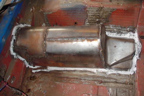

    Old system out new power tuned system fitting

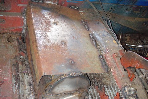

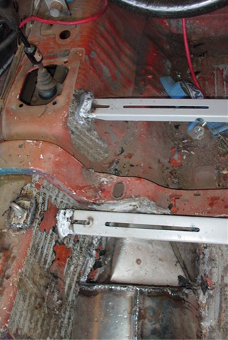

    Silencer box needs to go in the footwell behind driver so remove floor and new tunnel welded in
    Top hat to keep everything square and provide extra heat protection..

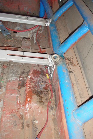

    New seat mounts /cross brace fitted

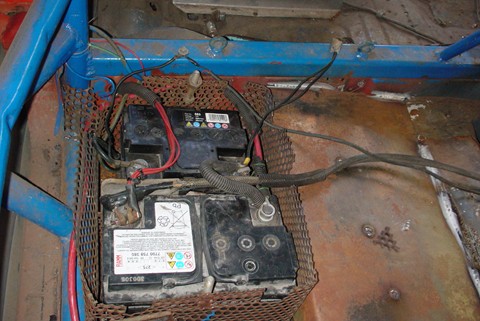

    Re-locate batterys (everything is fitted on the drivers side to keep the weight on that side because i only turn right being an oval racer)
    24 volt starting with 2 seperate 12volt feeds from each battery 1 feed for ignition and the other for every thingelse(electric power steering brake lights ect)

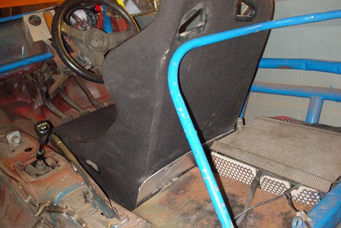

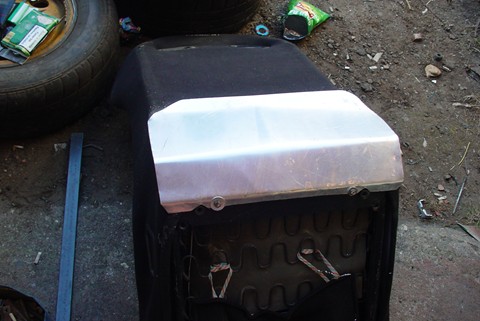

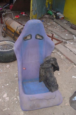

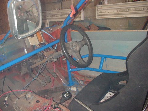

    Old seat gone (they burn realy well)(top tip dont weld brackets on seats bolt them on)
    New seat with arse protector fitted on base (i think black seats go faster than old blue ones ...? could be wrong)
    New seat fitted(new to car) batterys insulated and covered ready to go

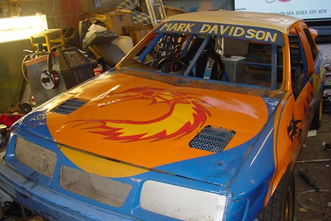

    all it needs is a coat of paint (not good at pretty ill do it later)

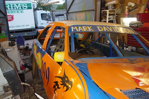

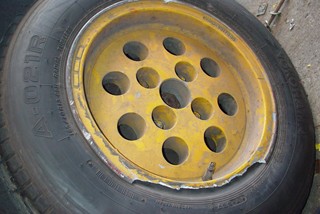

                    Raced on sunday... Car was spot on pace big grins all round...
                    Need to sort out cornering now... will go softer on rear springs i think..

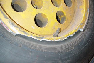

                    I managed to clip the wall with the rear wheel on lap 3 ... finished the other 17 laps pushing as hard as i could...
                    Returned to the pits and noticed id ripped a chunk of the rim off ...tyre stayed up...
                    Put my spare on finished the second race ...slipppppery.. went to lower the air pressure and the valve fell apart in my hands...
                    No more spare tyres ..and i bottled using the broken wheel..so couldnt make the final..
                    But had a Great day ...loved the car..
                    I think i could loose easy 100kg and still be heavy!!!!!!!
                    Will look at car set up now..get that better..then look at engine again...got 3 weeks before next race..(=3 days off!!!!!!)
                    and get 2 spare wheels now..and might buy a pair of new tyres( all my tyres are old cast offs from other racers...Free...helped the budget to get started)
                    Cheers mark

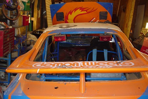

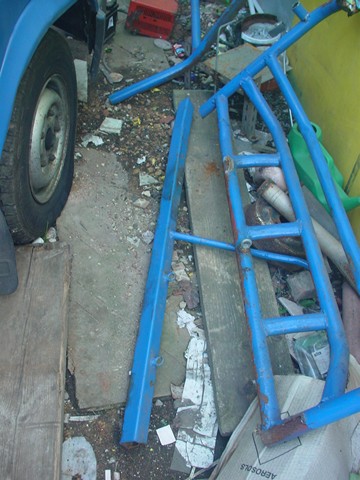

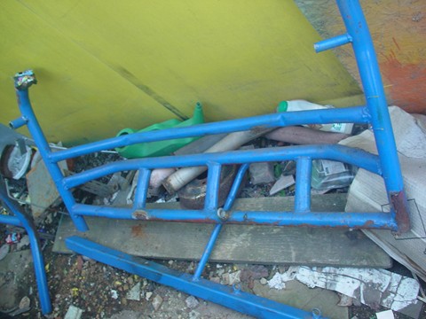

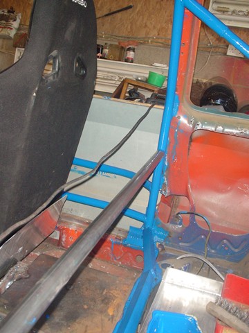

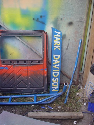

                              Spent a day with the angle grinder...Removing weight...
                              REMOVED
                              Complete roll cage
                              Sill bars x 2
                              Cross brace(floor)
                              Petrol tank steel platform
                              Steel sunroof panel
                              Inner tilt and slide roof
                              Steel name sunvisor
                              Inner bonnet skin
                              steel rear light skins
                              20 brackets of every shape and size
                              exhauste hangers
                              steel battery box
                              I weighed each part as i removed it and the total weight removed 148 kg

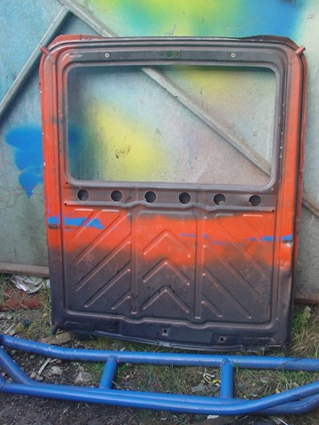

                              Some of the larger parts removed

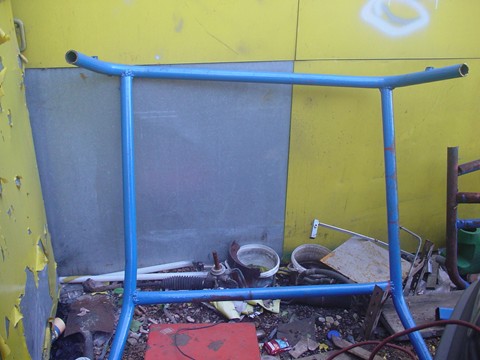

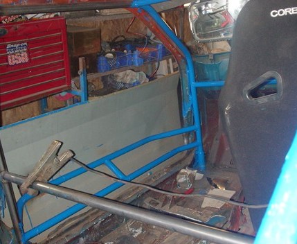

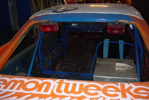

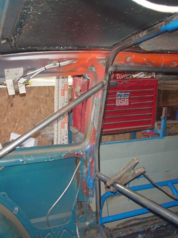

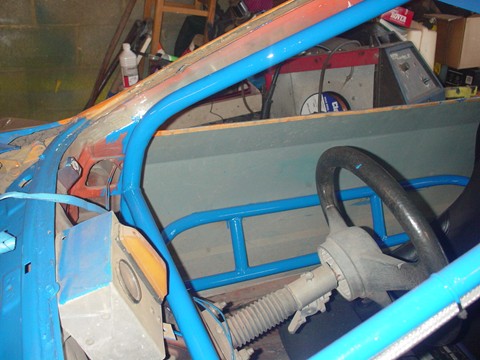

                              I then spent a day cutting ...bending...and welding my new cage...built to minimum spec(with my new pipe bender)
                              Even managed to paint half the cage..
                              I Replaced the sunroof cover with ally
                              The Name sunvisor is now Ally
                              The rear light covers are ally
                              The petrol tank has moved to the floor with an ally splash tray
                              Ally battery tray
                              The harness now locates on the roll cage crossmember..
                              Total weight of all items replaced 24 kg (including roll cage)
                              A TOTAL WEIGHTB SAVING OF 124 KG

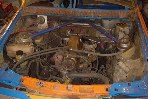

                              While the car was stripped inside i took the opertunity to re wire the system with proper cable in shorter runs
                              I also modified the exhauste system again....After testing.. an extra 5" on the first section felt better and proved a fraction quicker...
                              This moved the exhauste box 5 " further back ...so i could remove 5" of exhauste tunnel(save some more weight) and move my driving position 4" further back and get an exact upright seat...
                              The old position was a compromise and felt very awkward (arms good/legs bad or legs good /arms bad..)
                              Now arms and legs in good position................
