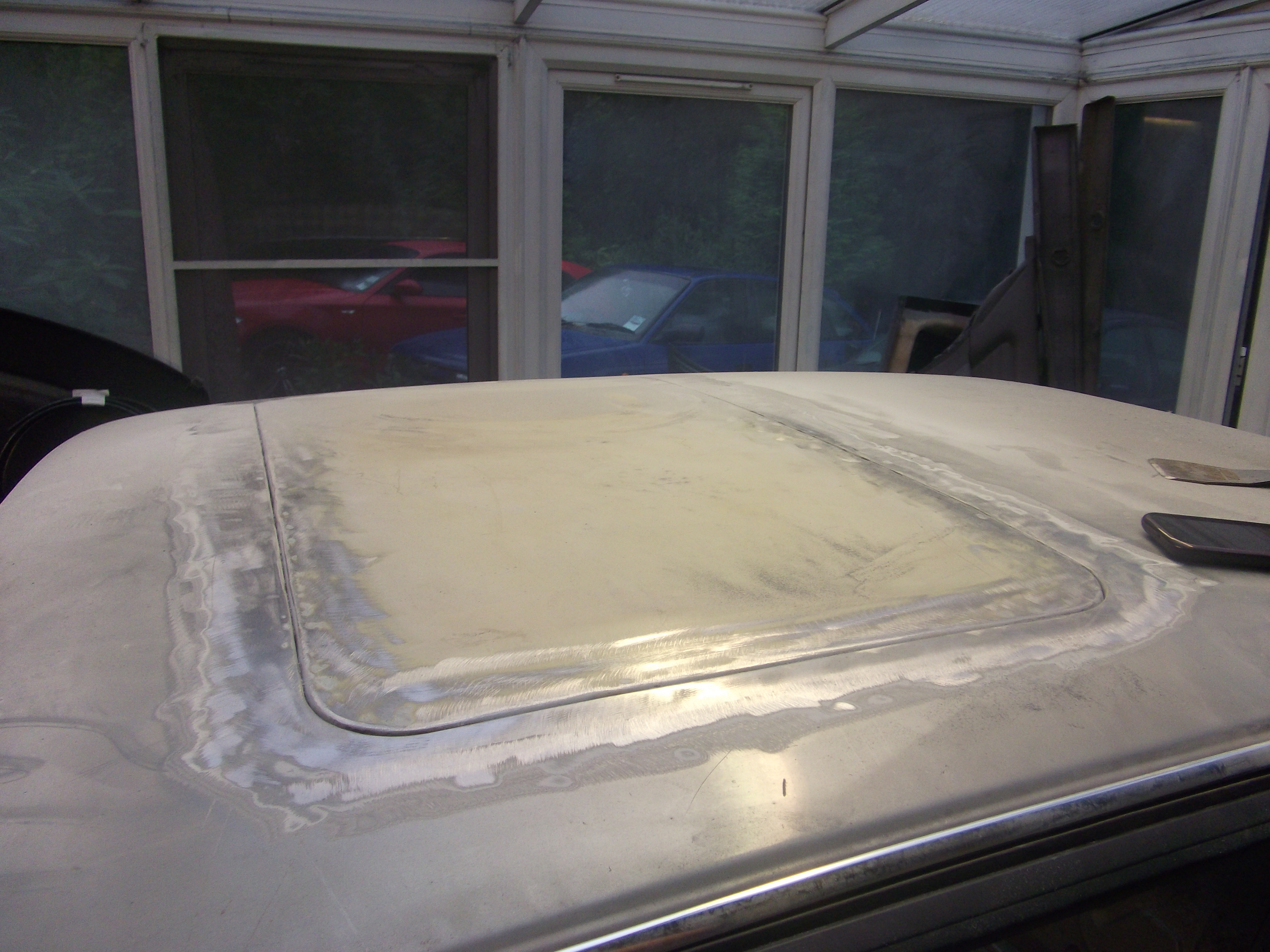

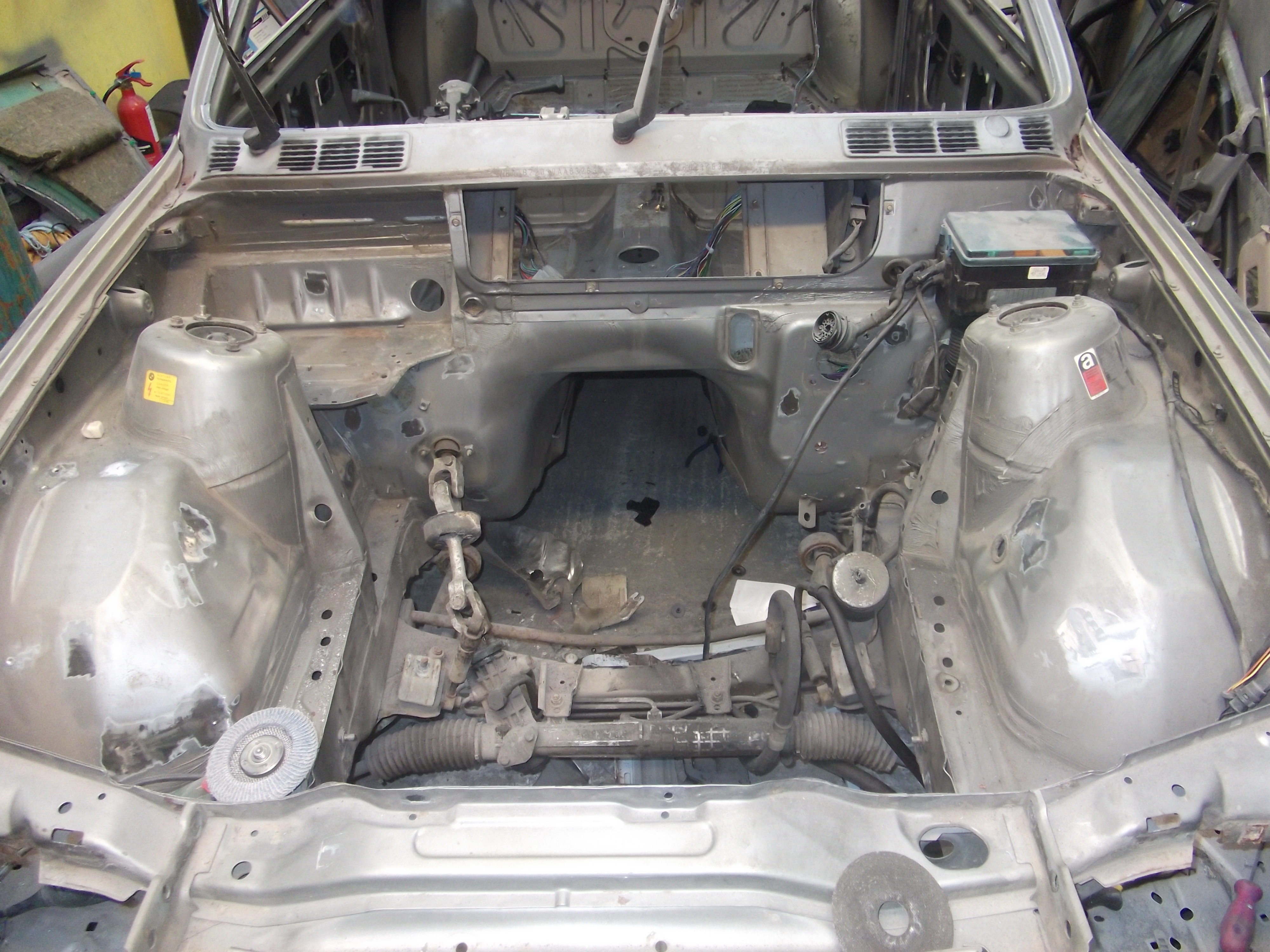

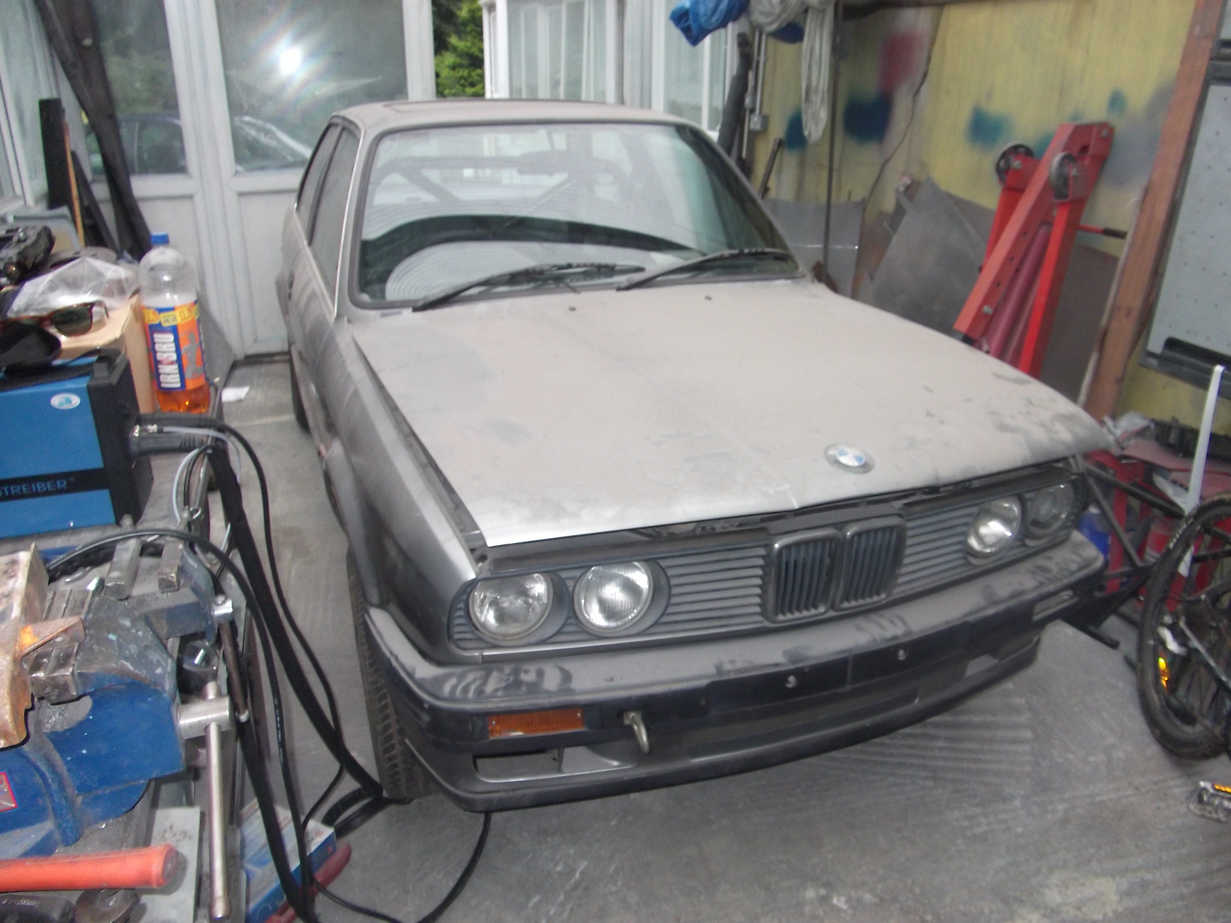

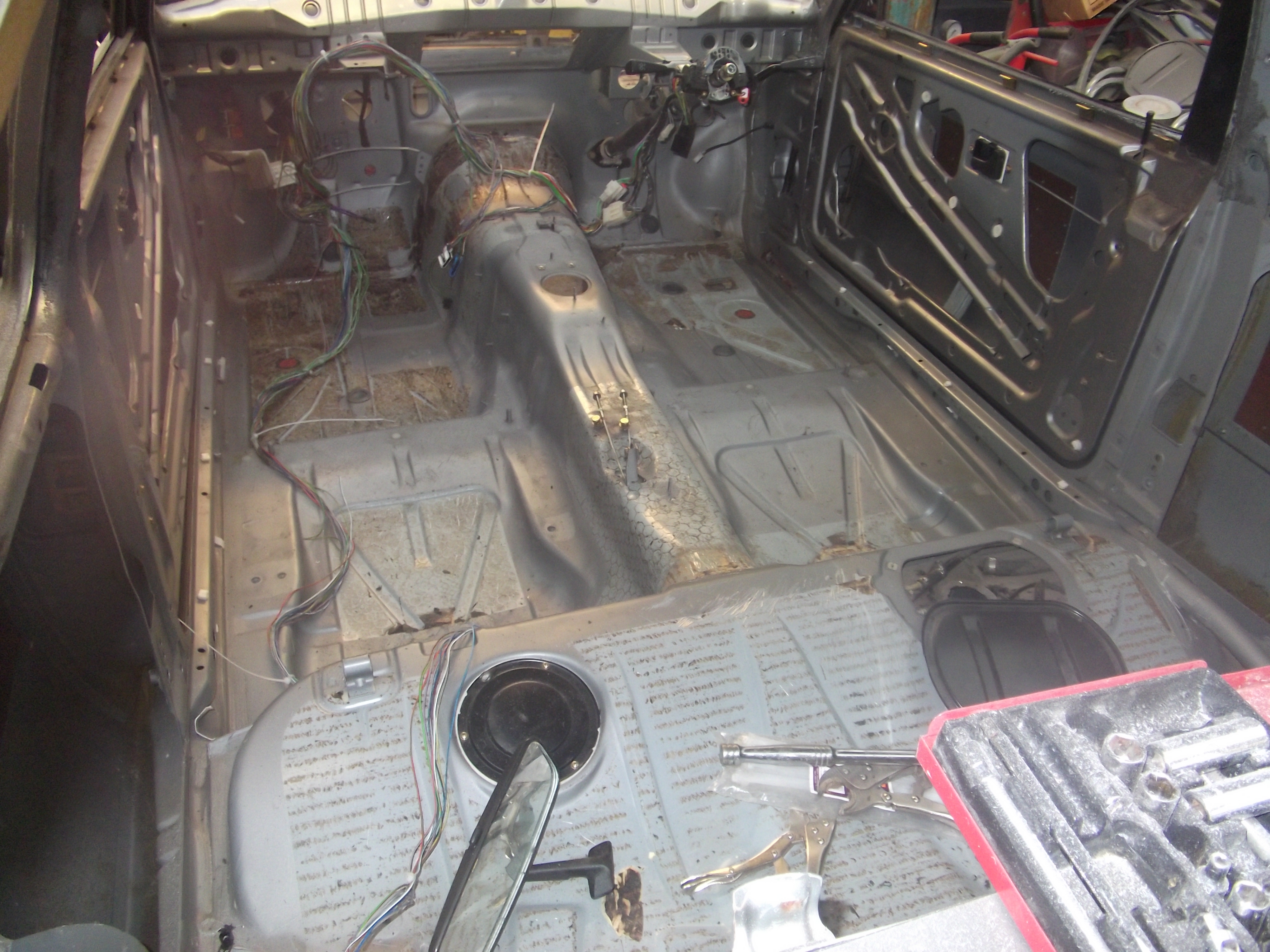

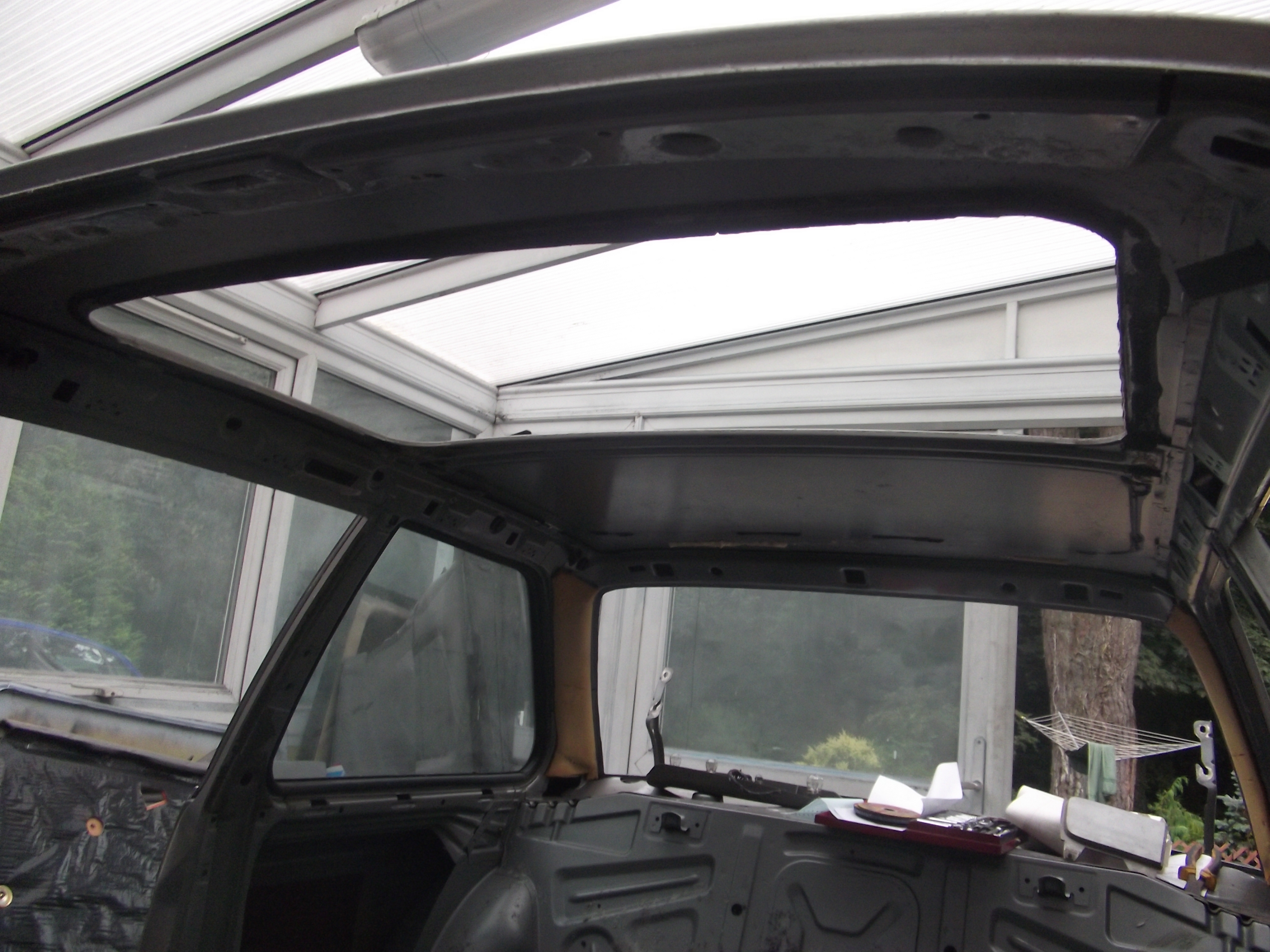

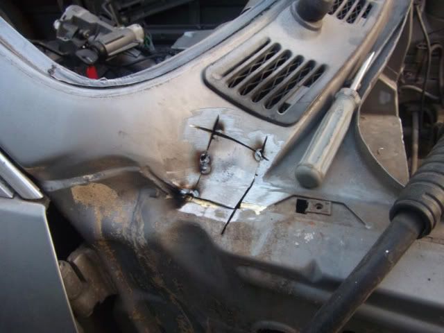

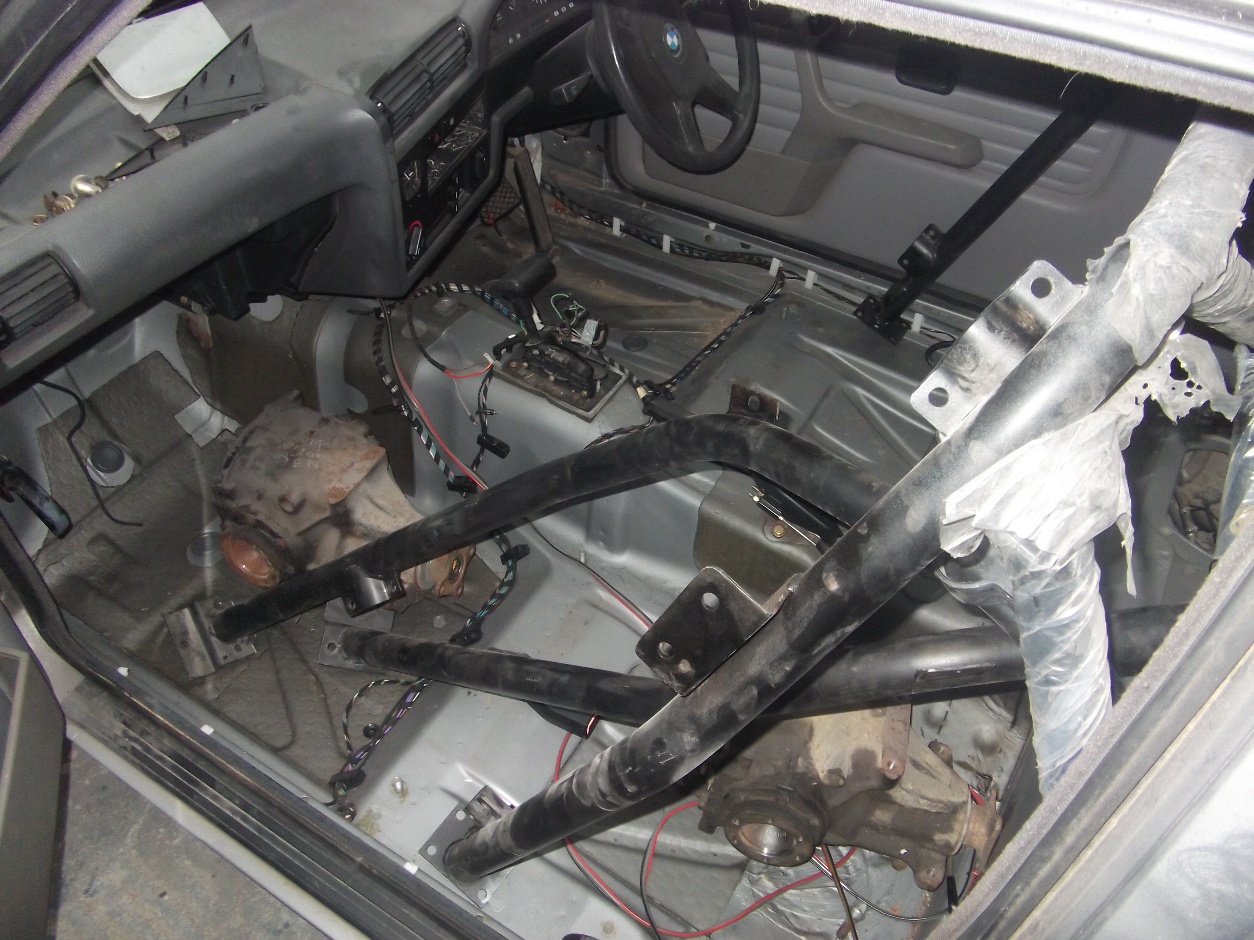

                    Anyway, the new victim arrived last week and here is the last few days progress, all stripped down, wiring thinned down to the bare essentials and sound deadening scraped off, engine bay has had the brackets and threaded nipples removed and the sunroof crtridge removed and a filer plate tigged in place.

                      Thats a cracking looking shell, should be ready for paint in no time

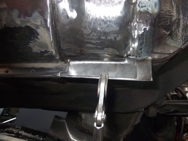

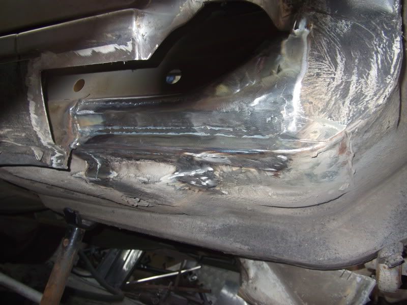

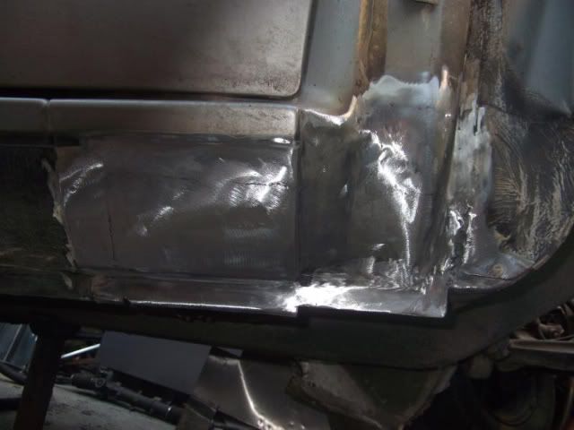

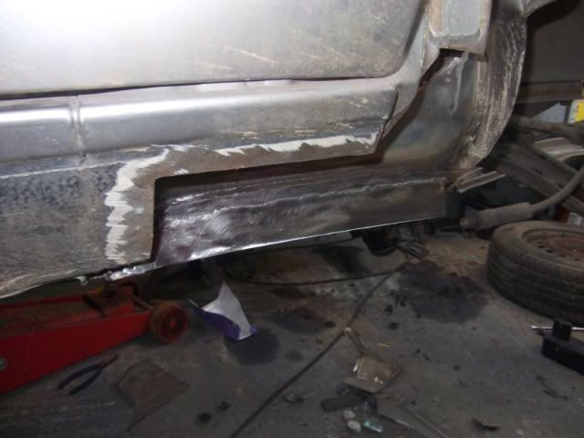

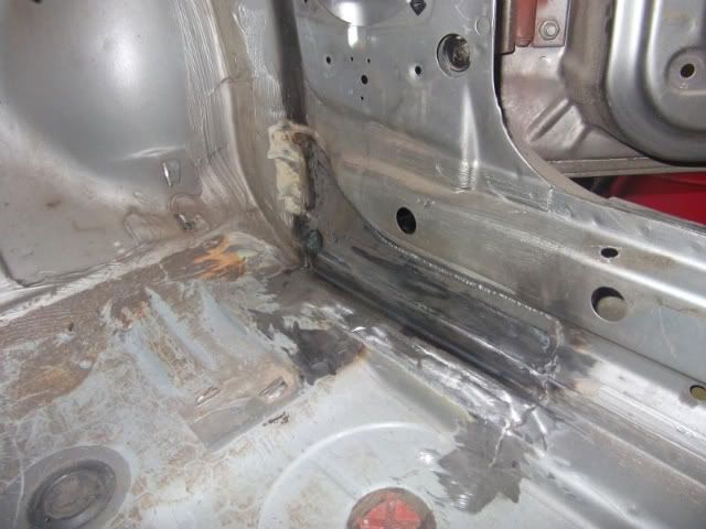

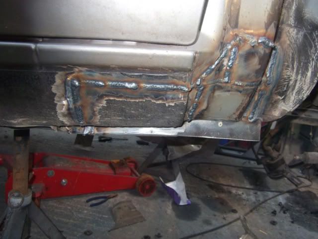

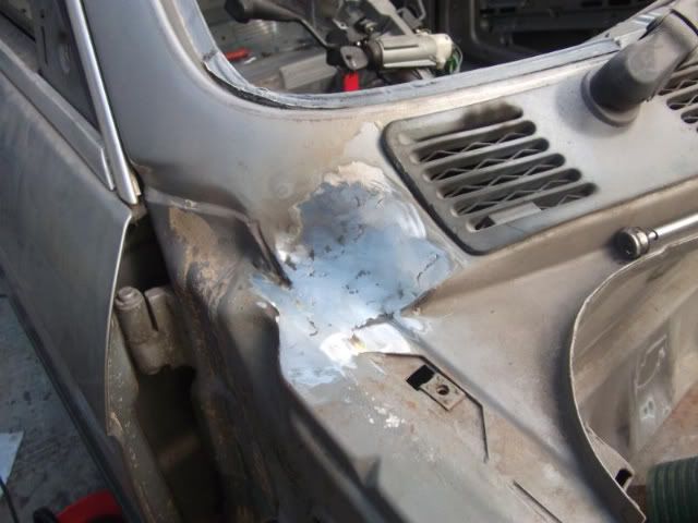

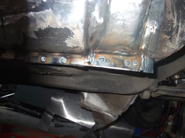

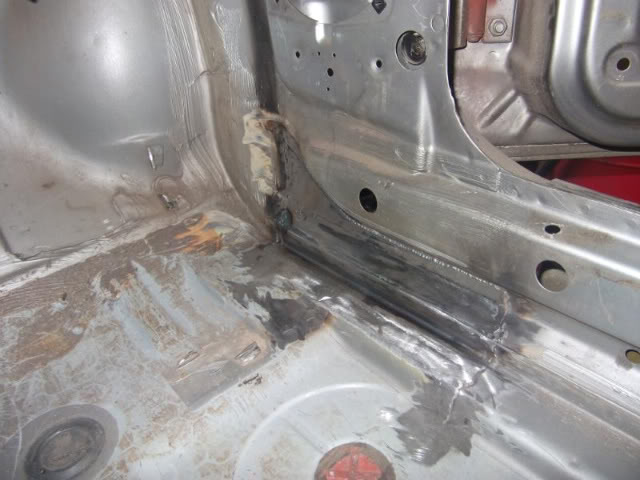

                        Been busy past couple of weeks, Cut out and repaired some rot......

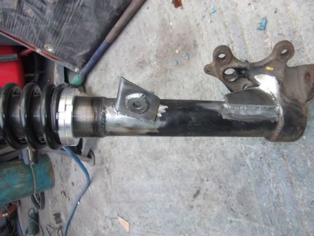

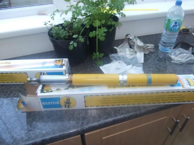

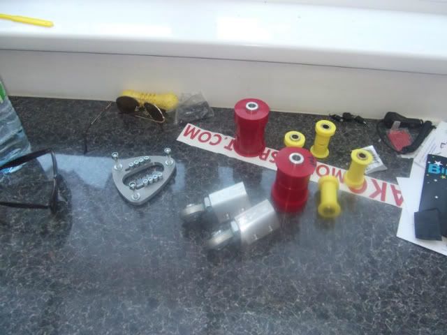

                        Got some suspension components.....

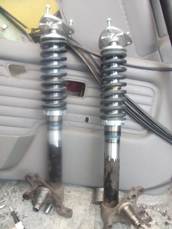

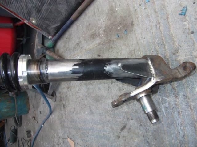

                        Made up some new front struts......

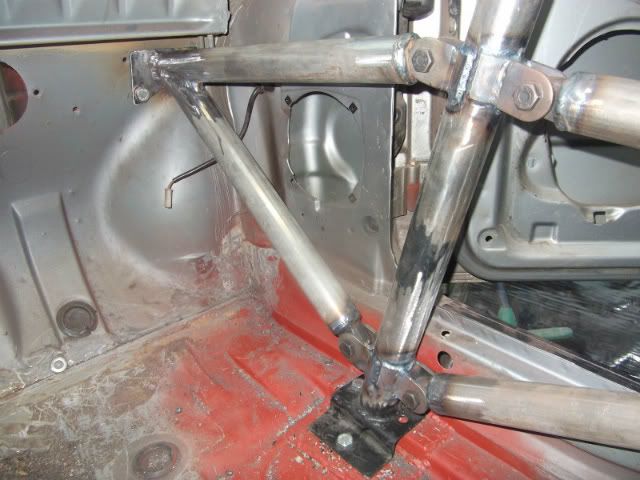

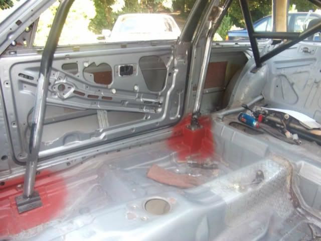

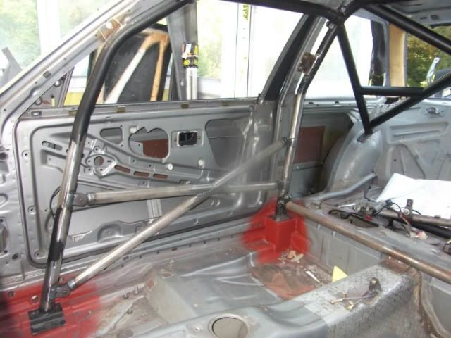

                        Fitted the rollcage and modified it a little......

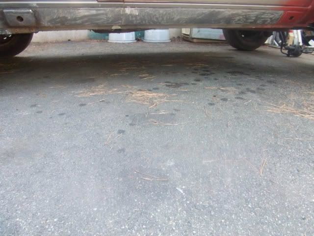

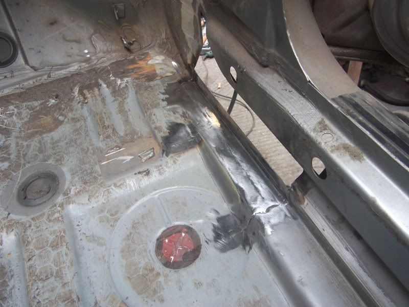

                        welded in some sill stands......

                          is the cage finished? and who's cage is it?

                            Think thats all im going to do with the cage, I may pull it through to the bulkhead/inner wings for a bit of extra protection as I dont like how far back it sits to clear the dash atm. Its just a safety devices B7 cage. Horrible thing terms of bith fit and rigidity in standard form, but I got it cheap with the shell so I'd rather add a bit to it myself than buy another new one.

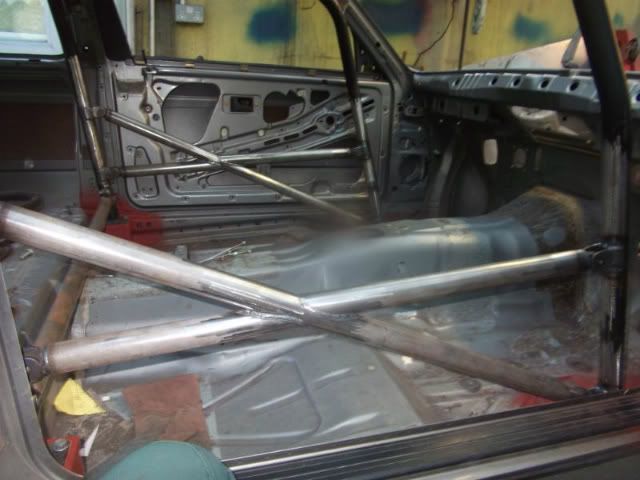

                                Got the bulkhead struts done today, need to get some saddle brackets and another bit of tube to I can put a bar between the front of these and then I'm finished with it.
