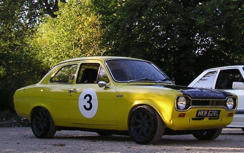

    who can???????????
    Turn my wheels black please??

    Yodi I've just noticed your car still has a toughened windscreen.
    I think if I were going to use it for trackdays I would get a laminated one, infact I would get a laminated one anyway.
    Geting a lap/face full of toughened broken glass is no fun at any speed.
    BTW nice to see you eventually got a working Mk1
    David

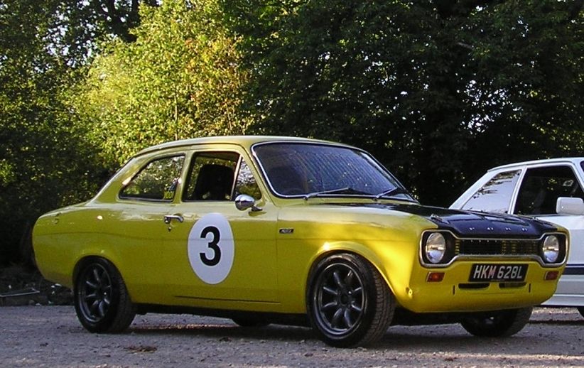

        I made them a bit darker ???

            I think it's the type that breaks into 47 zillion little bits m8
            Unlike a laminated one which cracks, like on a modern car

              The giveaway is the polarising effect in the pictures means it's toughened not laminated ....I think

                Yodi there's nothing "wrong " with it MOT wise but as stated above it will break into a gazillion bits of it gets hit by anything that would just crack a laminated screen.
                I'm not sure if they are still legal to fit to a new car, but you don't see the in cars older than the late 70's much (except perhaps BL cars).
