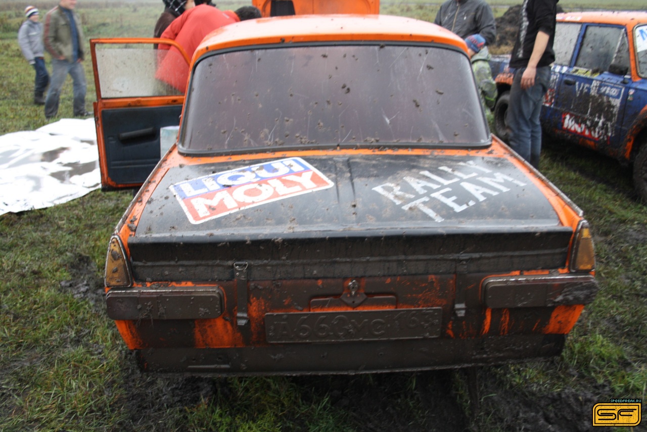

So we went to the rally sprint! It was terribly dirty, but it was a real test of the car and its abilities. We finished six in the overall standings of the 10 machines. Which is normal given the first serious check the car!
So we managed to get the intake system! I and my co-driver Nicholas install it yourself, and even brought. The truth is far from the mixture Ideal I did not program rules.
