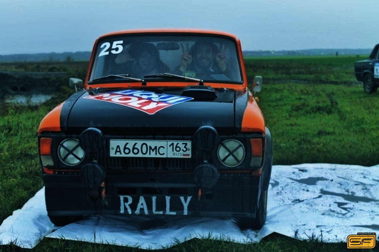

    The machine I have for a long time ... Because of lack of time, the project was delayed for 4 years. Today it looks like this : Танец:
    So, AZLK 412 1987 model year was purchased in fall 2008.
    Largely inspired by the cinema film "Racers" in 1972 directed by Igor Maslov about London Rally Mexico .
    Bought for 200 GBP specifically for the rally
    Built long and hard as the second sports car in amateur rally team.

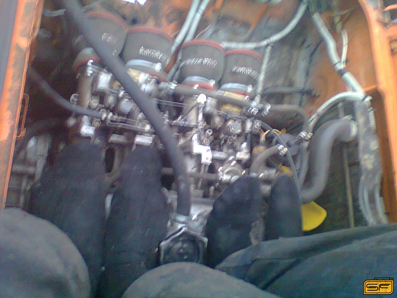

    engine
    USAM-412 2000 cm3
    Compression ratio 9.5
    Cylinder head for sports group 1987 year
    The form of the combustion chamber
    channels:
    36 mm inlet
    Exhaust 33 mm
    Inlet valve from the cylinder head valve unrelieved 248-39.5mm
    Exhaust valve standard
    Camshaft
    "Rally" 11.5/10.0 phase 306/300 overlay 3.5 mm

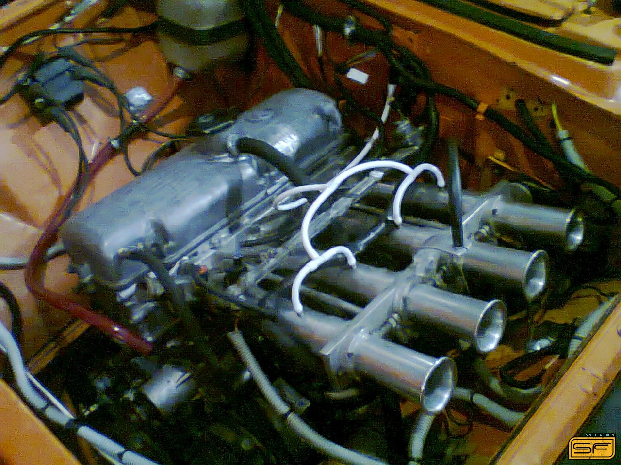

    Power system:
    horizontal two DelOrto DHLA 40, diffuser 35 mm.
    Exhaust System
    standard truncated
    Stselenie
    Prior-VAZ hybrid.
    2141 lightweight flywheel
    CAT
    VAZ 21073 SE 5 Speed ​​Disk Lock 4.55
    suspension:
    reinforced springs, Chevy Niva, 8 leaf springs.
    8 dampers
    Brakes: two circuit without increasing the original system in the cabin.

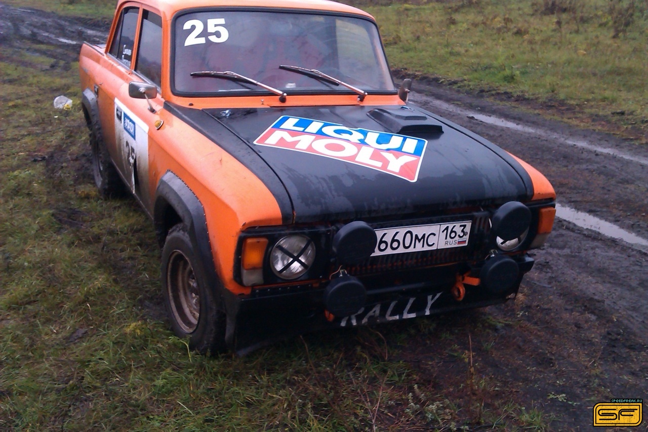

        I bought the car completely standard. Today, these cars usually break for fun, there is no respect for them and they are cheap. When you buy them to have worked 10 years at the plant. The standard 1.5-liter engine, I replaced the 2.0 liter with the latest generation of machines in 1997. Motor AZLK brother motors BMW and Mercedes M 10 M 102 are structurally similar. Under the order was made camshaft, manifold and carburetor for a lot of things. Transmission of the VAZ 2107 is at times more reliable standard! I installed the other 8 damper springs. For 4 years had something to do.
        Here's a photo as it was. Do not laugh, I worked with the machine under the blue sky ...

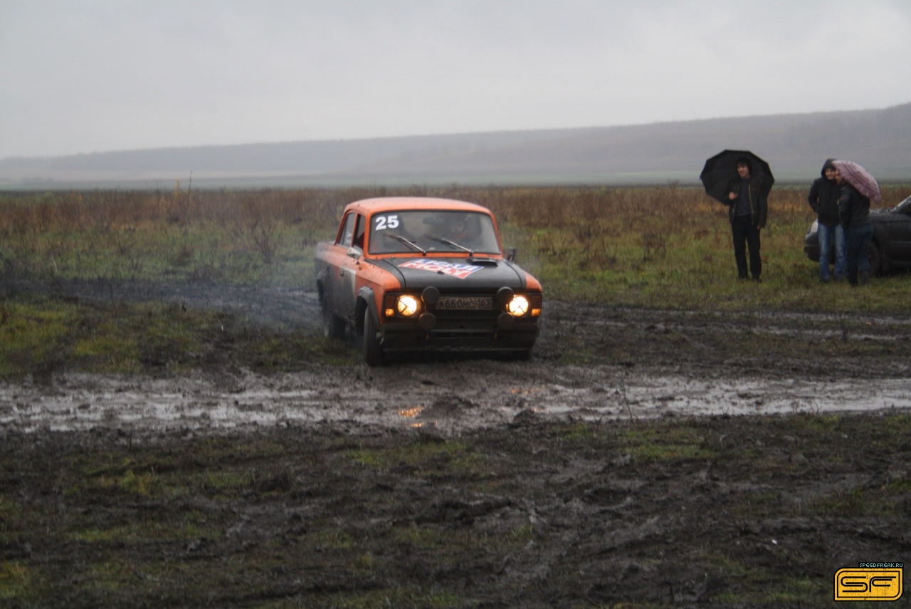

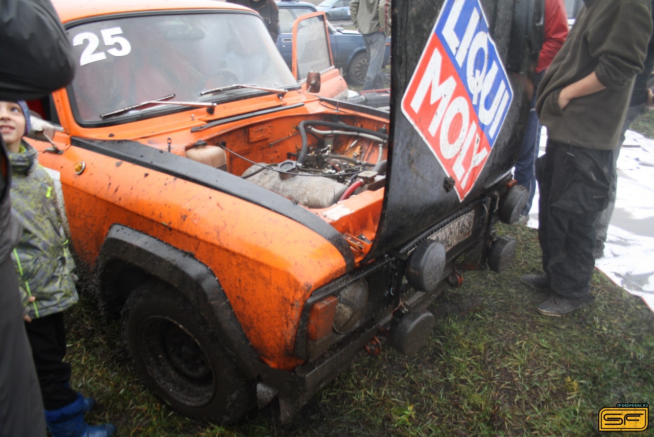

                      So we went to the rally sprint! It was terribly dirty, but it was a real test of the car and its abilities. We finished six in the overall standings of the 10 machines. Which is normal given the first serious check the car!

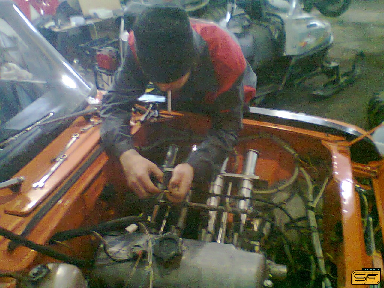

                      So we managed to get the intake system! I and my co-driver Nicholas install it yourself, and even brought. The truth is far from the mixture Ideal I did not program rules.
                      I'm sorry if the pictures have any problems or can not see them or bag
