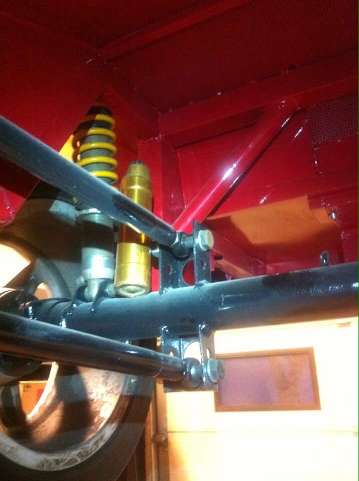

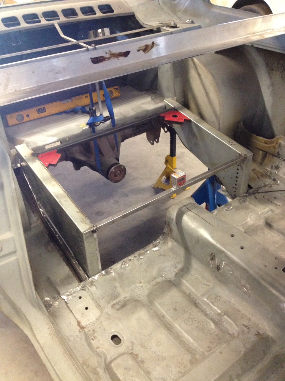

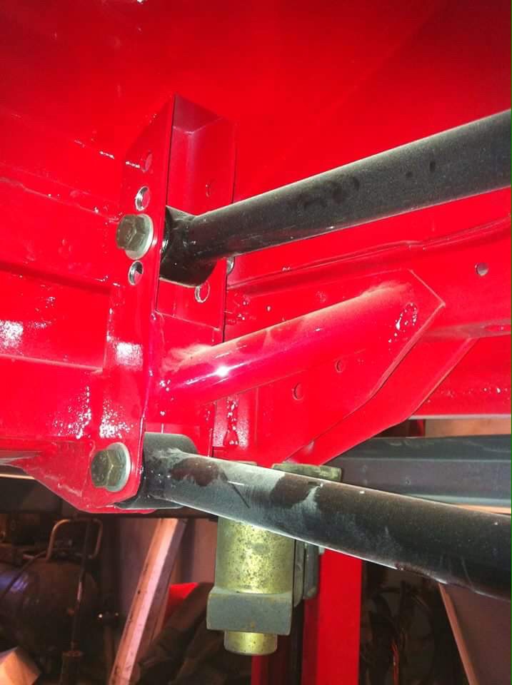

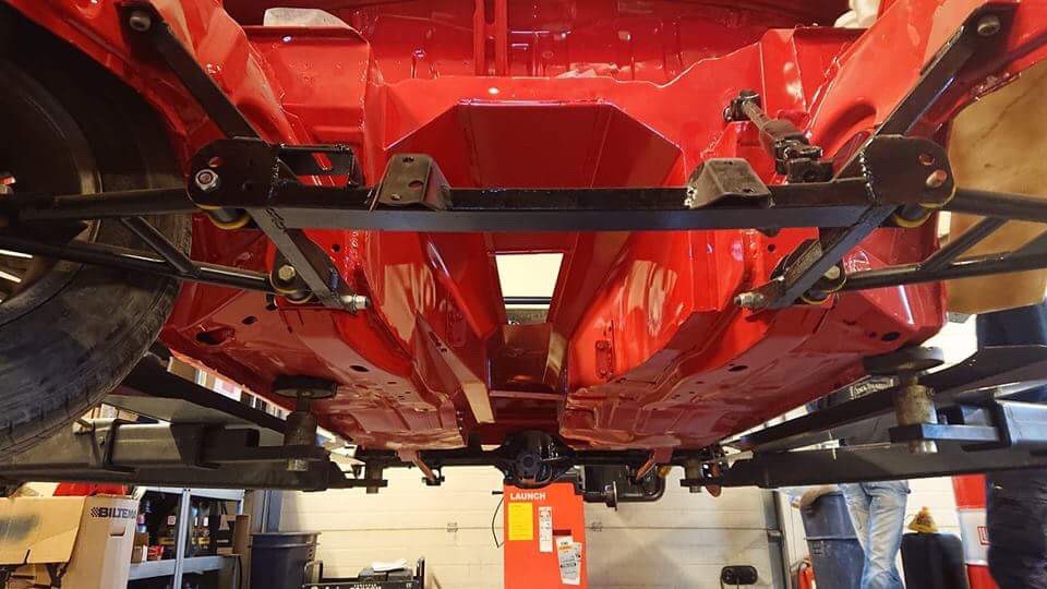

    Some pic of the mk1. Rebuilt the 4 link for low car, And sat it up fore anti squat

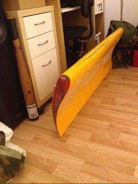

    Started on restoration on a wing blade from a old replica. The blade is 40 years old and need a Lott of work.

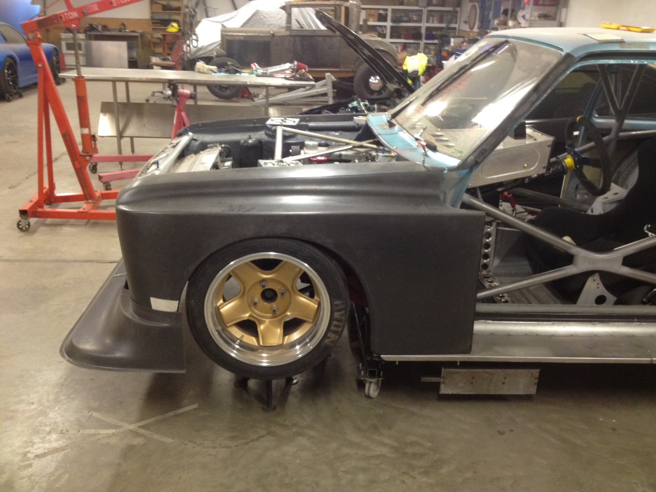

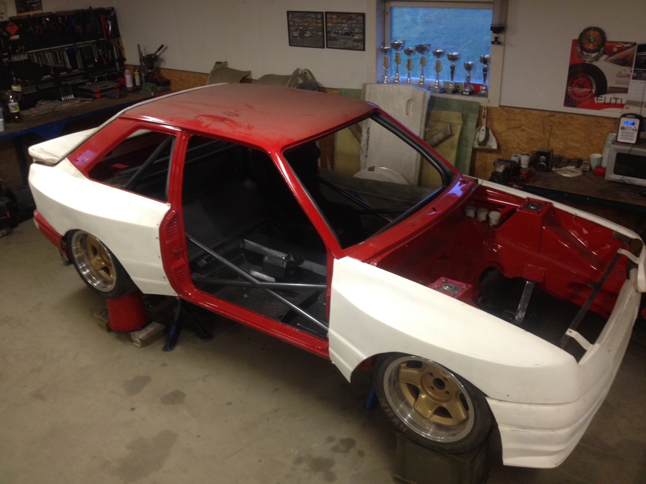

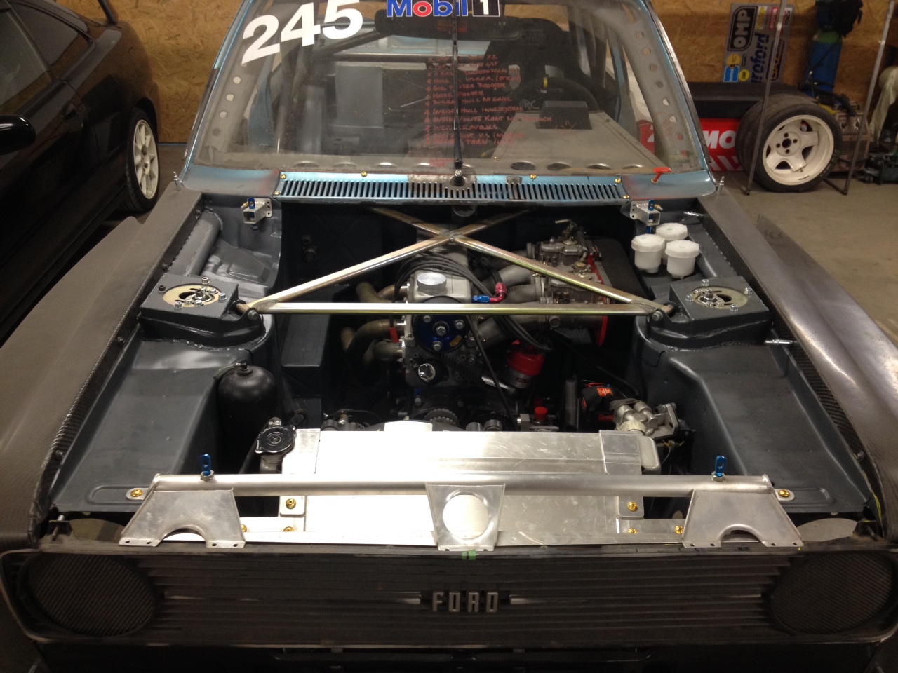

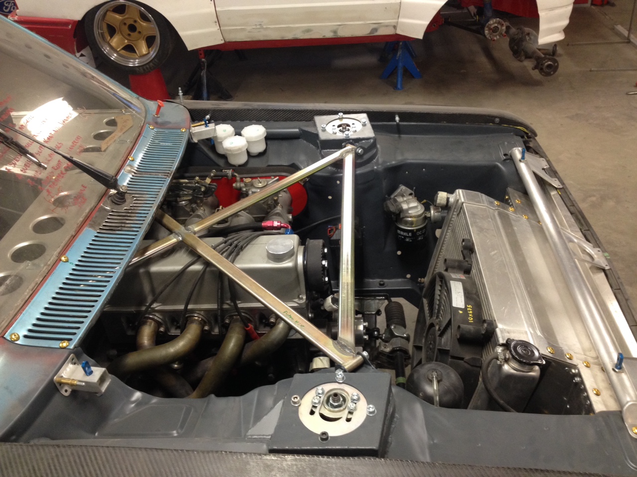

    And paralel with the wing restoration I am doing the final test fitting in the engine bay

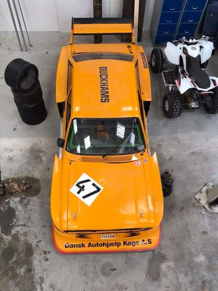

    And a little bonus 😀😀 missed my old G3 replica, so suddenly in the garage I had a new built Rallycross Escort.
    My priorities are still on the mk2..

      Looking amazing, Loving the strut brace. I might need to copy that

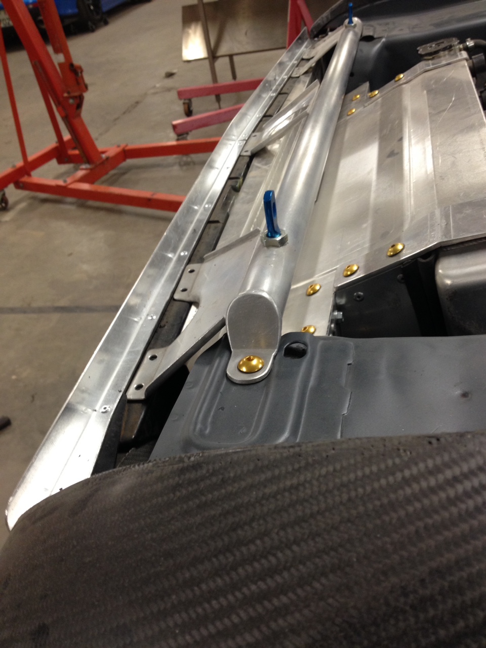

        Thanks Matt, the strutbrace is made of std gr4 struts, by the way.
        Did some little things today.
        To prevent the hood to lift in high speed, since it's made of lighter material, I made an little air dam for it, like Zakspeed did.

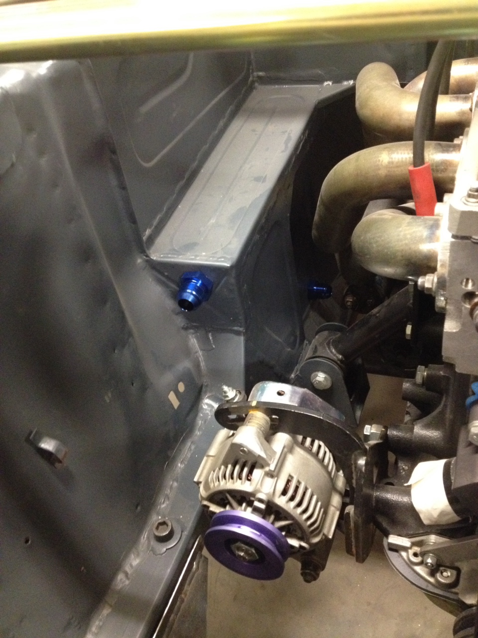

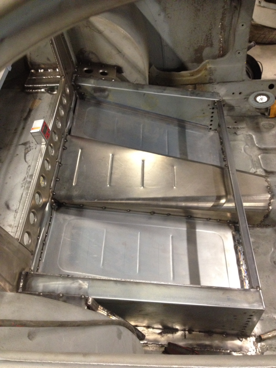

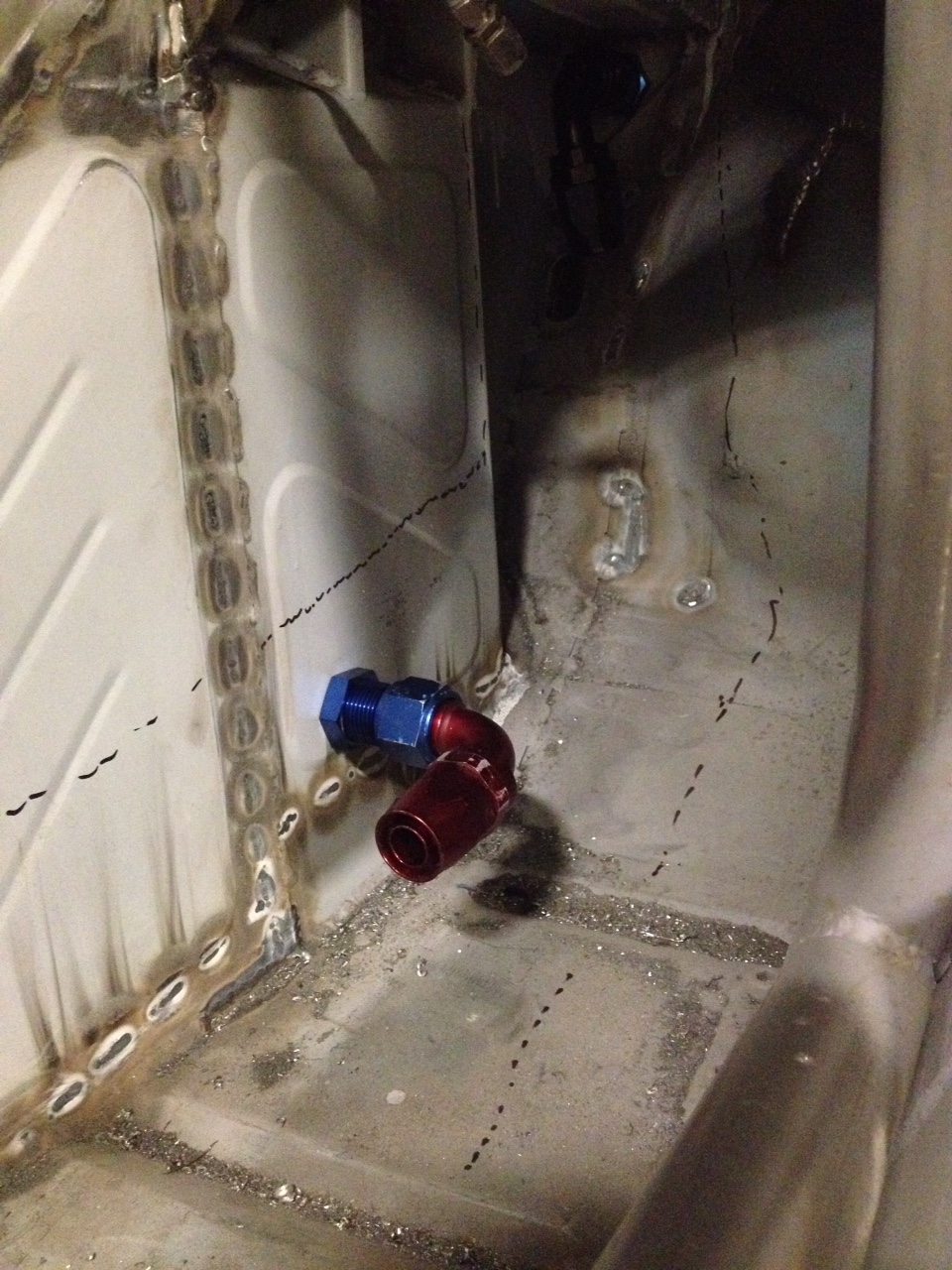

        And planed the route for the dry sump. Had to be creative since there's not good space and it's a bit custom. The feed is level, and that's the important thing. The return is pretty level too. 👍🏻 return on the bottom , dry sump tank will be on the right hand side in the car (I am sitting on the left hand side)

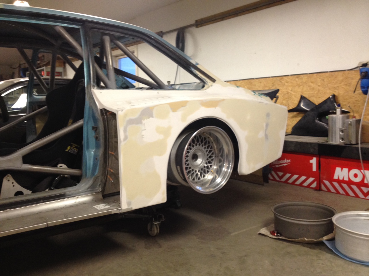

        And finally Ringspeed ( my engine builder) dropped by whith some wheels to test.
        Ringspeed s BDT Anglia here

          Correcting the return on the top. 👍🏻

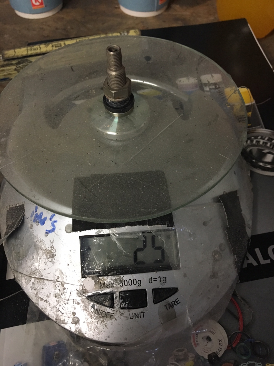

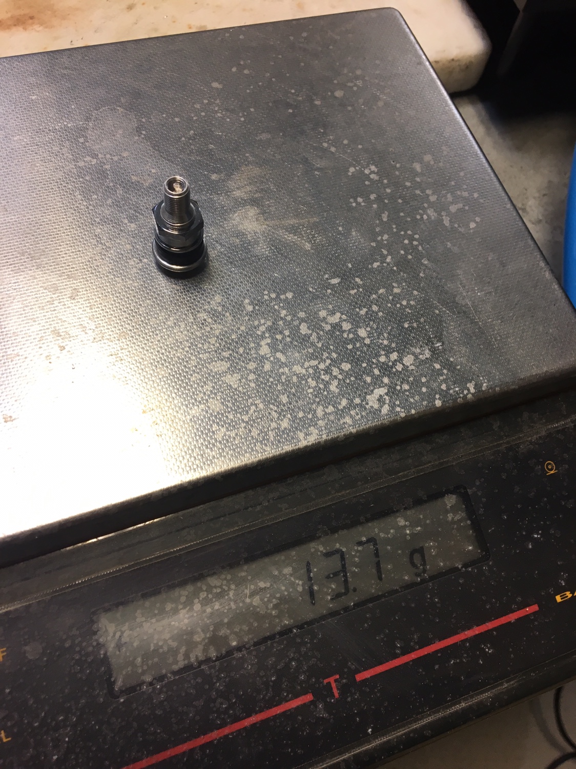

              Did receive the last parts for my wheels last week.
              And did go for some aluminum vents after some checking. (Devils in the details)
              Steel
              Alu

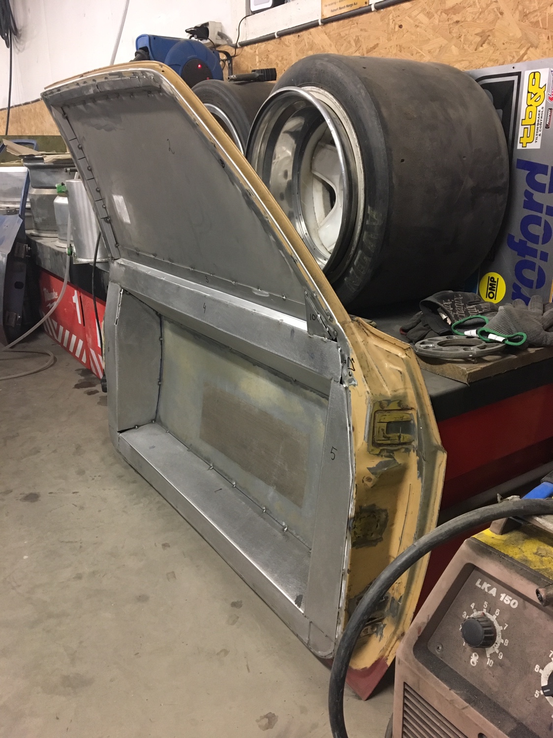

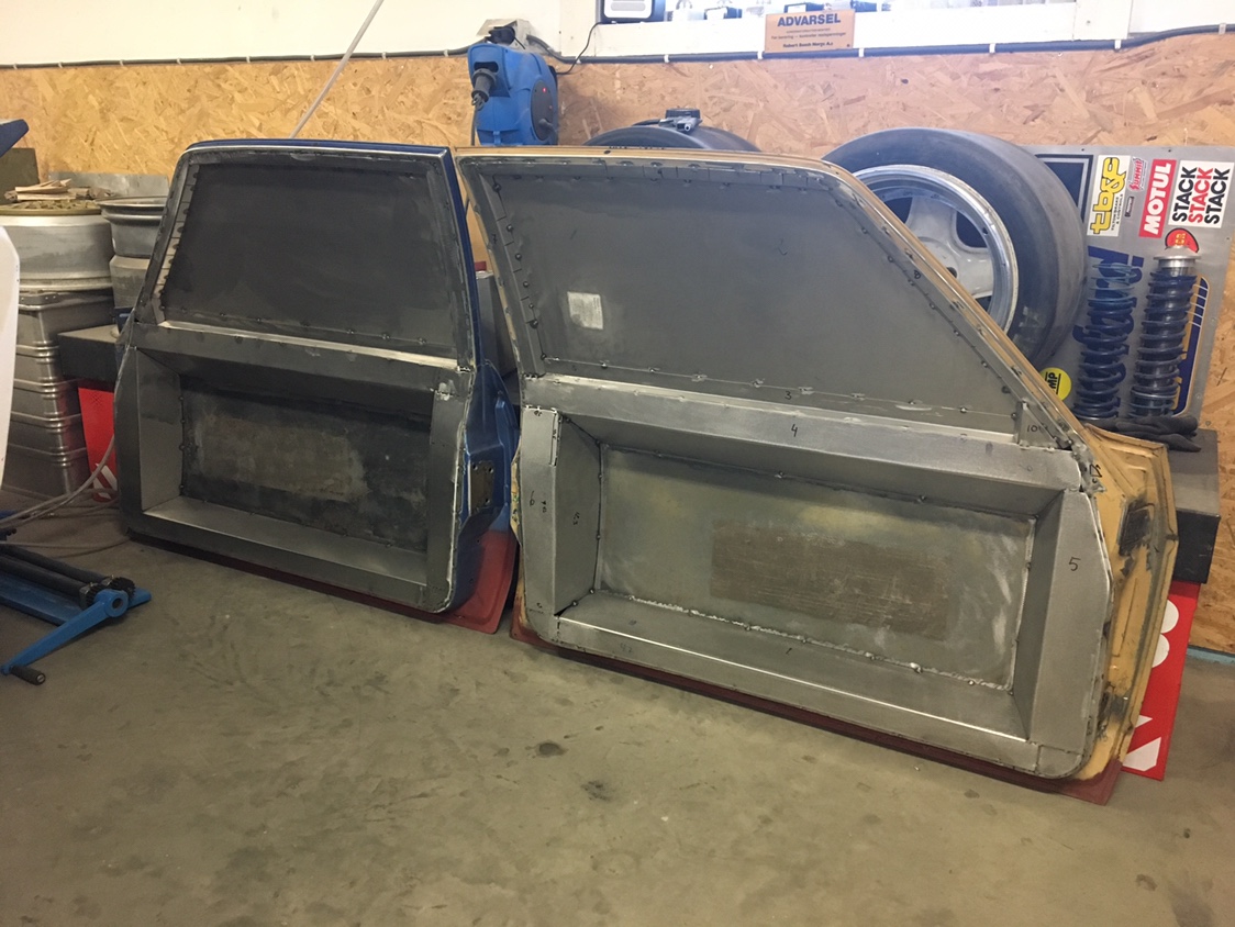

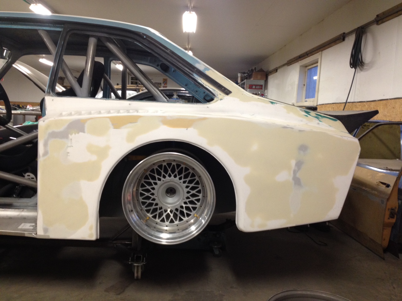

              And made plugs for the moulds to the doors. My aim is under 5 kg when finished ( front and back will be glued together when finished in carbon)

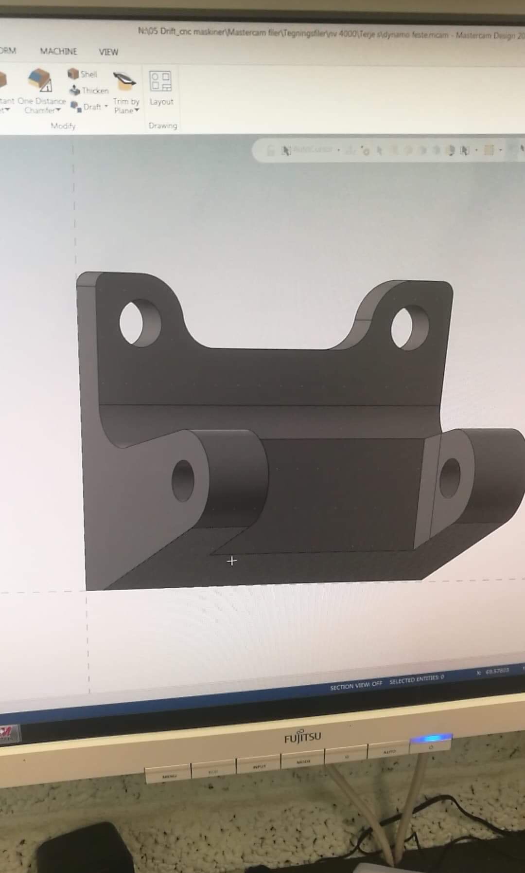

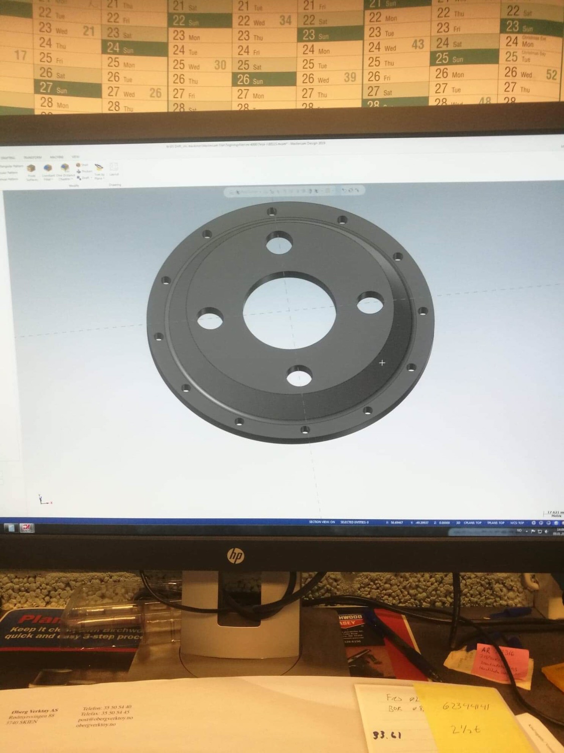

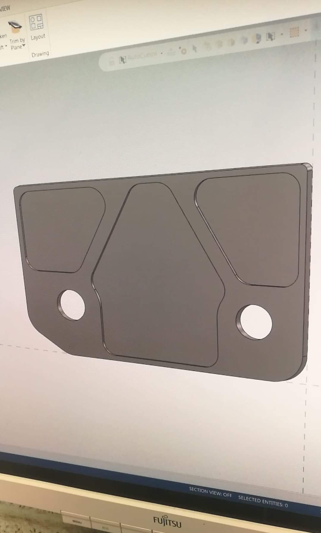

              And a friend are making some new parts
              For the suspension, brakes and alternator
              One day it will be finished 👍

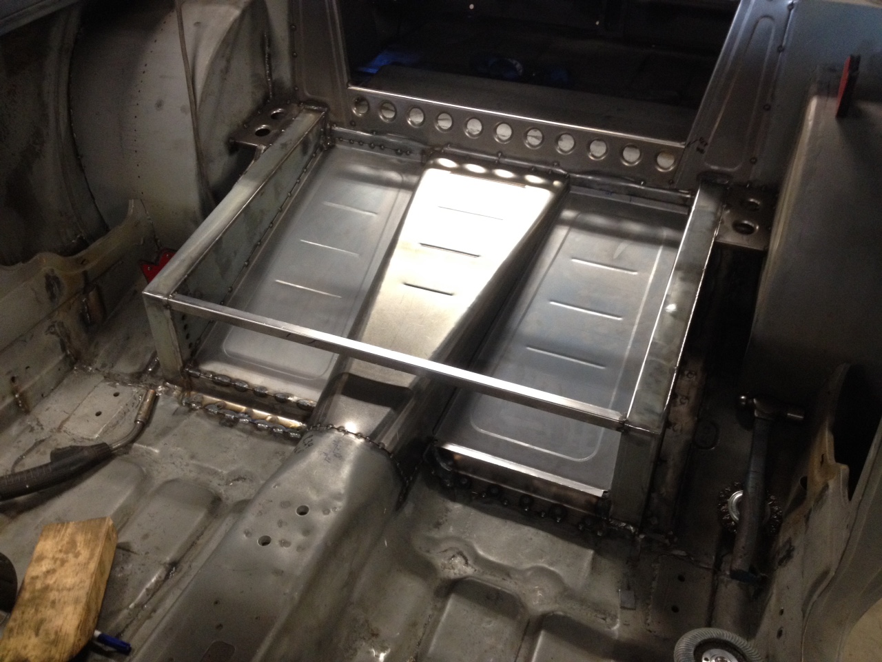

                            Some pictures of the front suspension work
                            New brake parts done
                            Made new front suspension geometry for the mk4
                            And just cut out the old 4 link

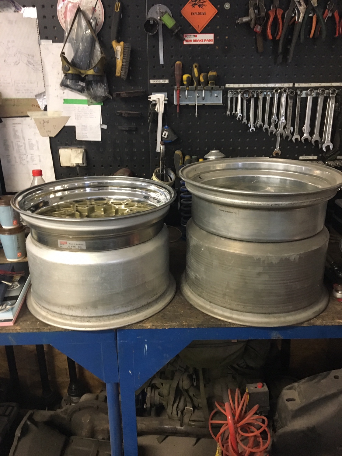

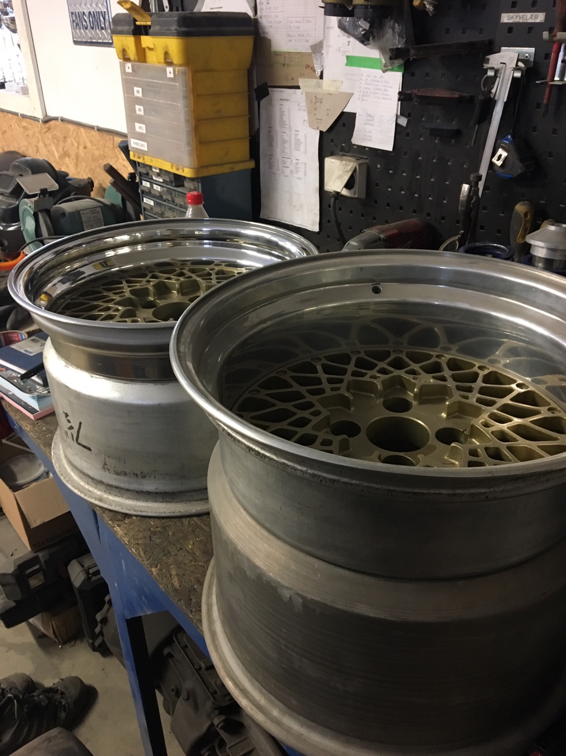

                            Also been testing diference wheels and width with different axels
                            Hopefully will get some more done this winter
