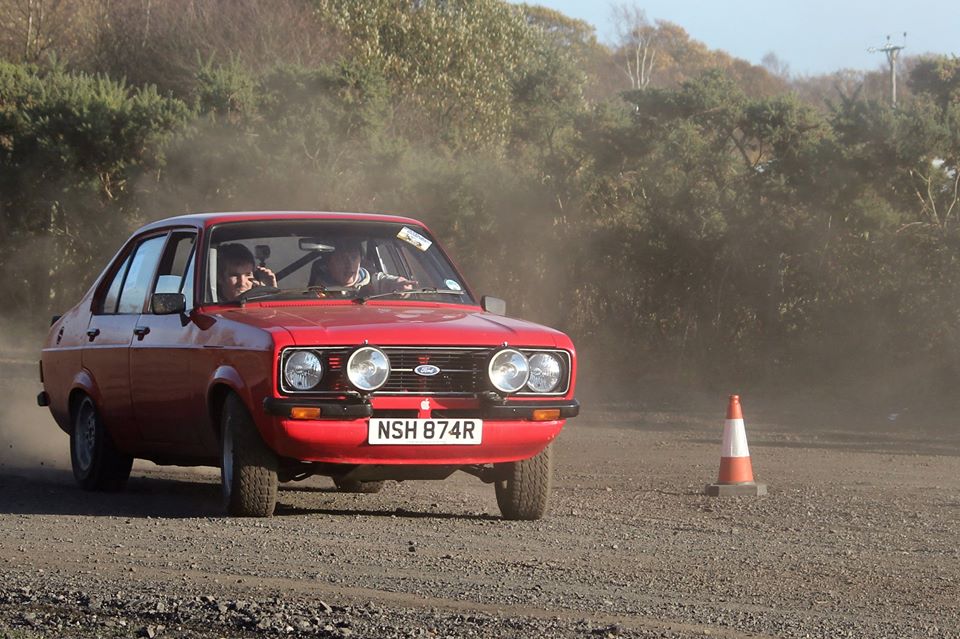

    this was finished just in time for a local event a tranwell woods very local to me being about 2 miles up the road. using the works van and trailer saved me having to mot and tax it and plus would be good if it broke again
    id entered along with my dad who was also driving in his mk2 and we were navigating for each other.
    was a brilliant day finished somewhere in the mid teens after a few penalties. the new handbrake setup was working really well and i couldnt stop myself from using it n every corner. managed to turn a set of newish knobblies into slicks as well.

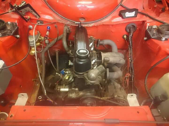

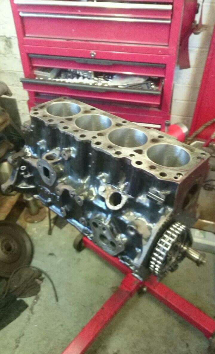

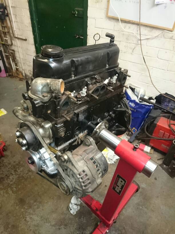

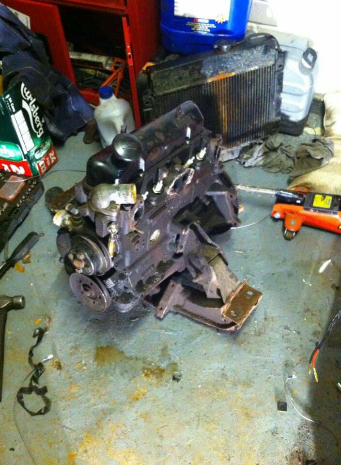

        So had a drive up to scotland to meet a rab off here to buy a 1600 xflow
        It was very cheap so i didnt even bother looking to carefully at it thinking i could sell it in bits if anything was wrong with it.

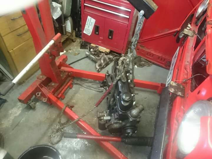

        I got it home swapped the sump over to a baffled one i had already and put it in the cornr of the garage all wrapped up.

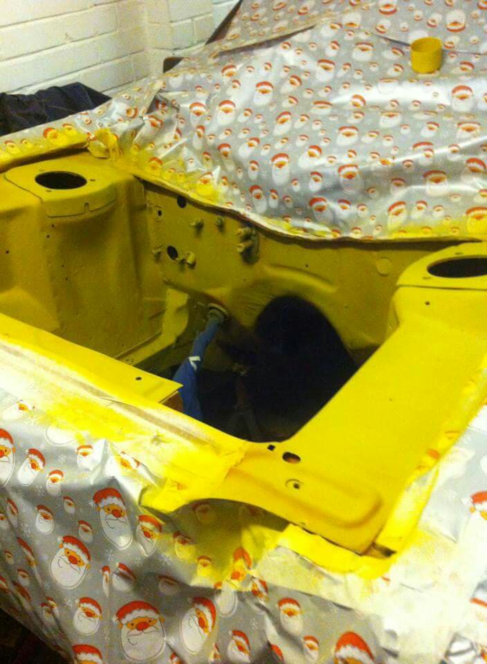

        Pulled the old engine out and started stripping the bay
        Stripped and in primer
        This took days to get to this stage

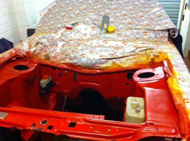

        Seam welded everything and added the grp4 strengthening kit
        And finally in topcoat
        On boxing day hence the wrapping paper masking

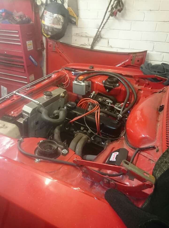

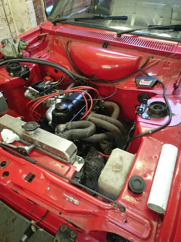

          Then few more jobs

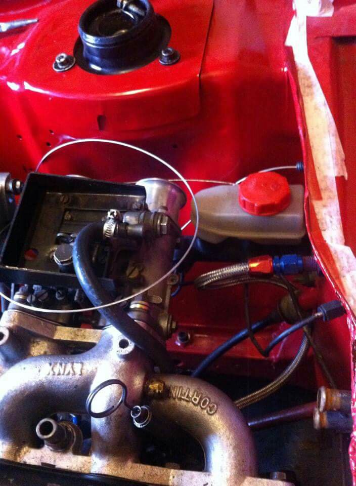

          New radiator,Distributor, starter, type 9 box amongst other things
          Setup on a single 40 on a lynx manifold to fit with road rally regs

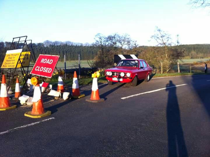

          Then out to marshal on the flying scotsman
          Brilliant event where only pre wars cars allowed to enter
          Brilliant seeing pricless bentlys etc being hurled around
          This is just outside rothbury near paperhaugh just after the rothbury road fell into the river
          Shame i used to use that road a lot for testing

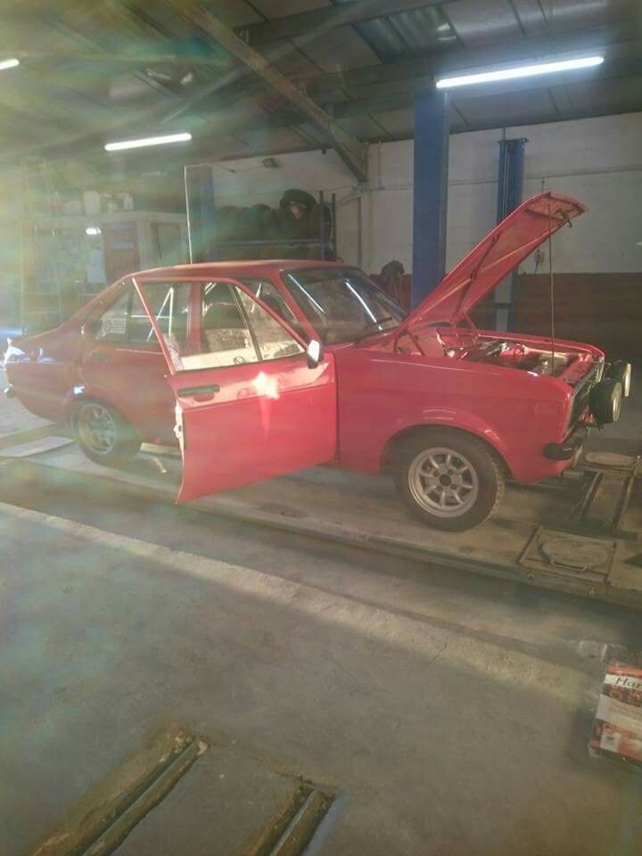

              Picture above was in 2015 got tye nee engine in over christmas and im the new year it was running.
              Was hoping for the first 12 car of the year but the starter packed up the day before so didnt want to risk being stuck in the middle of nowhere.
              Starter replaced with a high torque one made life much easier for starting and it could be fitted much more easily than the standard one.
              Took it to bogg brothers in malton to be setup after spending a few hours changing jets etc he did a power run and the meter went up to 125bhp
              Bit optimistic on this spec but the car was running and pulling well.
              Only other change was a set of princess four pots which made a big difference to the braking andi the car was ready.

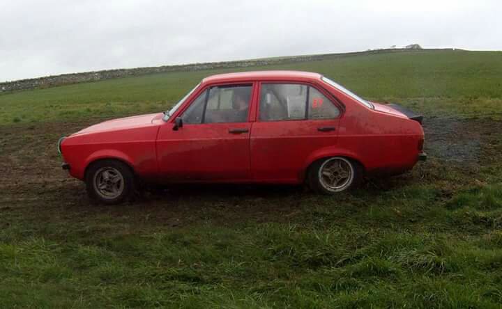

              And then onto a field test which was hopless as it was so wet and slippy we couldnt get off the start line
              Everyone got a maximum as it was taking so long to get round
              Great fun though

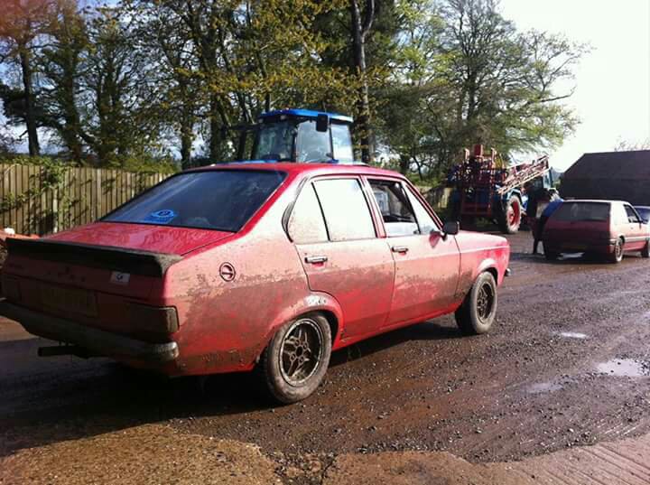

                Next event was the shaw trophy
                Similar type of event but no regs just nice drive in the country side and blast round some tests. Started locally in the town of morpeth.
                Jess my partner was also doing this navigating for my mate josh in his proton whilst hannah his girlfriend was sitting in with me as usual. As you could enter as a team we entered under the name of team wife swap 😂😂
                Started out well enough although miserable scrutineer didnt do much to calm people we set off car 16 behind my dad who was car 14 and josh at 6.
                Off onto the road and the first two tests were cancelled because the land owner wasnt happy with the speed of the cars😔
                So straight into the third test ran twice around a big farmers yard.
                Didnt go well when we went round a cone the wrong way and got a maximum hannah didnt tell me or i would have reversed
                Still second time round and we were fastest that was more like it.

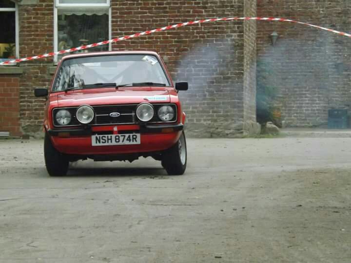

                Next nice road section to belsay where a few tests were laid out on a clubmembers farm

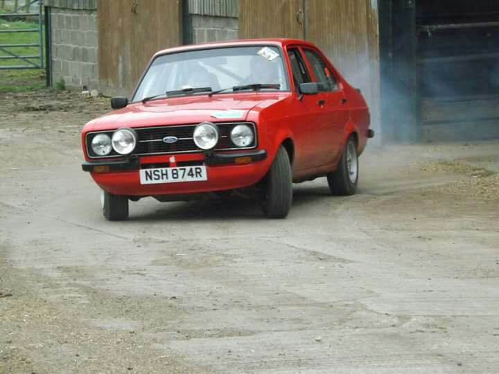

                First one i was revved up so got off the line well flat in third to a stop astride reverse back and tried to j turn round
                Messed it up but still got round quick

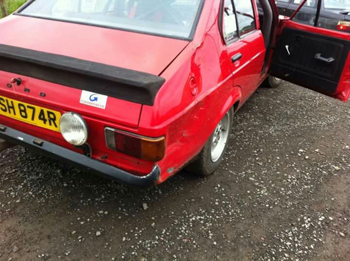

                Slot left in to a big compound round a few cones

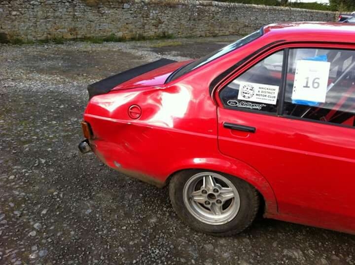

                Had the mk2 drifting nicely then came back out onto the main track too sideway with the rear end in the hedge
                Unfortunately for me there was a big concrete post hiding in the hedge which i hit
                The car still drove ok and after the miserable scrutineer had a good nose around we carried on

                I new the car needed some tidying but now it needed a lot!

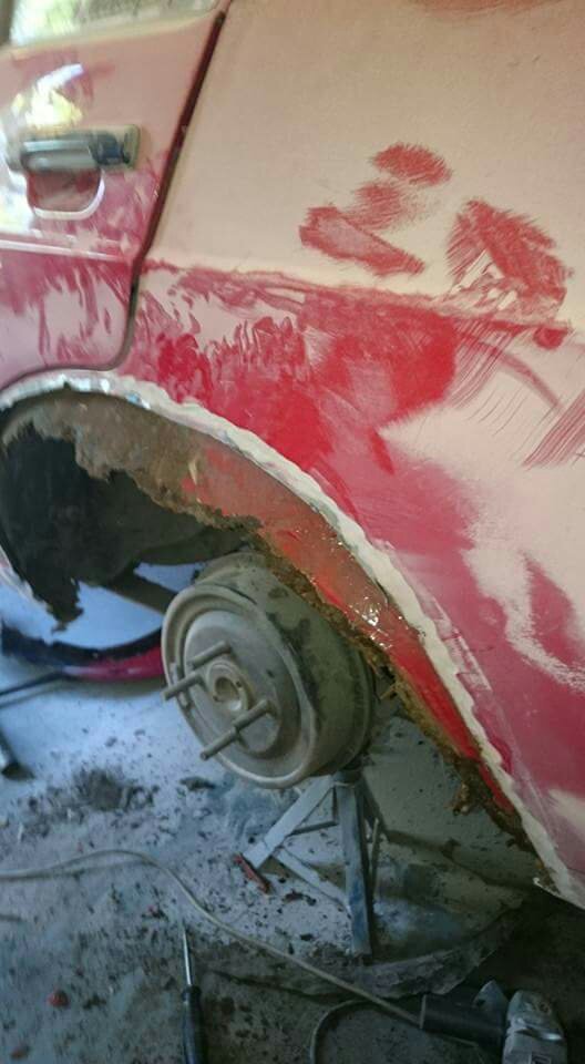

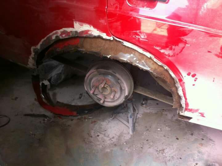

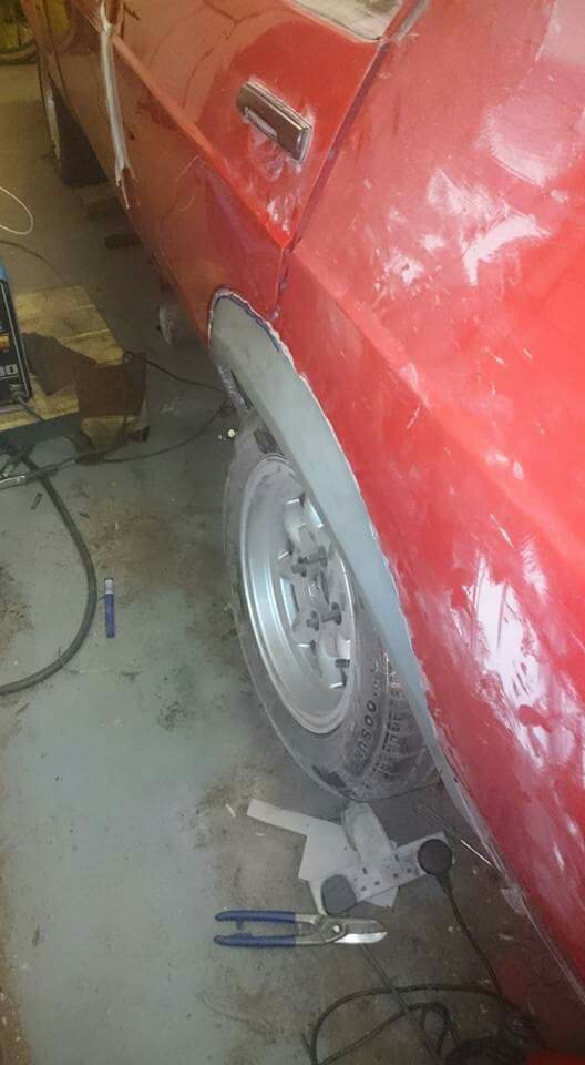

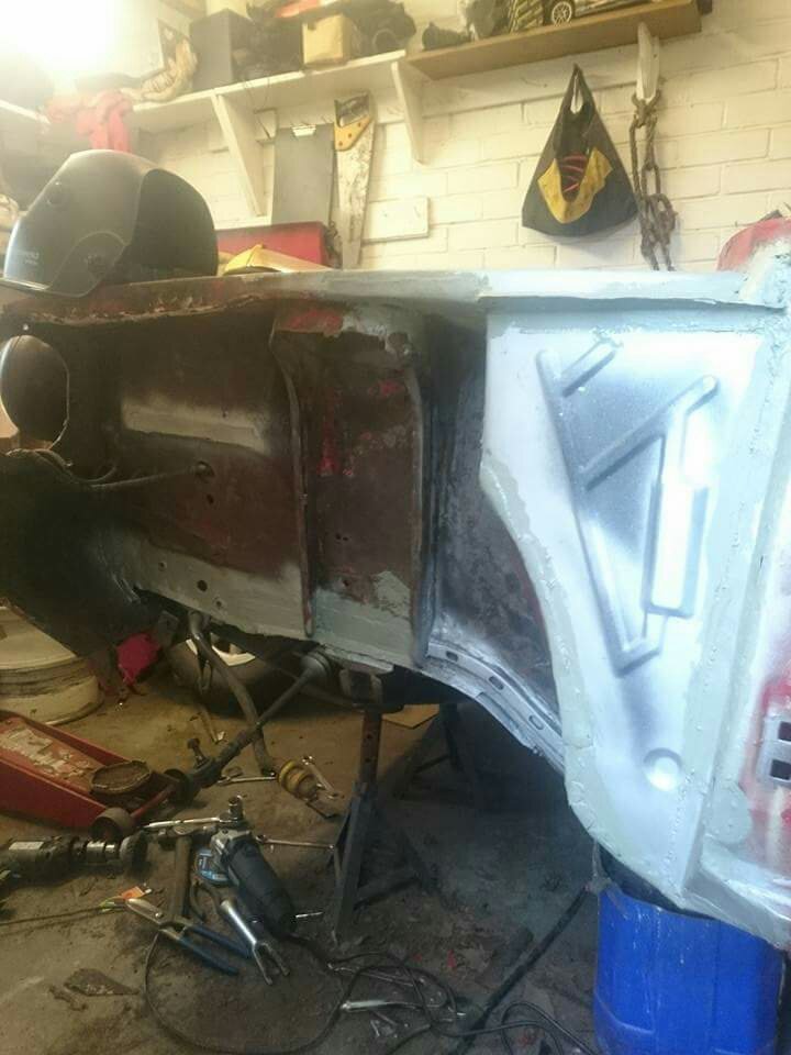

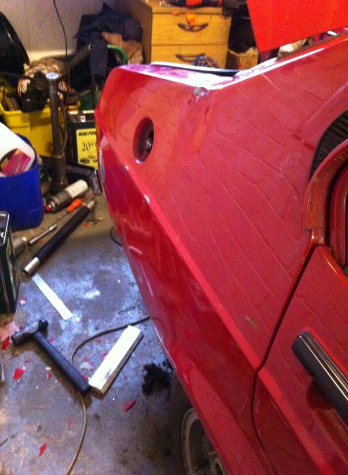

                  So the rest of 2015 was spent reparing the damage
                  The quarter pulled out quite well
                  But both rear arches were well rotten including the tubs
                  This took ages
                  But shell was solid and straight again
                  Few more repairs to the inner sill and the splash panels on the front but apart from that the shell is mint

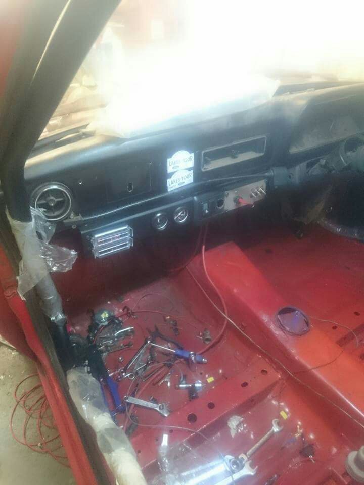

                      2016

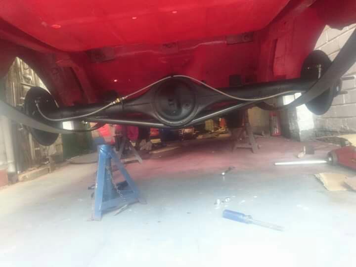

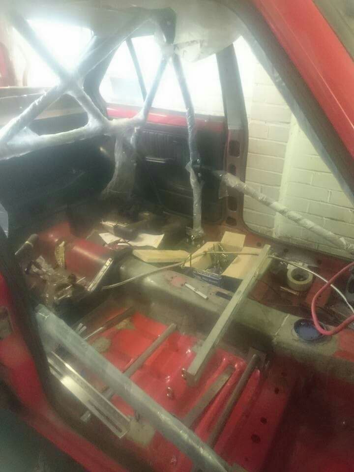

                      Car went away to have the repairs repainted and cameback bettter than new

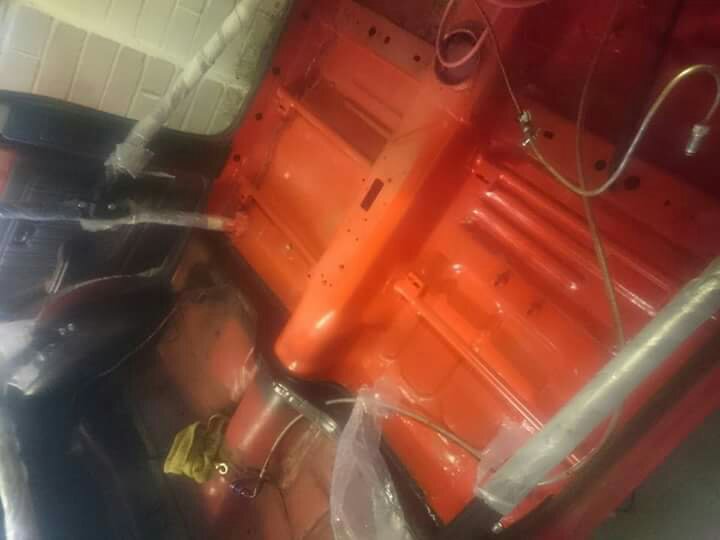

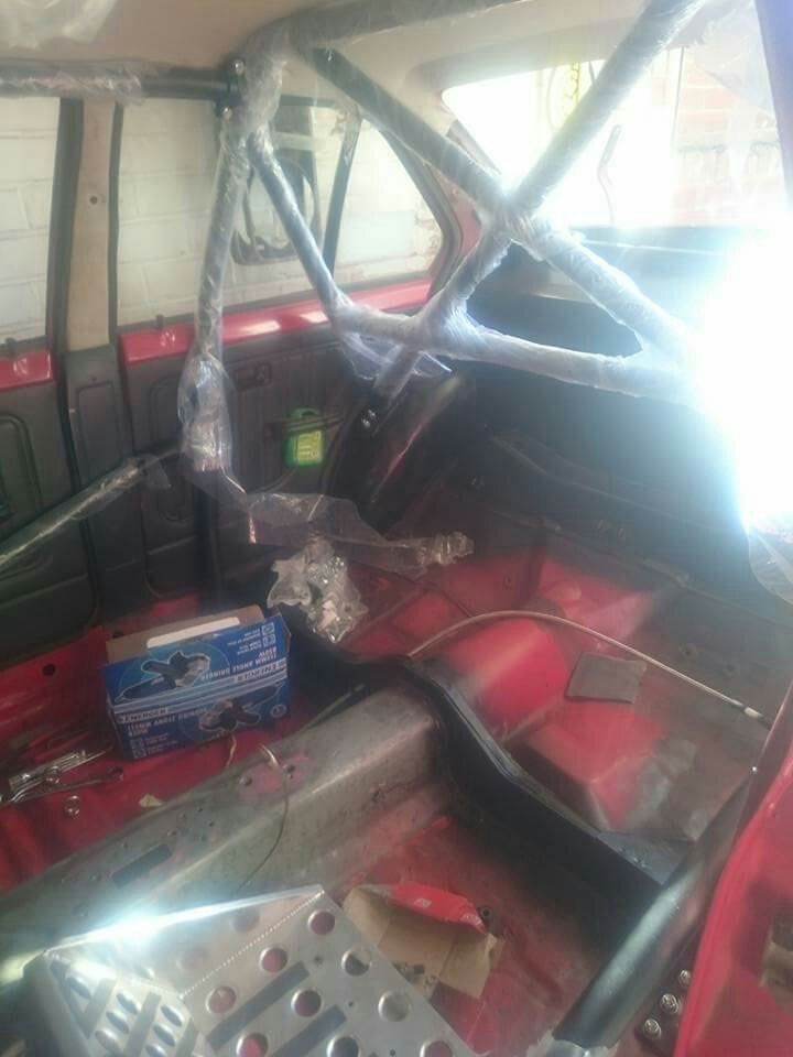

                      Id never been happy with the cage in the car
                      It never fitted too well and it meant i couldnt get the seats where i wanted them
                      So sourced a safety devices cage from west wales rally spares
                      Seat bars in
                      Car was the fully rewired as stuff had just been added and changed so many times
                      Tank and tank base
                      Got a sender from america to work with the original gauge
                      And rebuilt the axle and added a brace bar
                      Lsd was rebuilt with new plates
                      That took me to end of 2016

                          So over the xmas had a bit of spare time finished all the jobs off and took it for an mot
                          Passed no problem and alan the mot wad impressed when we took it up the road
                          Despite the icy roads meaning the brake test was pointless😂
                          The to the first event of the year the january jaunt
                          Ran by hexam motorclub they do one once a month on wed night
                          Except in the summer with the light nights
                          55 mile route of challenging navigation and had chris dodds on the maps who normally drives a very fast 205
                          He is also a very good nav competing on lots of events on both sides of the car
                          Went out for a bit of practice the night before finding none of my tyres would work in the greasy conditions and more worryingly the engine was breathing very heavy filling the catch tank after only a few miles 🤔
                          Too late to back out now i refilled it with oil and just made a plan to keep the revs lowish and see what happened
                          To the event itself the roads were still horrific so cold and greasy everyone was having problems but at least we stayed on the road
                          First section went well until we missed a slot and dropped two minutes
                          Carried mostly sideways and doing well only problem was when one of the marshals tried to take doddsys paper work off him 😤
                          And stopping at a junction to see a taxi on a late night run pulled out after him and doddsy made a comment about hoping we dont get stuck behind him
                          Wasnt a worry as he must have been a local i couldnt keep up he was flat over all the crests and blind bends
                          Needless to say i dont think he had a fair onboard😂
                          Got to the finish without problem to see we had dropped four minutes which was impossible as mick who started 3 minutes behind was on the next minute to us and they cleaned it
                          In the end we were second behind mick so didnt bother chasing it.

                            Pulled the engine out at the endi of jan
                            It was minging the whole bay was covered in oil and other things found in the country side
                            And out
                            Stripped it down to find the bores were well worn and oval the ring gaps were massive
                            And both main and big end bearings were showing signs of wear
                            So everything was cleaned whilst the block and crank were sent to be sorted
                            I had some 1300 40+ pistons as spares so they went in along with new mahle bearings the cam and followers looked mint so they went back as they were
                            Part way though assembly
                            And finally back together
                            Abd in place
                            Doesnt look any different but what a difference.
                            Must say a big thanks to mark ( onecamohv) who i pestered with endless engine questions
                            So that brings us up to date
                            Just running the engine in now done about 150 miles and its on its second oil change
                            Its pulling much better starts better and not using any oil or smoking
                            Its starting too loosen up now as i increase the revs
