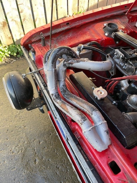

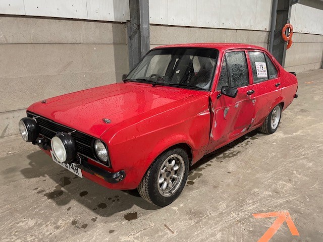

    here you can see the damage done
    Im meant to be competing again at the end of march but all i have had the motivation to do is take the manifold off and take pictures to send to the supplier. It hasn't been hit or had an impact and is properly supported so i'm a pissed off its broken. it's been on less than a month!
    The supplier have agreed to replace it but i think i will strengthen it myself before it goes back on

      shame that, part of the issue of the exhaust it really needs bracing against the bellhousing to avoid having manifold having to handle twisting forces placed on it by engine/exhaust system movment
        • 2437
        #138
        Re: my road rally mk2
        That’s a good idea I’ll try and add one
        I’ve added a further mount on the floor and changed to spring mounting the exhaust so it can twist now
        Hopefully it stops it happening again

          my dyno mule manifold just broke like that for the second time! and its not got a whole exhaust hanging off it just a 4 foot length of tube. im going to have to make a brace for it

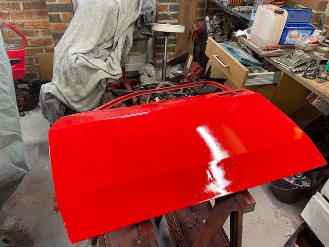

            After sorting the manifold I started to get on with the body work.

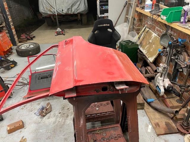

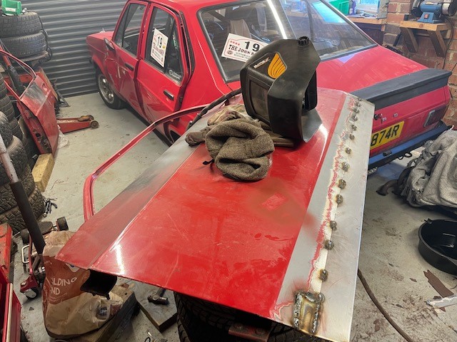

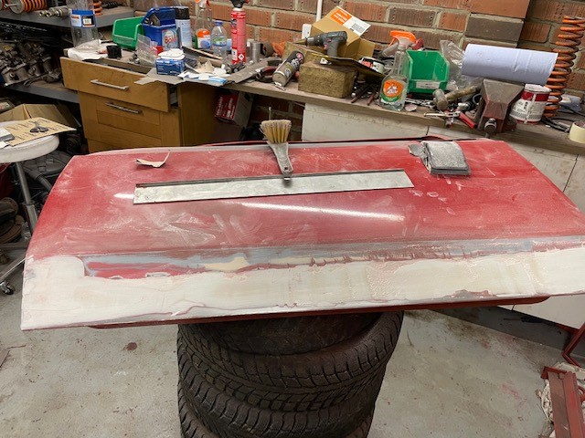

            I managed to buy two doors locally which were a lot straighter than mine but needed the bottoms repairing.
            And some filler
            and primer
            and finally in paint
            i'm glad i made the wing bolt on this made it much easier to knock the small dent out.

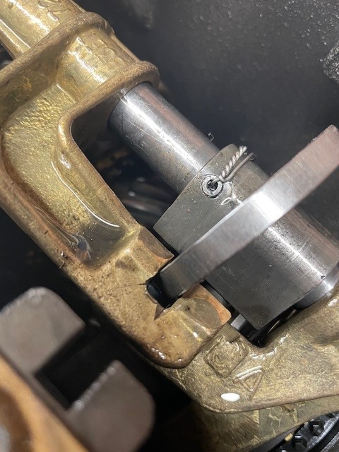

              As for the box i have machined and ali plug that now bolts into the casing and i have made a much better breather for the box so hopefully it doesn't happen again.

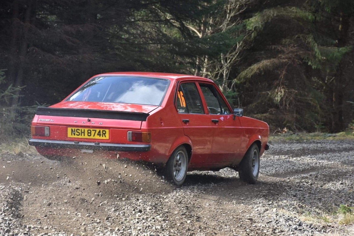

                        I haven't updated this for a while but quite a bit has happened.
                        Firstly the engine was due a rebuild. It was noted on the Rolling road that it was breathing quite heavy so now i had a gap between events i took it out to give it a refresh.
                        After stripping it i found it had broken a piston ring but somehow hadn't damaged the bores. It also must have been starved of oil at some point as the crank was looking a little sorry.
                        The crank was sent away for a grind and the block was honed ready for new bits. it had all new bearings and new pistons. it went back together without problem and i ran it in. It was giving good power and not using any oil or breathing heavy.
                        After this there was very little to do before the Berwick classic regularity rally.
                        This is a popular event with regularities on the road and tests on private land all based in the wonderful borders countryside.
                        I borrowed a friends Camper van to tow the car and sleep in as the event was over two days.
                        Dylan was once again in with me and after some practice during the week (whilst running the engine in) we felt ready for the challenge ahead.
                        The first road section was a slow cruise up the A1 before turning off into a large farm for the first test on the saturday afternoon.
                        This went well a little slow and struggling for grip but i just wanted to have a trouble free event and not put it off on the first corner. A time in the top 20 was good enough to start with so we were happy and headed to the next test. I cant remember this but it must have been ok then we headed into the first regularity.
                        Our system was working well up until about 5 miles in where we wrong slotted but managed to get back on track. we were pushing hard trying to make up time but ended up stuck behind another car (A very nice Marina coupe which sounded great) we realised we weren't too far off our desired time so stuck behind them which worked well and enabled us to see a NAM triangle (not as map, meaning you have to go the long way round a junction or into a layby normally) that they and a lot of other missed which got them a penalty.
                        The regularity then took us off road round a maze of farm lanes which was very tricky but good fun and we managed to not drop anytime. This meant we were lying 16th overall come the overnight halt which was far better than we expected.
                        We then went for a beer and some tea before a good nights sleep ready for the next day.
                        Then a small drive to the finish in wooler the following morning to drop the van and trailer off before a cruise up to Berwick Quayside for the restart.
                        More of the same today with a lot more tests which all seem to blur into one. One i remember was a really good test through a woodland sliding in between the trees
                        A few more regularities now and we were getting into a nice relaxed groove. i was getting quicker on the tests too which meant we had moved up to the leader board to 13th.
                        Then onto the last test where we were going well and showing off for the photographer a small jump over a wooden bridge and into a nice flowing gravel track.
                        There was a yump at the end of this that we took a bit quick and landed heavily in a hole on my side. This winded me as we landed on the sump Guard but we managed to continue to end of the test albeit slowly and got caught by the car which behind. At the end of the test i got out to catch my breath and realised i had hurt my back quite badly and done some small damage to the car. we drove the 200yrds back to the finish vewnue and put the car on the trailer and i got checked out by another competitor who happens to be an A&E nurse. all looked ok just a bit of a jolt.
                        bit of a shame to end the event like that but we still had a good result and kept our 13th place.
                        I was a bit sore for the next week but no real damage. Unfortunately this was to be the last event for a while as i pulled my entry for the White rose classic due to my back.
                        more to come

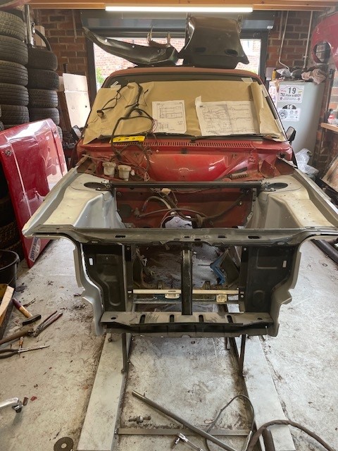

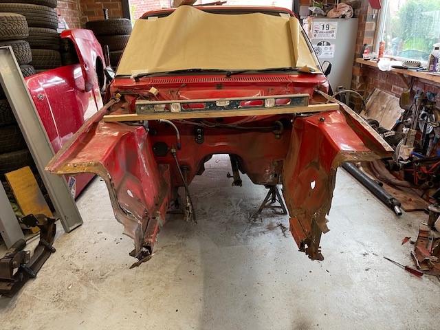

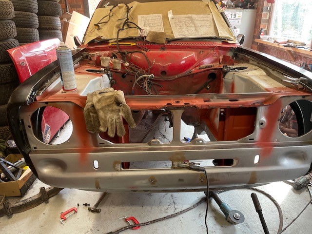

                          After the event i was spannered for a few weeks and really not in the mood to do anything to the car.
                          I eventually got round to looking at it and decided that i wasn't going to mess around trying to repair the existing damage.
                          After the trouble i had fitting the wing and front panel a few months ago i was convinced something wasn't right with the chassis and after some measuring i realised that the chassis rails had a bit of a twist in them.
                          The inner wings and inner front panel were also quite shabby with numerous patches so i decided to go the whole hog and replace the lot.

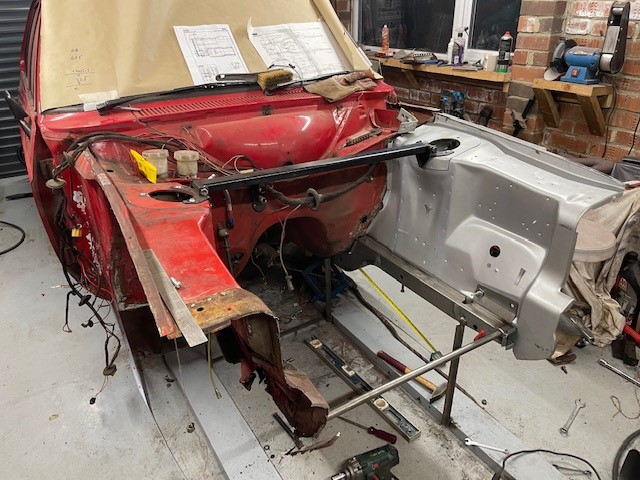

                          after a few hours cutting i got to this point below.
                          Here you can see the twist, its always been there but after various bumps and events it's gotten worse, add to that more and more rust which i have patched and replaced there wasn't really any other options

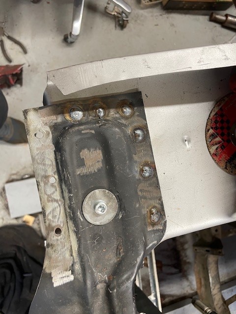

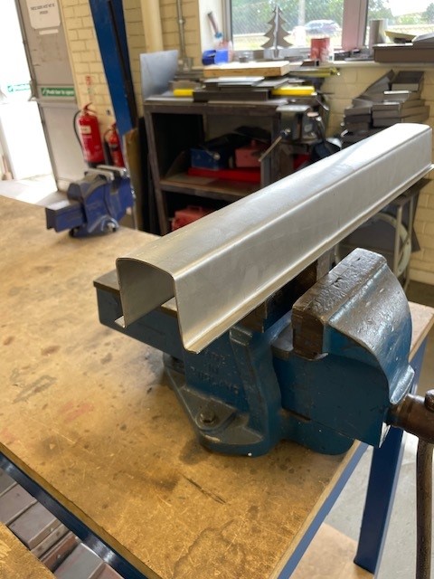

                          I folded up a repair section for the chassis to extend the part that fits into the front chassis rails.
                          hopefully this will add to the strength
                          And this is the point im at now. I made a jig to hold it all in place and its tacked in now ready to start the other side
                          you can see there is a small gap between the inner wing and the bulkhead this needs to be pulled forward to meet the wing and bring the bonnet hinge down to the correct place.

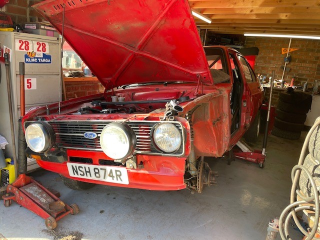

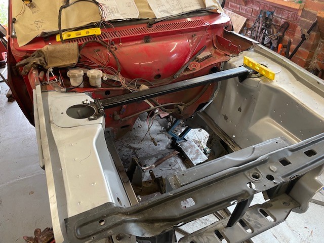

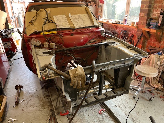

                            So after lots of faffing and messing around i managed to get the
                            passenger side chassis rail and inner wing sitting properly and tacked in before moving onto the drivers side.
                            this was much simpler as the bulkhead was straight and the inner wing and chassis rail needed little work to get them to fit.
                            this meant that i could fit the inner front panel and ensured everything could be lined up properly ready for final welding which i'm on with now.

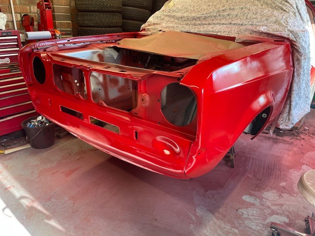

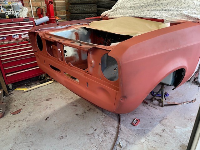

                                Its been a while since i last posted and i have been busy.
                                After the last little indiscretion i had a deadline of august to get the car complete. There was no way i was missing this event.

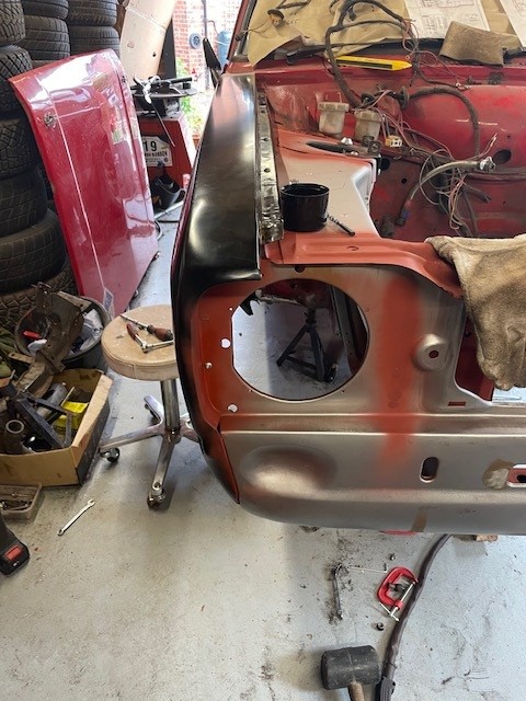

                                after quite a bit more fiddling i managed to get to this stage where the whole front was tacked in and lining up correctly.
                                i trial fitted the wings to make sure they lined up the drivers wing still needs a bit of work but it was close enough for now
                                Then i welded the front panel on fully and the slam panel
                                after that it was just a matter of chucking some primer at it
                                and then finally some paint
                                i think chucking is the best way to describe my painting skills!!

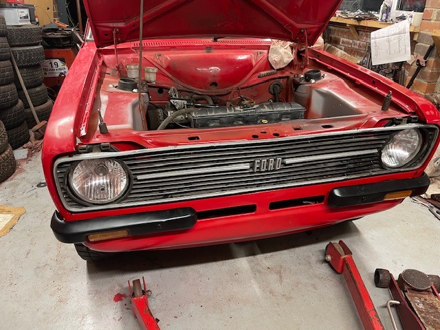

                                but after all this i could finally refit the engine box and suspension and give the old yoke a face again!!

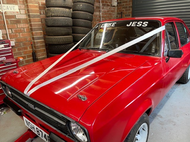

                                Now all of this was for a very important event and i was seriously worried i wouldnt make it. infact my Dad and i were still putting stickers on the car a 10pm the night before!!!
                                However it made it to my wedding and drove there without a hitch which was a result as i didnt even have chance to test drive it!
                                ANd here it is in all its glory with me and my best man (and Toby the dog)
                                And better still it even managed to get us back again!!
