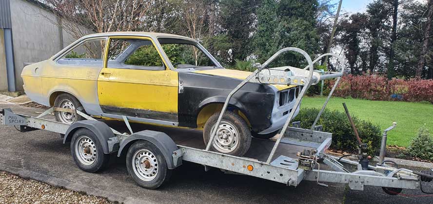

    This is the motor.... bought in Holland about 5 years ago and driven back to Ireland .

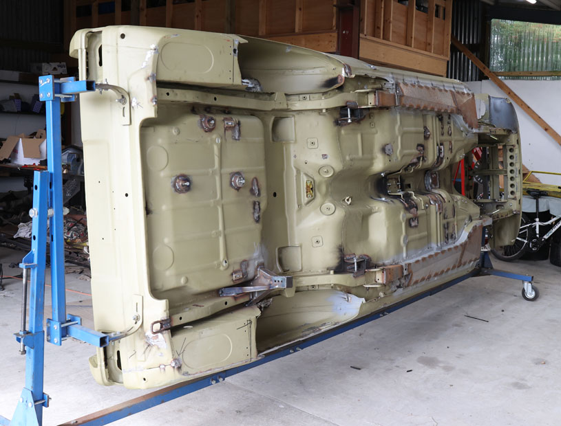

    Here's the dirty work starting...stripping the underseal .. I bought a roll over jig which made life much easier.

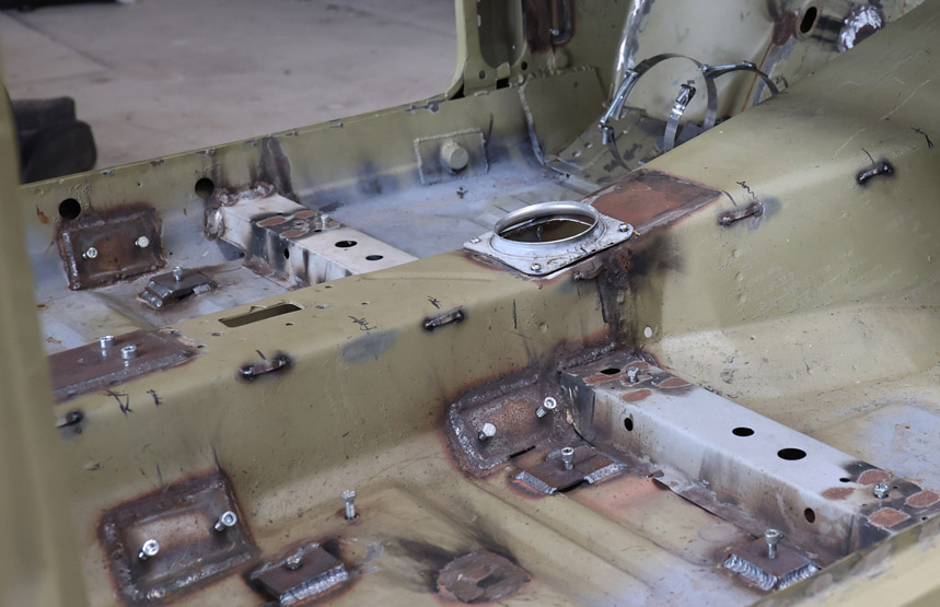

        The shell was blasted and the welding repairs and strengthening done. I didn't do the welding myself as a local expert was doing such a good job I would have only devalued the car. The shell was quite good to start with...it needed new sills, splash panels, both boot wells, some repairs to rear arches and a right hand drive dash. The car was seam welded, strengthened and skidded. ....then dry built.

            Here's the underneath showing panhard rod tower, skid plates, tramp brackets, turrets for exhaust, 2 new boot wells and lower rear panel trimmed/shaped.

              The Scheel seats (not Steele as I said in an earlier post) had to have their bases modified and plates welded to the floor. The plates on the side of the auto tunnel are for historic removable seat bars should I wish to install competition seats.
              The gearstick has been moved to accommodate type 9 5 speed/type E 4 speed gearboxes, the base for a hydraulic handbrake has been strengthened, the tabs on the tunnel are to hold the rear loom and brake line. The electric fire extinguisher bottle will be positioned behind a navigator's foot rest.

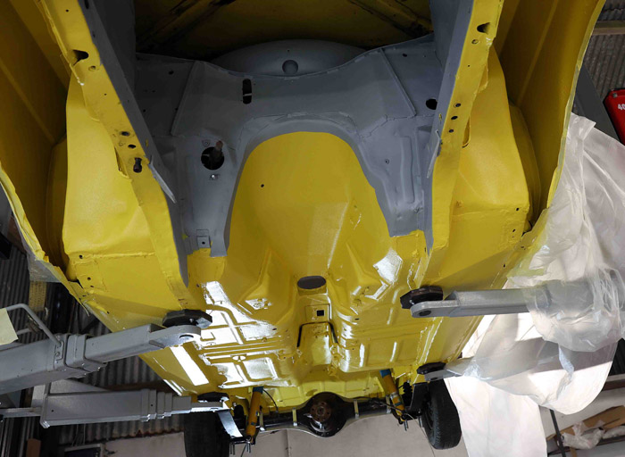

                      After blasting and epoxy priming the underneath was given a good coat of Mipa protector....its similar to Raptor I'm told.
