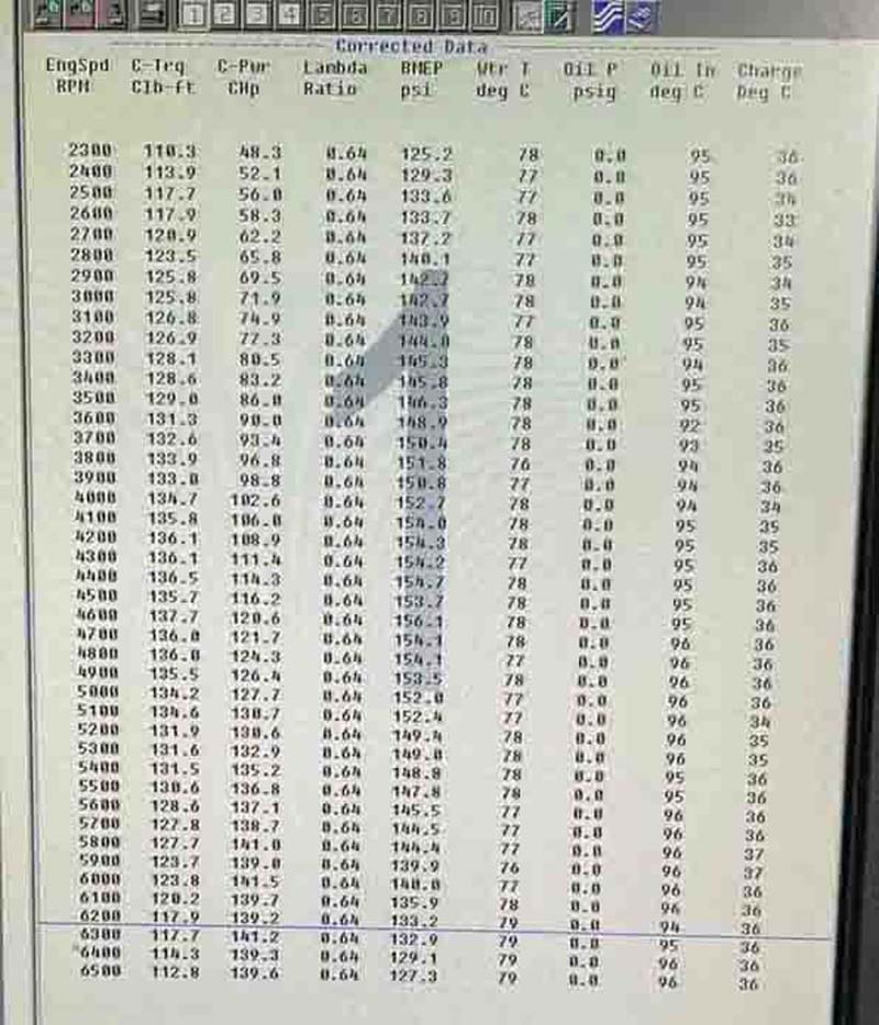

                Originally posted by alladdin
                are / have you had the engine dyno'd ? be interesting to see how an fr30 does with decent head / breathing.
                Yes ...engine built and dyne's by Vulcan
