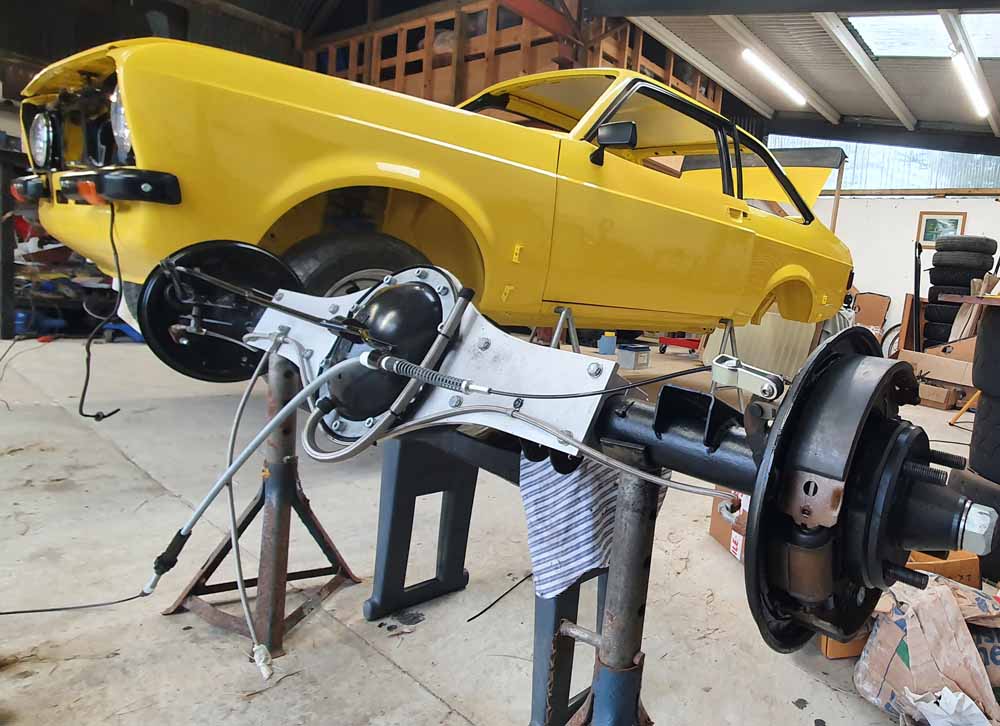

    Axle painted...drum brakes retained incase I decide to do historic events

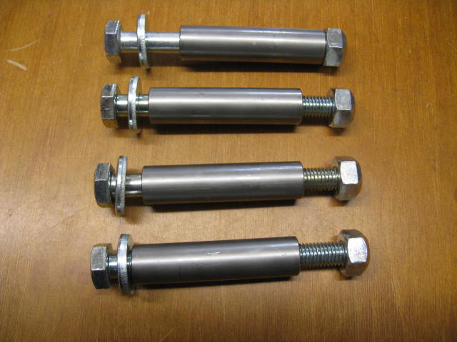

        W.r.t. the engine crossmember: I wouldn't elongate the holes.
        You could fit a crossmember chassis tube kit or (what I did) modify the engine mounts in such a way that the engine + gearbox fit the tunnel.

          Thanks Miniliteman....I have that chassis tube kit fitted . Good call about the engine brackets...I will do that

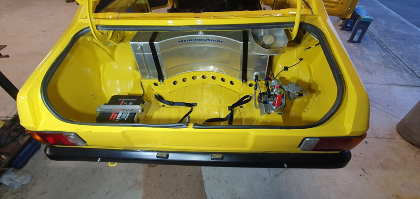

                Re: Road Rally Mk2 Escort No 5
                The boot is nearly there..just a couple of earth straps to bolt in

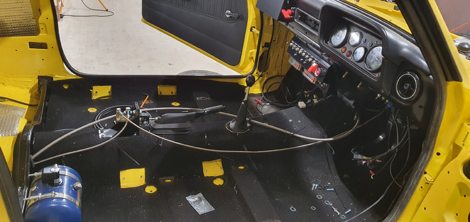

                    A photo here of the interior. I had to cut up the mint carpet and there will be a bit more cutting when I get the roll cage back from paint. I was at Group 4 Fabrications today in Galway returning the M16 callipers vented discs and spacer kit as they didn't fit. They are genuine Ford reconditioned calipers and for now there is a a lot of head scratching going on.

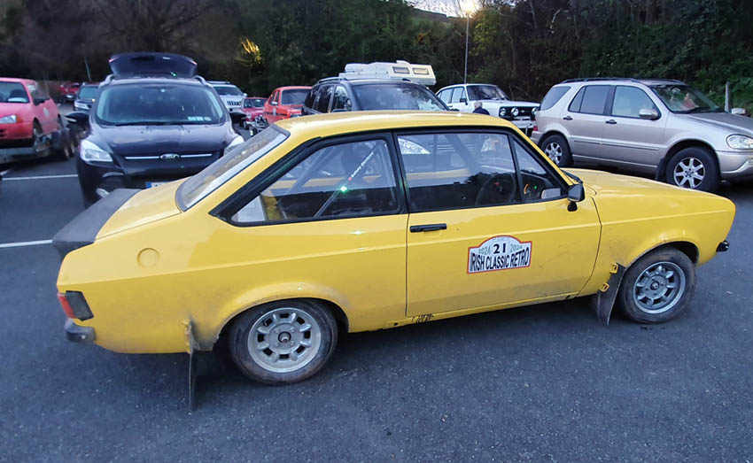

Name:	13.4.24 Escort finnished.jpg
                                Well the car is built and I entered it's first event on Saturday just gone.The TDC (Trial Drivers Club) Irish Classic Retrospective Trial 2024....here it is at the end of a long day driving 250km around the beautiful County of Wicklow and doing 15 special tests. The fact that the car made it round was the best takeaway from the day. The car build was only finished the night before and test driven for about 3 miles!
