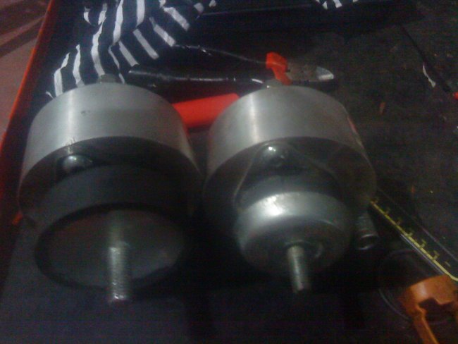

            Re: Racing sierra cosworth

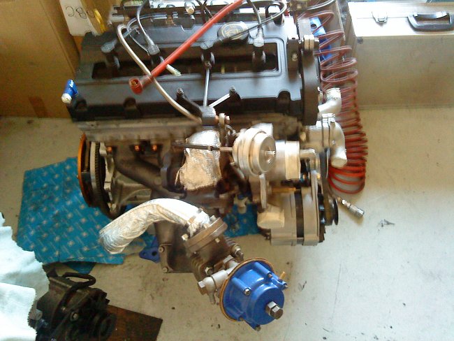

            Jeff i really dont know because i want to fix everything that was wrong in the red and orange period of the car.And this takes time....
            Thats what i have done with the engine mounts the left was broken,the rubber was cut in half, maybe from the crash,but now they are much stronger.And a photo of the trial fit of the external wastegate.

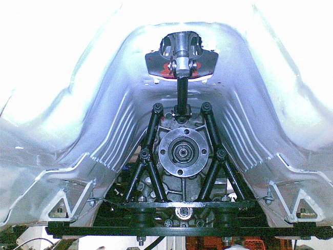

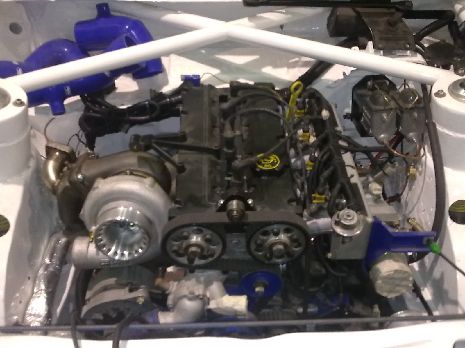

              The engine is in its placeand the new gearbox mount is in progress

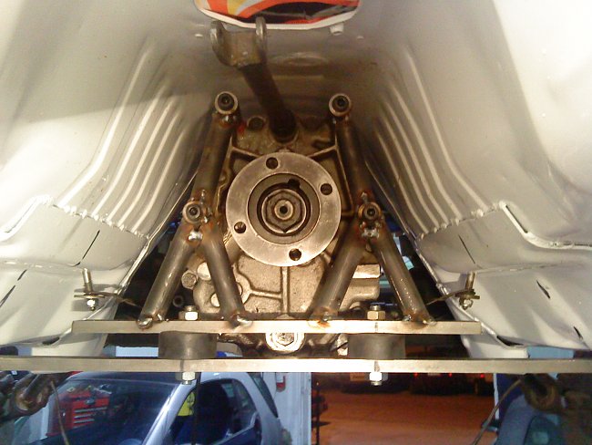

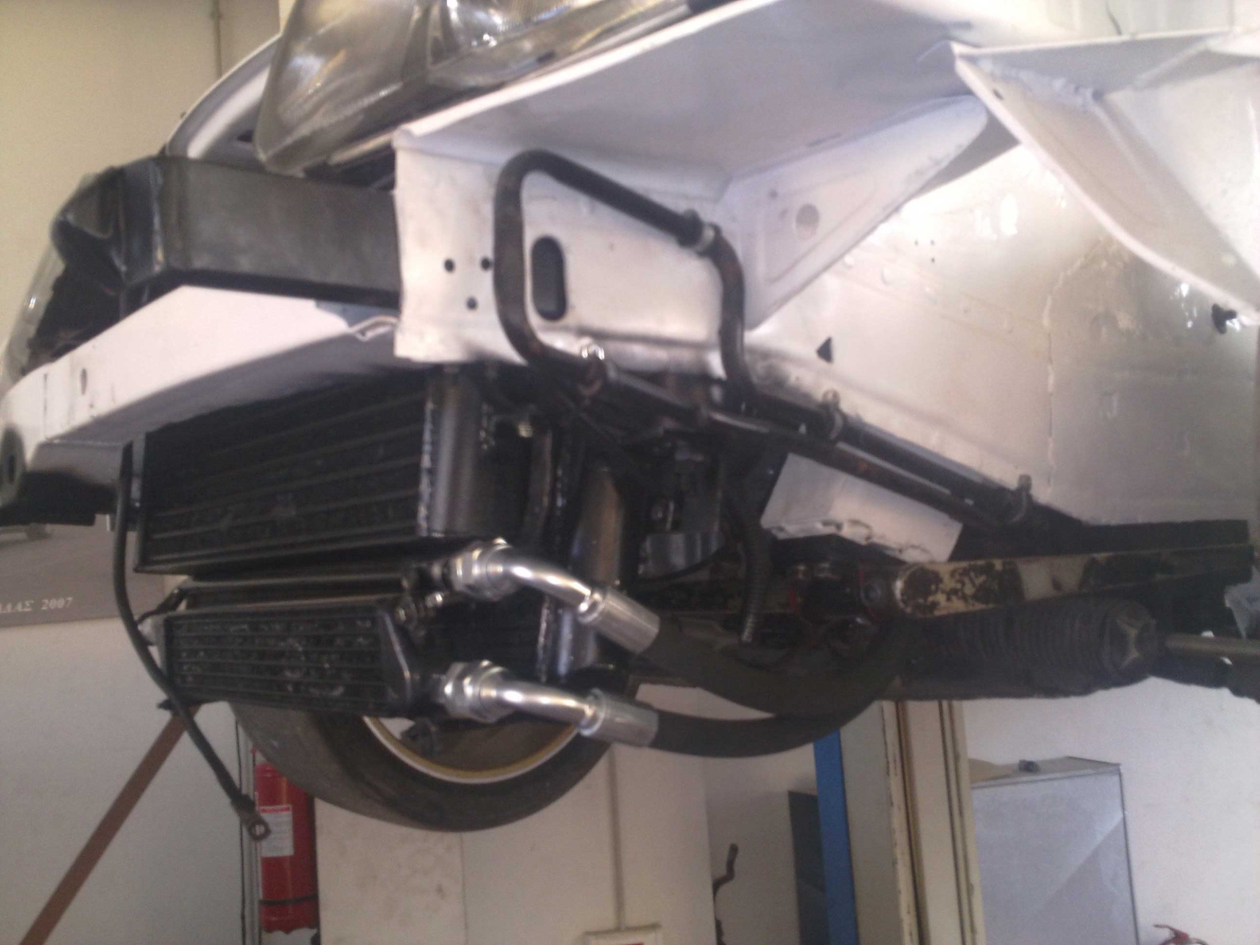

                        Gearbox mount ready!!!!!!!!!
                        N.Plessas

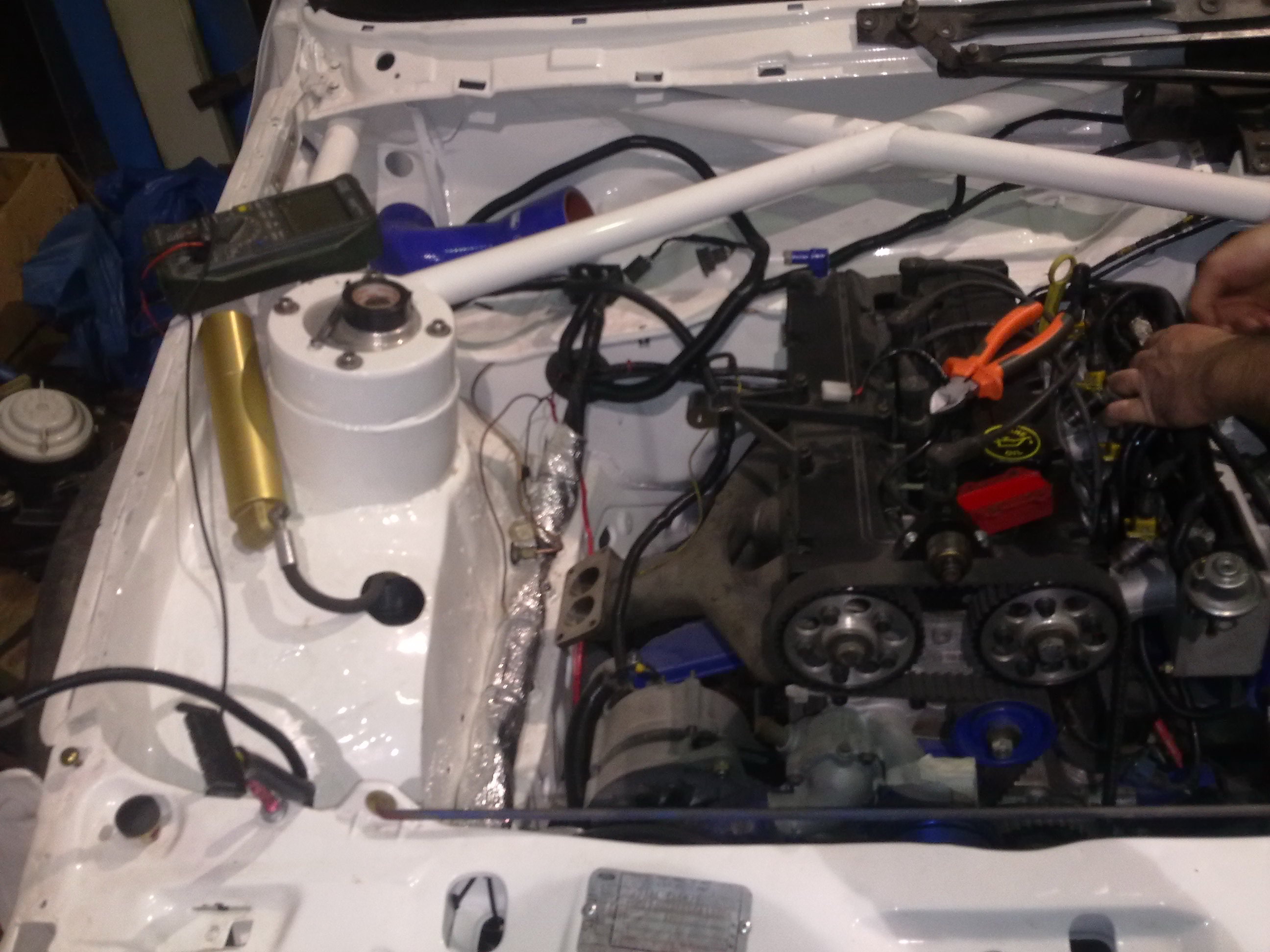

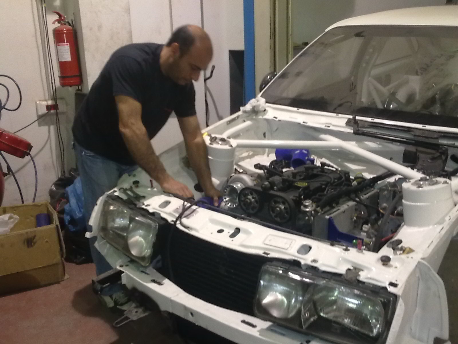

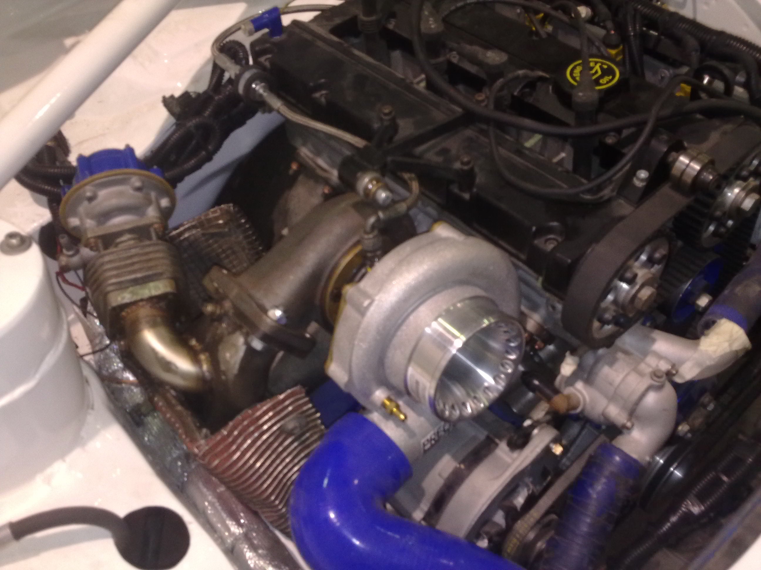

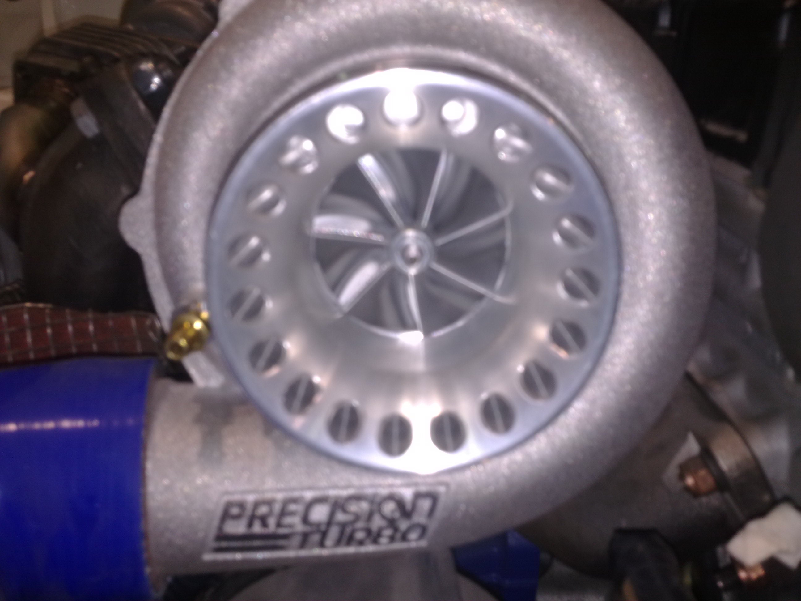

                              Hi Turbosport friends, progress of the cossie is slow but steady!!!!!!!!!!
                              check some recent photos of the new turbo trial install!
                                one more
