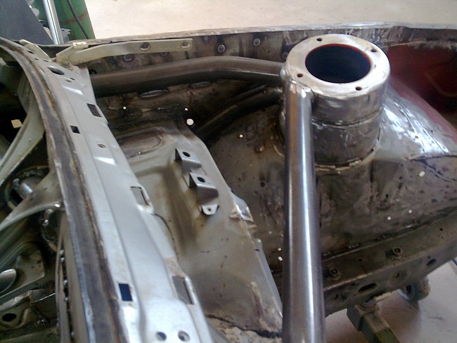

            Re: Racing sierra cosworth

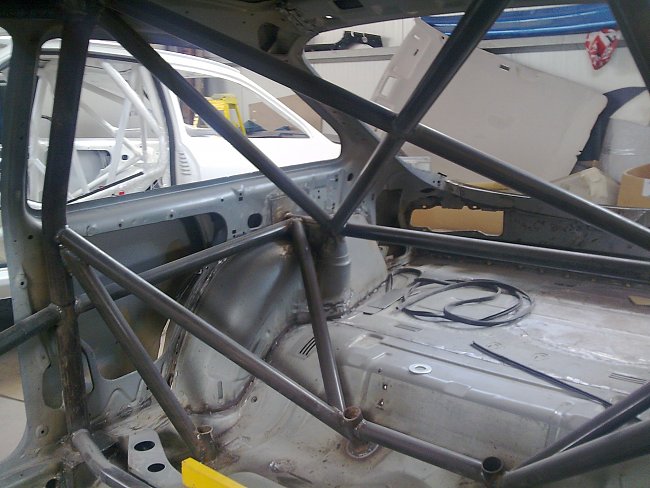

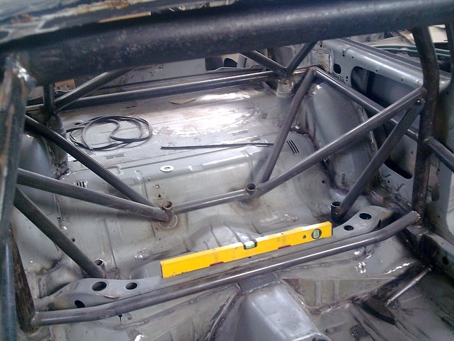

            Looking Good Nick, are you not taking the cage to the diff mounts?

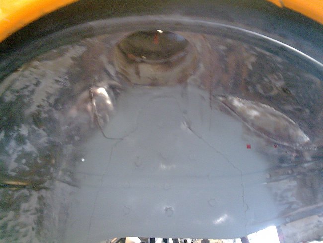

                  Paulwoodford the videos are from the 2008 Hellenic hillclimb championship,the scene is good but the road is very slipery!!!!!!!!
                  Retromotoorsport Jason Langam is a very good friend of Chris nickname Colin,who is the mechanic of a friend of mine who rallies a renault clio r3 maxi.
                  Timgr i dint find anything about the ascona someone told me that maybe is from thessaloniki.
                  As for the sierra the roll cage is almost ready and is a very good one i think.

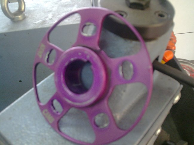

                    Hi to all!!!
                    I have started to rebuild the engine and found the inlet cam vernier pulley looking like this .Is this a common promblem with this part and i have to check it every now and then?Does anyone of you had ever the same promblem?I have them about four years.Any information about this will help!
                    Thanks

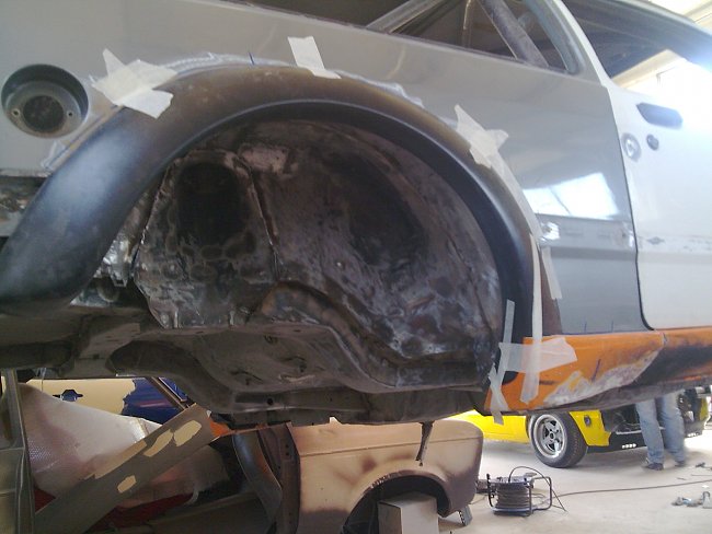

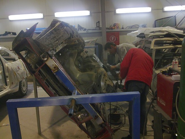

                          Some progress ...........

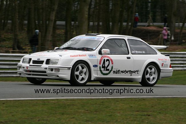

                              Great car Nick, very impressive indeed. As per the previous posts, what are the arches that you've used? This is my car, the arches are modified but not to the same degree
                              • jjw1974
                                • May 2009
                                • 4
                                Another pic from Thruxton this year
