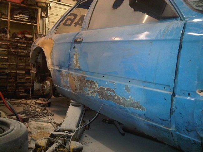

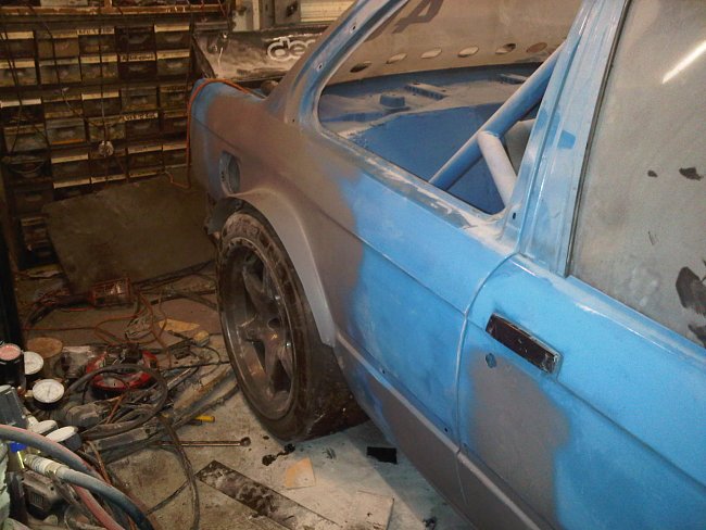

                              the new rear arch is a simple metal spat, like you find on minis only bigger, just above the arch and swage line you can see a large crease in the wing, unfortunately it wont come out without putting the car on a jig, as it has a bent chassis rail, fortunately the bend in the chassis rail, doesnt have any effect on the shells geometry

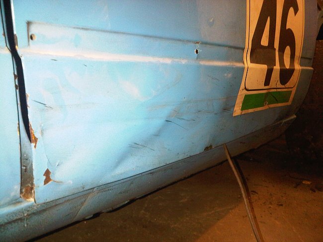

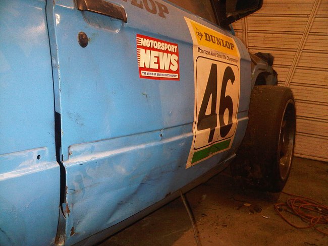

                              the doors pretty distressed too, and i had already kicked the worst out!

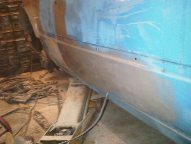

                              with a bit of beating the doors in better shape, it would take a hell of a lot of filler to make it properly straight even them because its stretched it wont come perfect, so i'll leave as is, although i might stone chip the bottom of the car so the ripples arnt so obvious

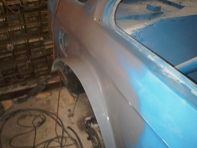

                              with some work from the gass axe, hammer and filler the rear wing looks a similar shape to the light
