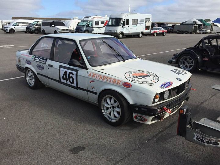

    Ive just done my first race meeting of the year a 40 min pitstop race at Thruxton. its a circuit i have very little experience, i did two 15 min races about 15 years ago, and in 2019 with the car in its current format, 2019 was a bit of a disaster though, the car wouldn't run properly, then lost 80% of throttle towards the end of the race as well as throwing up several times whilst at the wheel.
    pre meeting prep consisted of brake fluid change and new pads all round (DS3000) the rears were not worn but i wanted to put the same material in both ends, it did have standard road pads in the rear the hope being a little less rear brake from cold and a little more hot. I also stocked up on travel sick pills having now worked out which brand to take and how many/when for them to be effective, i also pulled a fraction of caster and camber out the front end
    Qualifying went reasonably ok, with only the most basic memory of which direction the track went i really needed to find someone to tow me round, but every other car i came across was slower on the straights and faster in the corners of vice versa. so i gave up and just tried to figure it out on my own. A couple of places i got dash alarms, making me think i had oil surge, much later on i somewhat embarrassingly realized i had forgotten the colour my dash oil warning, its yellow not red! which meant i backed off when there was no need, not to mention pulling earlier than i could of done. Qualifying done I chucked an extra litre of oil in the engine and looked up my grid position. i was to start the race 18th out of 30 and 5th in class so not great but not terrible my qualifying lap being a massive 6 seconds faster than my last outing a the circuit.
    it was a standing start race and i didnt make a good one, ive not done many of them as the car stands now, i used slightly too few revs initially then too much throttle and lit the rears up dropping a couple of spots in the process. race itself was good and clean, i figured out better where i was going and in the second half shaved another two seconds off my qualifying pace. and i worked my way upto 8th overall and 3rd in class, which was ok, except that i left the pits 0.34 sec to early and was hit with a 30 sec time penalty, that dropped me to 4th in class and 9th overall. to be honest i fairly happy with my finishing position, 1st bmw home ( there were several e30s in the race) 1st proper saloon car home, the 2 cars in my class which finished ahead of me ( on the road) were 3.0 Porsche 944's, with there low profile and ideal weight distribution from the rear transaxles those things handle like they are on rails, getting an E30 even close is an achievement. the car behaved well during the race, despite the modified sump and extra oil i did get real oil surge a couple of times in the second half of the race, each time through i was seriously sideways either in the chicane or a tight right, left, right and was out the throttle so i hope the engine didnt suffer. Handling wise it was really good, unless i was really aggressive with the throttle in the slow bits the rear end was planted with tenancy and gently understeered in the fast corners.
    video of the first half of the race below, some idiot (me) forgot to erase old races from the SD card so i didnt get all the second half of the race!

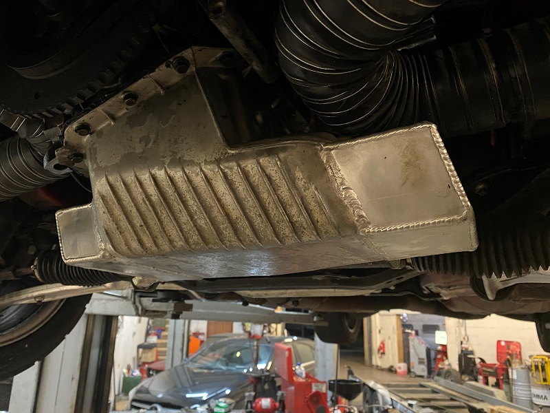

    i forgot to take pictures of the sump or scraper plate before they went back on the car, here it is, give or take a bit, its 1.5 litre more capacity, so hopefully that and the scraper will keep the oil under control.

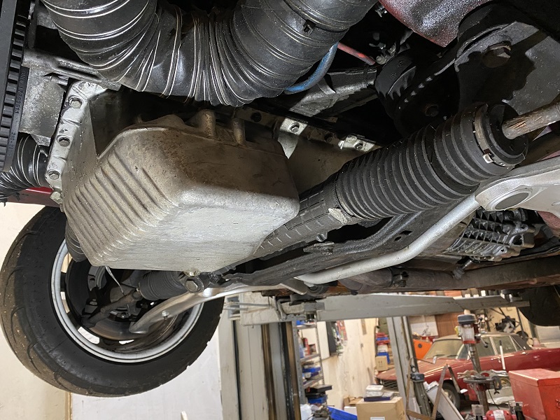

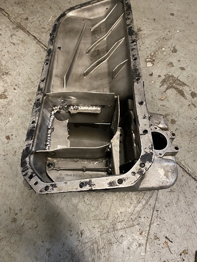

    next i need to do something about the oil surge, i did look into an accusump, but dont want the weight/complication or the considerable cost of fitting one so going to tweek the sump and fit a crank scraper.
    the sump works really well, unless you turn right, that is. the main problem is the angle of the right side of block and sump, it just sends the oil straight up the side of the block, location and shape of the oil pump and pickup prevent you having an effective horizontal baffle. i also think the existing baffling is reducing oil flow back to where its needed just at the wrong time. if i fit a crank scraper its should help keep the oil in the by scraping it off the crank, and helping stop it climbing up the block sump. im not sure it will help surge going right but it makes sense to add a kick out to the right side of the sump to increase its capacity i will also extend the existing sump wing, my thinking being if its got more oil in it theres a greater chance of it keeping the pickup covered

    due to the effects of covid last month i had my one and only competitive outing of the year.
    theoretically the car was ready as i did have a test day and race booked at the beginning of the year. so my pre race prep consisted of charging batteries, blowing up the tyres, which was a bit of a problem because i couldnt remember what pressures to use! i used to have a brilliant memory and never had to write anything down, but it seems its not what it used to be! anyway after guessing pressures i put some fuel in it and gave it a blat round the industrial estate to check it still worked and chucked it on the trailer, and headed to Donington park. My one and only previous race at Donington was the last race i did at the tail end of last year in total monsoon conditions, so i arrived this time with only the most basic idea of the track layout.
    i had entered the CSCC future classics 40 min race, it has quite a varied grid, consiting of several e30s a stack of Porche 944s several 911's couple of skylines, usually a few V8 powered cars, its generally a full grid, my E30 is way down on power compared to quite a few so running anywhere in the top half of the field is good., it was almost a year since i had driven the car and i was back at a circuit i didnt know, most of the guys had raced earlier in the year, and a lot tested the day before so i wasnt that hopefull of a good result.
    For qualifying i arrived at the collection area fairly early and lined up behind a collection of 911's, they had obviously made an effort to line up at the front to get some clear track, i figured my only real hope of getting a good grid position was to get a tow, trouble was i was sure the 911's would take off too fast for me to live with on a strange track and in a car running different geometry from when i last raced. As predicted the 911's took off too fast for me, and intially so did a Bmw E21, but i did manage to slightly distantly hang on to it, that E21 has a later E30 325 engine, it doesnt have anything like the straight-line grunt i have, but its pilots absolutely drive the wheels off it through the corners, it always looks like its about to crash but never does. once i got a measure of just how fast craner curves actually are i got on the tail of the E21, followed it for a couple of laps then over took it as i found it was holding me up.
    one thing that was a little alarming was an alarm literally, the right hand kink at craner was giving oil pressure warnings whilst i didnt brake there i was out of the throttle so i chose to ignore it. At a couple of points on circuit the car was a bit understeery but the rear was absolutely planted so the rear beam mods i made last winter were defiantly working. near the end of the half hour qualifying session i did a practice pit stop ( race has mandatory pit stop) i dont normally practise the stop during the qualify session, but the format was changed due to covid, instead of having to get out the car and back in quick as possible, it was now a minimum of two minute time in the pit lane without having to get out the car. I exited the pits but only did another lap or two as i was feeling car sick, making a mental noet to take more travel sick pills before the race.
    checking the quali times on TSL i was 16th out of 39, just one slot behind Paul Dolans E30 which is the one id had a great dice against round Anglesey last year. i was well chuffed with that. just to show the difference between a track conditions compared to last years monsoon i was lapping 20 seconds a lap faster
