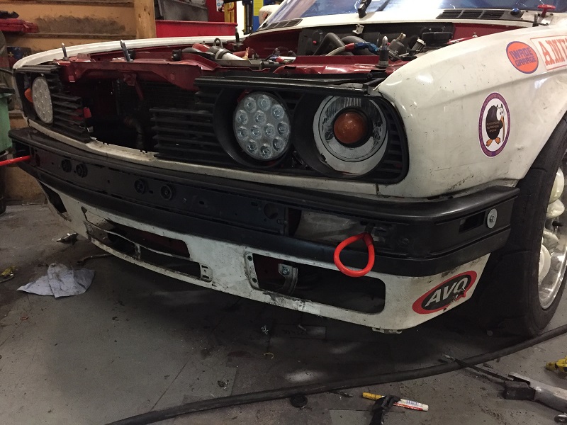

    i could of easily bought a new one but in the end opted not to, instead fit an OE bumper skin its lighter, cheaper wont shatter if knocked and easy to attach with a few bolts, and will probably stay attached if knocked. in circuit racing you want panels reasonably well attached, bodywork hanging off is likely to get you black flagged and ruin your race.

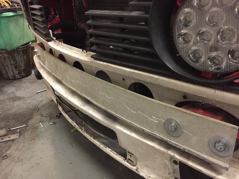

    as the bumper skin is lighter than the old spoiler and ive saved a bit of weight doing away with its mounts i gave thought to giving the center section a bit of reinforcement, partly to help it stay attached and partly a bit more protection for the rad and oil cooler.
    i also used the opportunity to upgrade the webbing front towing strap to a pair of wire straps, although the old strap seemed plenty strong enough, it wasnt really blue book compliant. Finally i got the corner weight scales out again, all the recent work has paid off, the cars down another 10kg to 918kg, heavy by escort standards, but not bad given an iron blocked straight six up front, best bit is the nose of the car is actually 20kg lighter, so we are back to 55/45 weight distribution with a near empty tank and me on board. i really need to put myself on a diet now, as i now make up 10% of the cars all up weight!

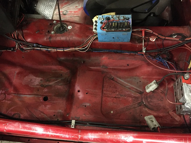

    a hidden benefit of moving the extinguisher, battery, wiring etc is the inside of the car looks tidier, looking tidy does not give a performance advantage, but i know as a scrut myself if a car looks tidy i dont look as hard for stuff wrong! just need to clean the floor now!

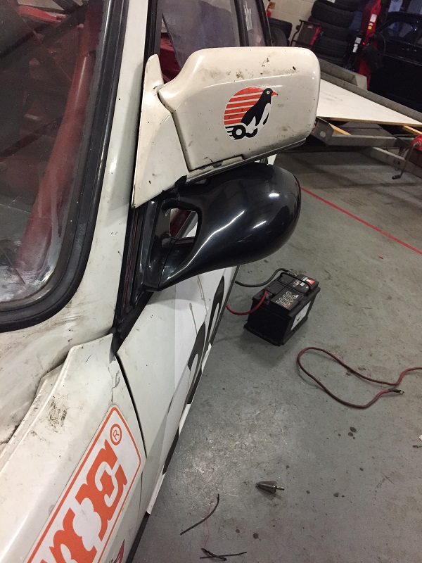

    when i bought the car it had short stubby dtm look mirrors, which i replaced with standard E30 ones, the reason being one was damaged and reward visibility was rubbish, having not raced for a long while i was more concerned with rearward visibility than go faster mirrors. last year experimenting with ducting air into the cabin i was stunned as to how much air pressure built up just under the mirrors, so i have bought some cheap extended dtm type mirrors, i should still have decent rearward visibility and they are certainly a lot more slippery shape, half the weight of the OE ones too.

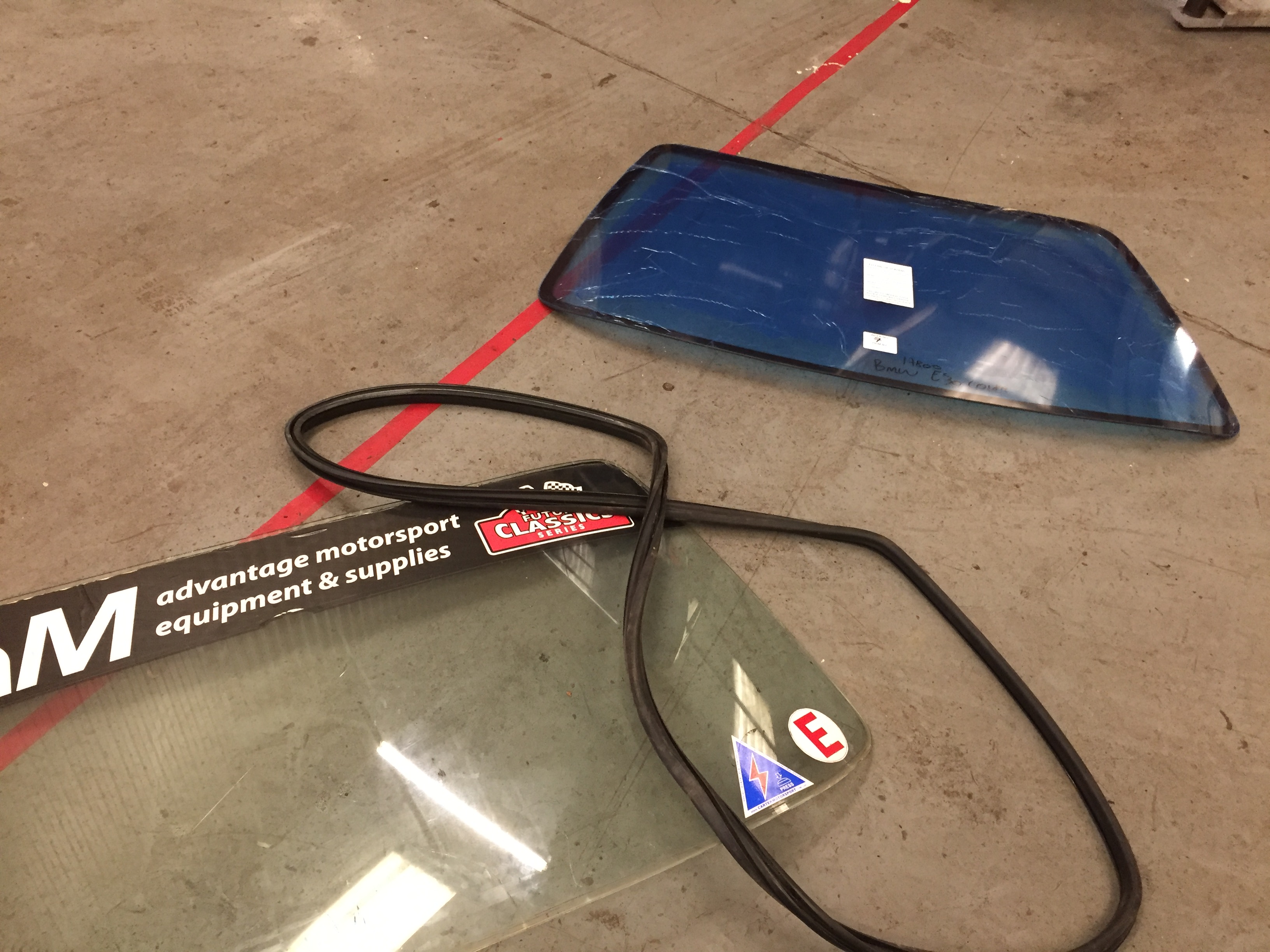

    lastly for the moment ive bought a new screen, a preformed polycarbonate one, its half the weight of the glass one, plus i dont need the screen rubber which saves another 2kg weight. it cost a small fortune, but if it out lasts 4 glass screens it will of paid for itself. i used to use poly screens before, i used to cut them out myself, but being cut from a flat sheet they never fitted great and had to be screwed in, which probably didnt help with wet weather condensation problems i used to have.

    the latest effort, ive moved the both battery and fire extinguisher back about two foot each
