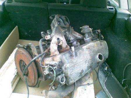

                    it could be this is the base for my new engine, a very manky looking carb'd 90bhp 1800 lump from a e28 518, that i scraped 10+ years ago and put in the stores where i used to work, much to my suprise it was still there and they gave it to me just to get rid of it.
                    i only really wanted the head, this version has small ports so i can try to some new port shapes out on the flowbench, you never know, the rods are interchangable with the 2.0 unit so they might come in handy as i've almost run out of good 2.0 rods and the bottom end or crank might come in handy as an exchange unit, if you by a new crank from bmw they dont seem to care what you give them back, i once gave them a knackered peugoet 205 crank as an exchange for a new m3 crank!!!!!!!!!!!
