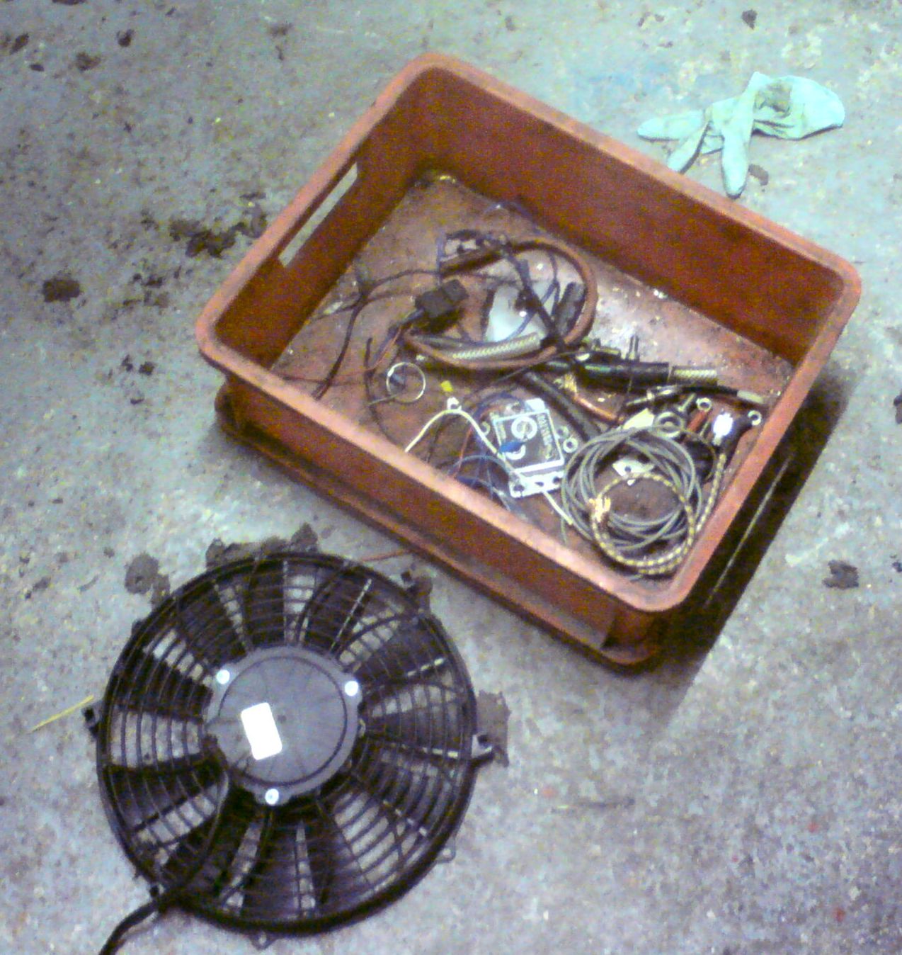

                            im in weight saving mode now,

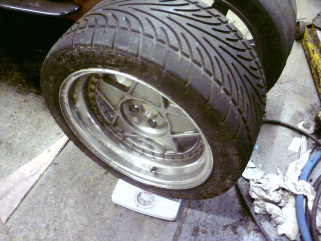

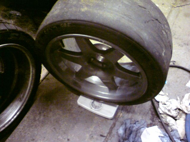

                            i statred by comparing one of my slick shod 10x8 against a wet shod 9.5x17 split rim, when i bought the 18's compomotive did tell me that with thay design i wouldnt save much by going to split rims, they werent wrong, the difference between the two was just under 2kgs, so i wont be slashing out cash on more wheels any time soon, £2k to save 8kgs really isnt worth it
                            next i started to think about what i could unbolt, first to go was the electric fan with its wiring and some other gubbins, even in sundays heat at brands the engine ran cool desipite being gridded up twice and the hanging around after the red flag, it would save more weight to keep the fan and fit a smaller rad which would also hold less water but this way is free

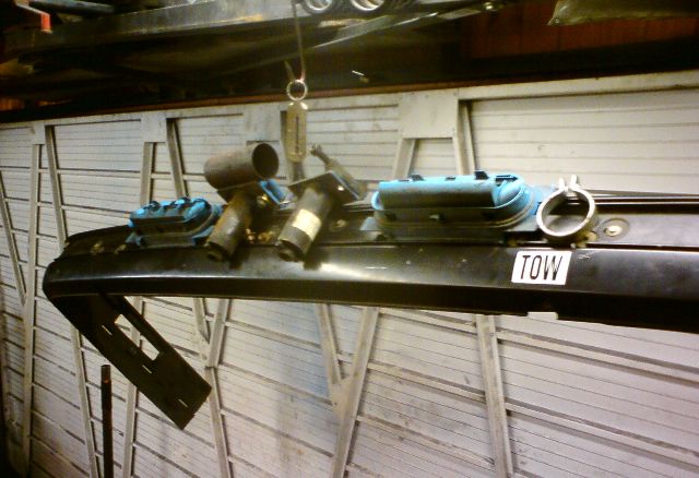

                            finally for now the rear bumpers off, i prefer the car with it and its had a good few "taps" over the years without me suffering any damage, but if im ever going to get near the fwd cars a bumper is a luxary that i cant afford to carry round, i also trimmed a bit off the end of the exhaust as it stuck out rather too far without a bumper
                            the cars weight should now be down to 919kg so i've still got a long way to go
