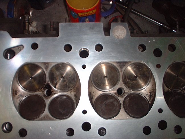

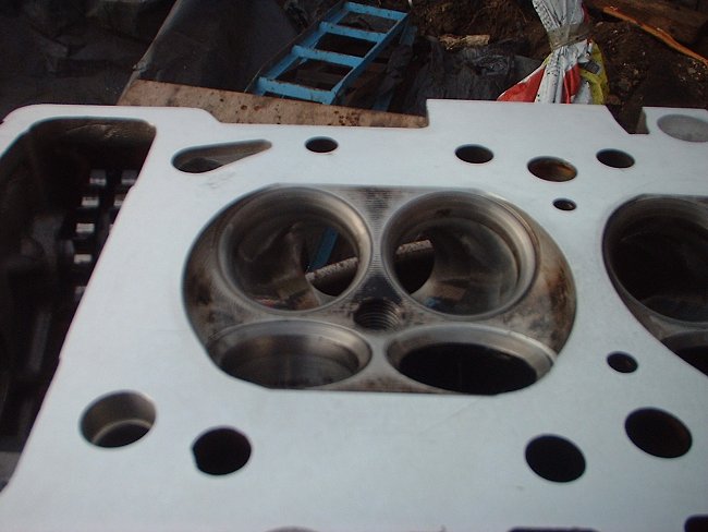

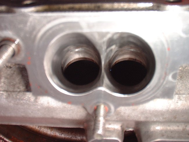

                  got a bit of time on my car today, i lapped the valves in, then stood back and admired just how good the the m3 head is, lovely straight inlet ports with a nice steep approach and huge exhaust ports, which probably accounts for why my engine makes excellent power on very little boost, so heres a couple of head pics

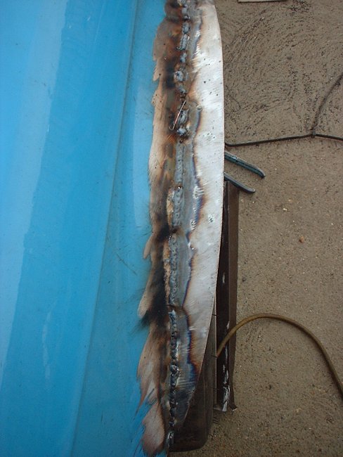

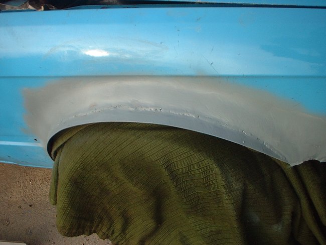

                    i pondered what to do with the front wings which wont cover the 17x9 wheels, i thought of fitting M3 wings, but they are expensive and still might not cover the wheels anyway, fibreglass replicas are a lot cheaper, but still might not fit, and dont save much weight anyway, and came up with allsorts of clever ideas on making box arches but then settled on the cheap easy option, a simple steel extension on the existing wings,
                    after trimming a bit off the arches i welded on some steel strips, and zinc primed them, the extensions are wider than they need be, because i might convert the front wheels to the same wider spec of the rears by changing the outer rim sections.
                    its not the prettest welding, the welder was having a bad day, not helped by it being a bit windy and rather blowing the gas away which i was getting low on anyway, but as its non structual will do fine

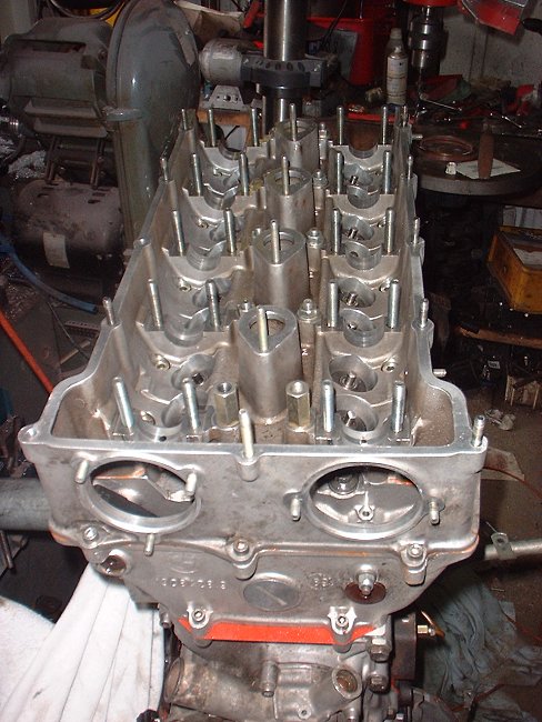

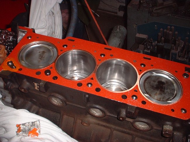

                          i've installed the valves, rechecked the valve clearances, and fitted the head using the ferriday gasket, the fire rings are one big single piece of copper, inset into an aluminium gasket that comes precoated with a silicon type sealant.
                            • 25214

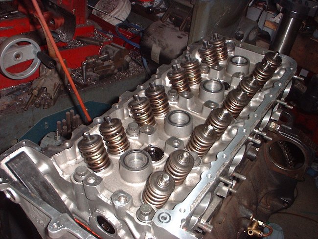

                            finally for today i fitted the cam carrier which is no 2 min job, having several o rings between it and the head and is held down almost 40 bolts!
