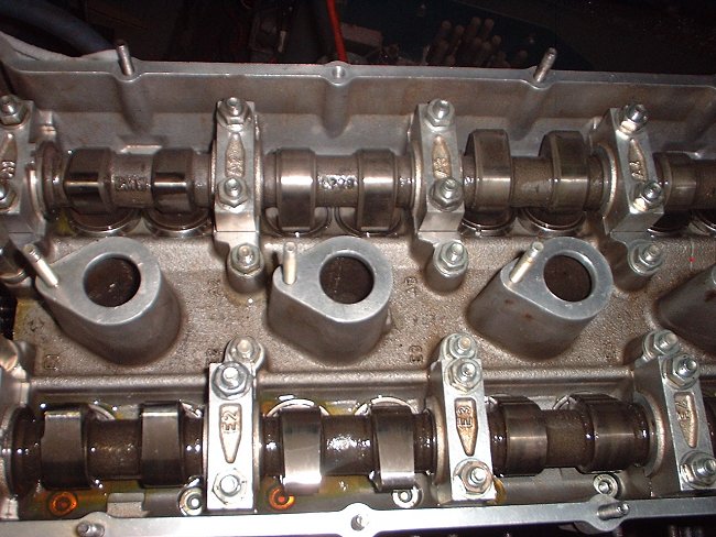

    just a quicky, only a little progress this morning as i start work soon, i put lifters and cams in, cams caused a bit of head scratching as it was early in the day and i'm using two inlet cams! which means std marks etc dont line up, got there though.

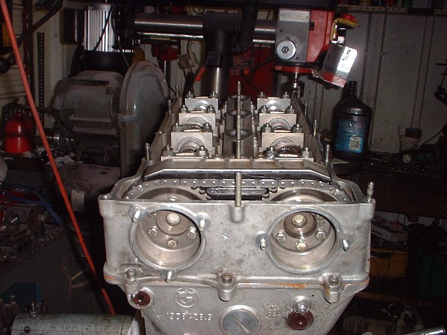

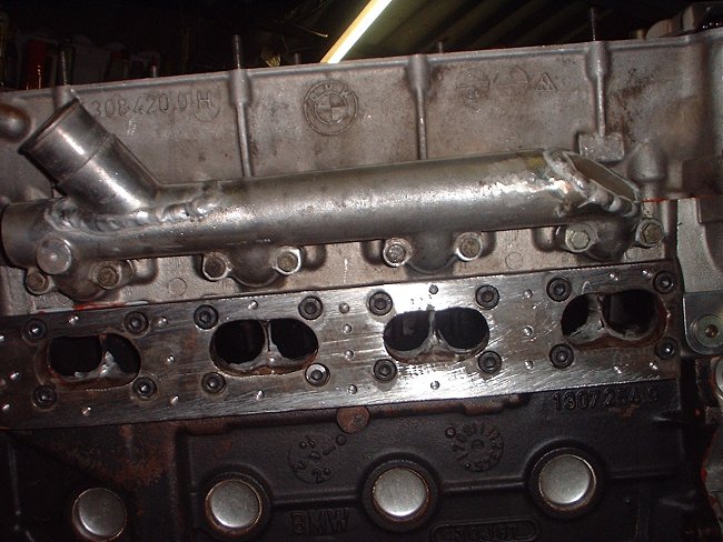

      yesterdays progress,
      drilled and tapped the timing chain tensioner body to take an adjustable stop, the idea being teh chain is still tensioned hydralically as std, but the tension cannot back off on over run or when the engines left standing.

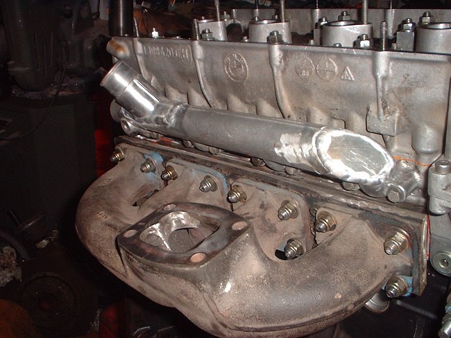

      pic shows first yb ex manifold adapter plate on engine and modified water rail

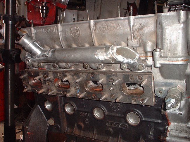

        • 25214
        second adapter plate, i just hope i have a gas tight seal between them, theres no gasket just some ultra high temp silicon as used on boilers and lots of bolts!

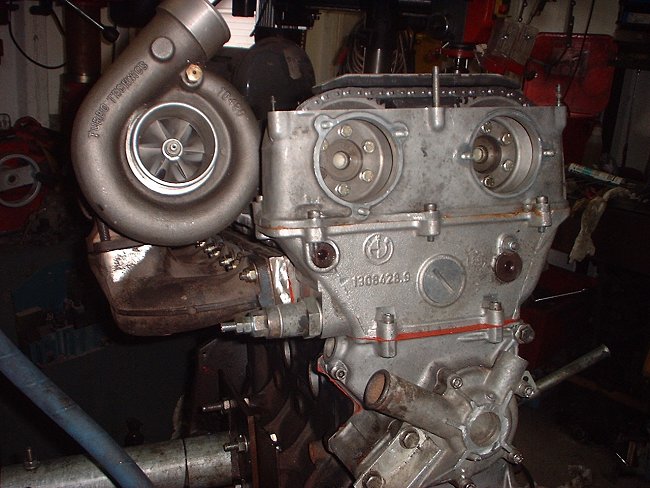

          yb manifold now fitted, and lastly turbo sitting on the manifold

            I have entered your pic in the "Weld of the week" thread.

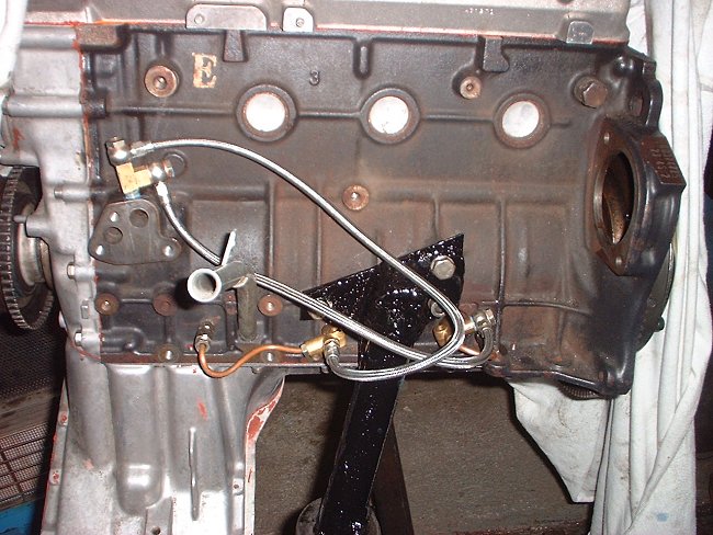

                              not much progress today got to go to work soon,
                              i bolted the n/s engine mount on after reinforcing it as it cracked several times last year, if i had realised i was in welding competition i would of taken a pic of it before painting it
                              and refitted the oil lines that feed the piston cooling jets
