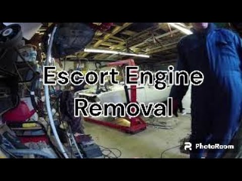

                      Removed the engine and gearbox on the Mk2 today. I used the GoPro in timelapse mode to capture the work.
                      The new gearbox has a shorter ratio 1st and 2nd and is brand new, so we'll soon see if its easier to get up the grassy slopes in a few weeks. It was built for a Dellow, but the owner long since sold the car. My Dad trials the Escort and is suffering from too taller gearing on some of the slippier stuff.
                      We had to remove the cross member and steering rack in order to lower the engine and box to the ground. Was quite an experience, working on such an old girl. They're rather agricultural when you get close enough with a set of spanners.
                      The engine we discovered, had a weeping core plug on the flywheel end of the engine, so we'll remove the flywheel and fit a new one.
                      Hoping to get it all back in next week over the course of a few evenings.

                        Dropping the engine and gearbox back in to the Escort again tonight. Dad's had fun and games sourcing the right sized core plug for the block, but QED came to the rescue. Its now got a new sump gasket too, as the original builder had two paper gaskets back to back, and it leaked at the front of the block. Hoping with the cork gasket set that it wont leak any more. Or at least not as much as before. It is a X-flow after all.
                          Burtons do a decent sump gasket for xflows that doesnt spread like the cork ones

                            Grahamb - Hi, I've just got a gopro and I'm hoping to do a few of these time lapse vids, did you have to use any software to string it all together and make it a movie? Also what time interval setting did you use to take photos?
                            Thanks
                            Lewis

                                Doughman, if you use the Cineform studio software free from GoPro it does a more than adequate job. I tried other packages, but Cineform was by far the best tool.
                                You can specify the target film size (I chose 1080p) and the frames per second during play back. I recorded at 30s intervals, at the highest resolution.
