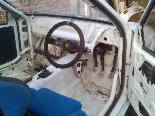

    After a deep clean and a couple of weeks of stripping all of the remaining trim, pas, abs, glass, rear wiper, loom, heater, etc, etc.. its now time to start planning to rebuild it all, to a higher standard and with a lot less weight

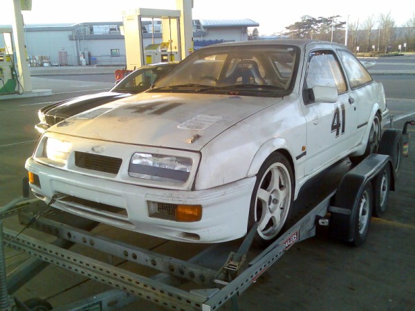

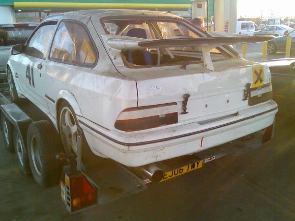

    When i got it and we hosed it all off it looked like this:

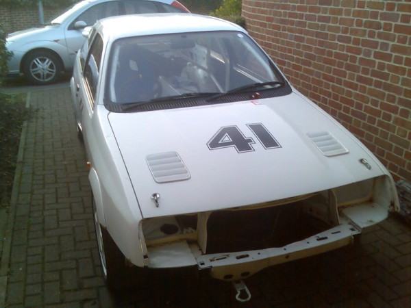

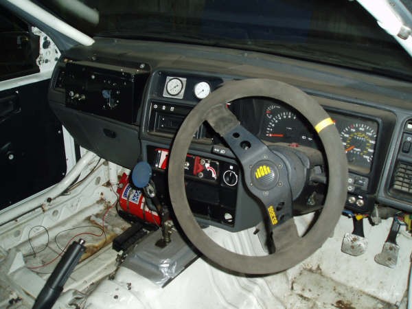

    This is how it looked after a bit of strippage

        Did a bit more last weekend, stripped out all braking system except rear discs and the aeroquip lines that are there. Took out handbrake, pedal box, abs, servo, hard lines etc.
        All the brakes need are a big front brake kit and fitment of the hydraulic bias pedal box I've located.

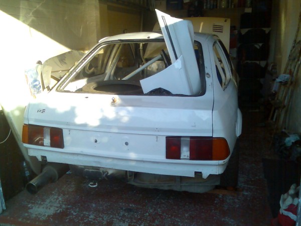

        Bumpers are off, rear one needs inner lightening and a new front is on its way. I also found the rear hatch to be knackered where something heavy had dropped onto the whaletail and roof (hence smashed rear screen I guess), lowering it an inch into the boot. I didn't notice this until I tried to fit the RS500 lower spoiler and could get my hands under the middle of it
        An XR4i hatch is on the way with a bit of luck.

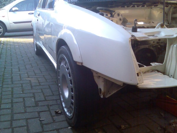

        Also tried one of the OZ rims that came with it
        Next step is to remove all PAS pipes and pump, and somehow get the exhaust down pipe off of the system
