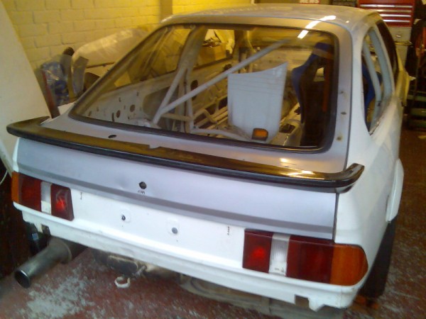

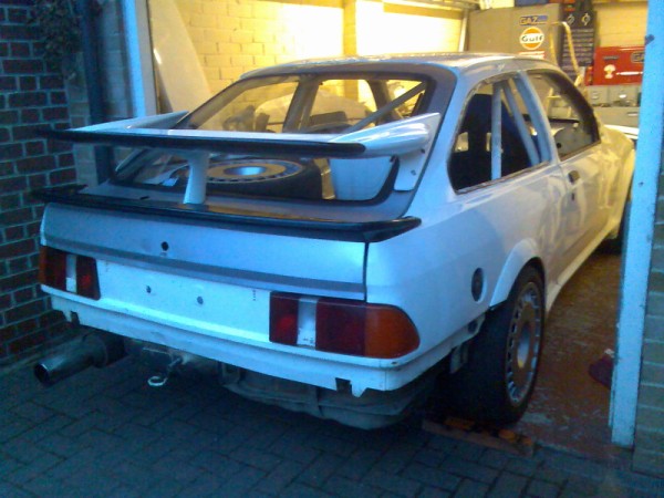

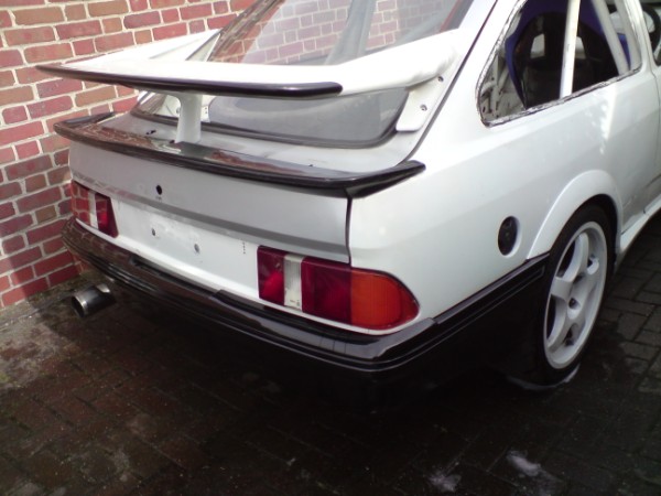

        Grabbed a couple of hours today to trial fit my ebay special XR4i bootlid along with the proper cossie whaletail and the fibreglass RS500 lower spoiler that wouldn't fit the old, bent, hatch.

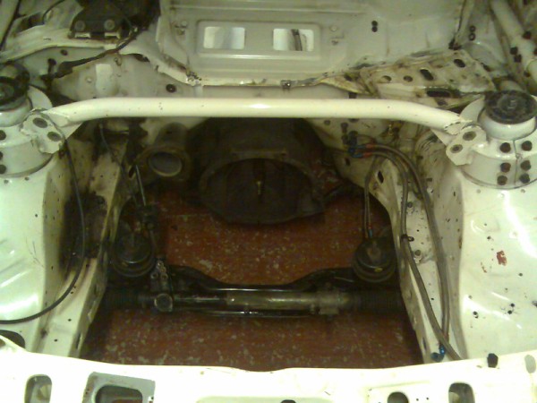

        Also finished stripping off all the power steering, just need to separate the YB downpipe, swap bellhousings and it will be time to trial fit the engine

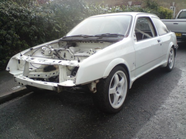

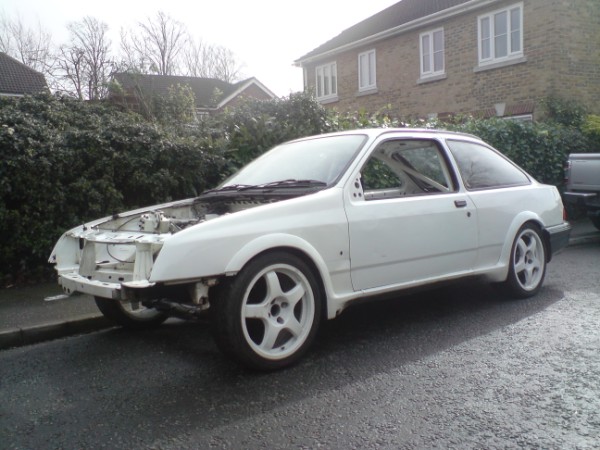

                    Couldn't do too much this weekend but got my new bumper bolted on, also removed turbo downpipe ready for the engine to go in, which will be very soon.

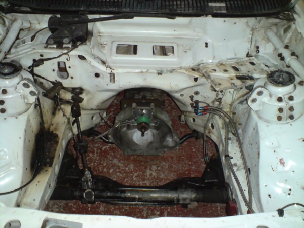

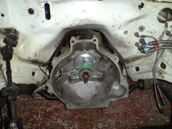

                      Got the old bellhousing off today and fitted the V6 one along with its adapter plate and hydraulic concentric kit.
                      Should have been an easy job except that they'd fitted tx55 torx bolts (not enough access for the tools) to the cossie bellhousing and threadlocked them to buggery. No torx tool would fit nicely in the space and unfortunately one perished in the process Never known ANY bolts so stupidly tight, but eventually got them off

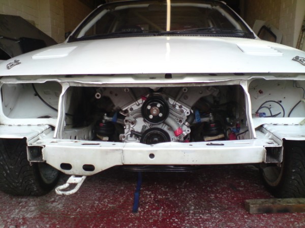

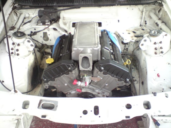

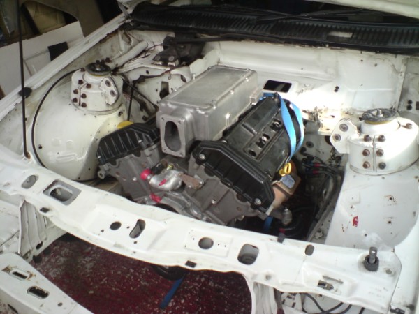

                        Myself and the Pipes spent a couple of hours lifting the engine into the sierra this morning, although not without a couple of problems.
                        The bolts in the sump girdle were fouling on the rack so it looks like we might have to modify the way its mounted slightly, hence the wooden blocks spacing the mounts up in the last pic. I did pick up some lovely vibra technics competition mounts though from Burtons which will help greatly and make the engine nice and stable too
                        The other thing is that the plenum is touching the bonnet but hopefully we have a solution for this too without making the bonnet look silly
