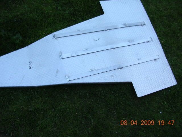

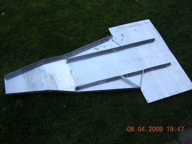

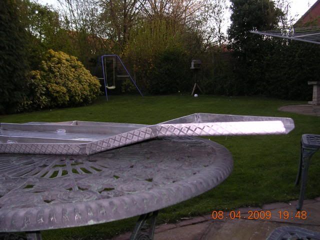

                              Small update. Here is the sumpguard which I have just knocked up. It fits across the whole engine bay and then tapers towards the back and is folded up to follow the contour of the gearbox. It fits up to a subframe bolted up to the gearbox mountings at the back...to remove it you undoe two bolts and then it slides out....so the sumguard can be removed in about 30 seconds.....but due to the subframe we can jack the back of the car on it.

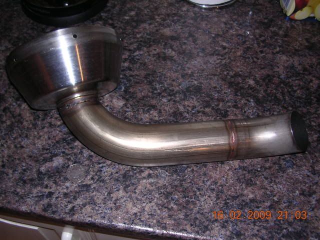

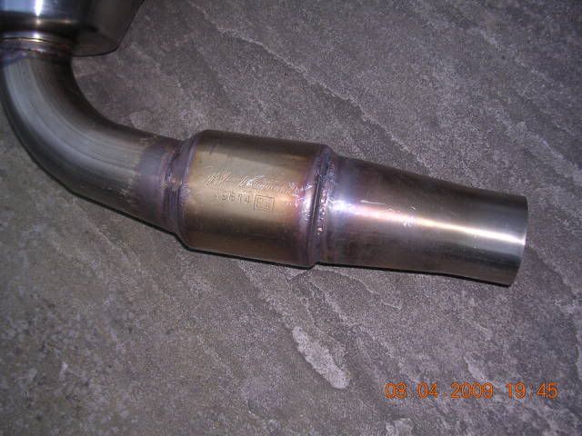

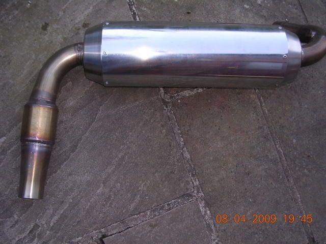

                                We have to have a catalytic convertor fitted to the car to comply with MSA and DOT regulations......this is a bit of a bugger as we had the complete exhaust fabricated by Andy Fraser at Promotive racing exhausts, in stainless....BEFORE we knew this....Doh!...anyway Andy has now fitted a brilliant hi-flow stainless steel cat from an MV Augusta racing bike (these things do 200mph!).....
                                We needed a 'straight' piece of pipe to cut out and replace and the only area was right near the end after the silencer.....so the cat is right at the back of the car.....you shoud see the little bugger glowing when it's working hard..it looks proper 'hard'....very WRC car....there is now a lot more heat shielding in my car than before!
                                before
                                after
                                finished
