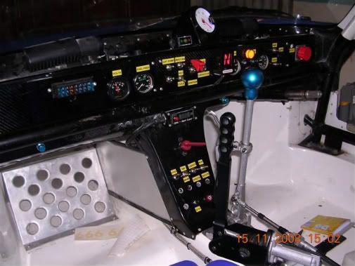

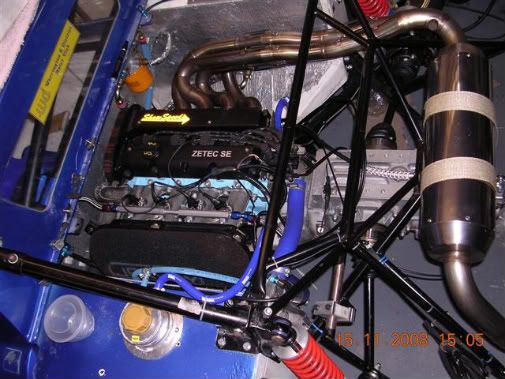

    Here is the engine installed in the car
    and here is the cockpit showing the gearstick etc
    If you have sharp eyes you can see the readout for the gearchange and just see the extra lever (on the gearstick) which you have to pull to select neutral or reverse.......I got this off a pushbike...it cost £4 brand new....we have two cables going back to the transaxle now.

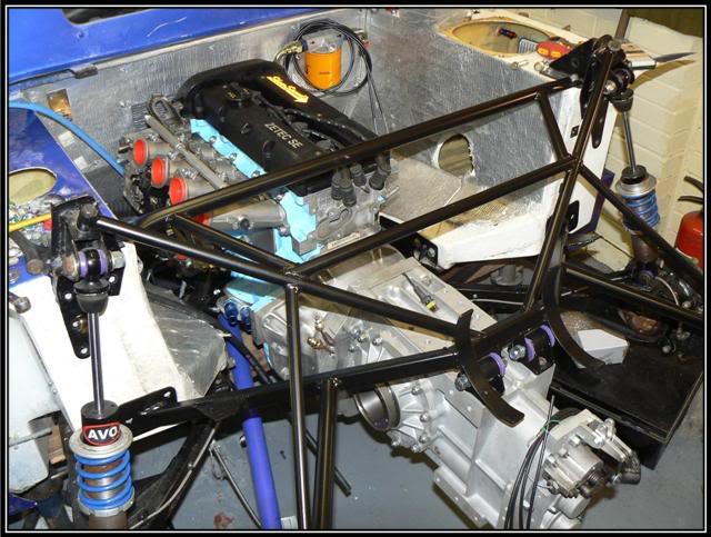

      And an early photo of the engine install showing the gearbox...

              Re: Moggy's Darrian T9
              looks very nice mate
              that zetec SE is a very good engine for a car like this
                      Thanks Ant. hope you are right,....we will see. Once the car has done a few events and all the teething troubles are sorted, we will go for a phase 2 motor...steel rods, forged pistons and bigger cams...see if we can get closer to the magic 200bhp.
