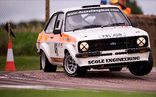

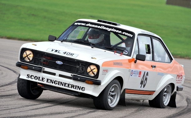

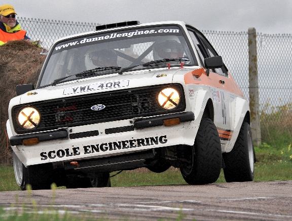

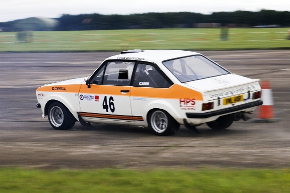

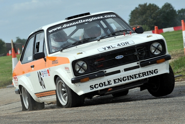

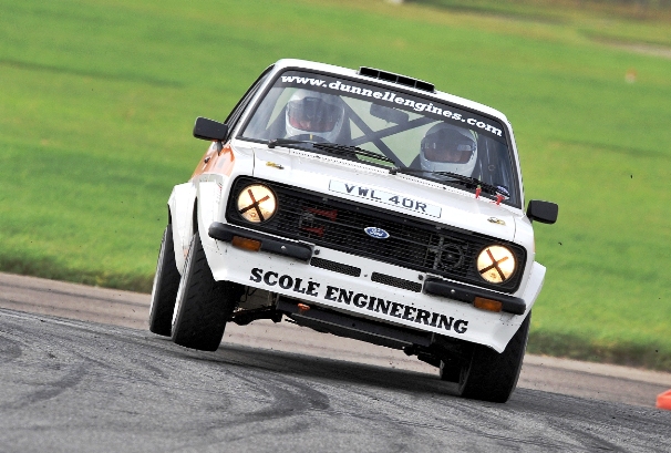

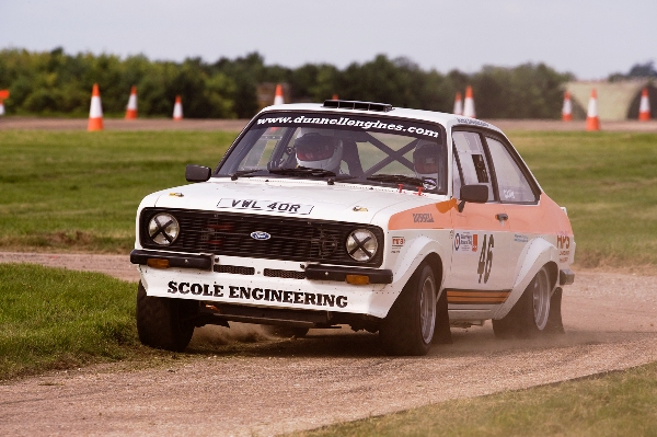

                The Richard Burns Memorial Rally - 15/16 August 2009
                A quick update on how we got on...
                We'd missed last year's event because the car was still in bits - so we were really looking forward to this one. The whole event went pretty smoothly for us and was very well organised. We even had a Red Arrows fly-past on the Sunday.
                I was probably a bit too cautious again during the early stages, but I was also still struggling a bit with the handling. The car was understeering quite a lot in the tighter corners and starting to wear the front tyres again on the outside edge.
                There were 8 stages - 4 each day. The stages were all around 12 or 13 miles and it was very hot.
                At the end of day one we dropped the front suspension about 10mm. This didn't cure the problem entirely, but it did help a bit.
                Our only real 'near' drama was about 3/4 of the way through the last stage. We were flat out on a long wide straight, but when I tried braking for a 90 right into a narrow concrete road, the pedal went to the floor and we had no brakes. Luckily, we could carry on through the cones and then spin it back round again. We did the last few corners with no brakes.
                When we got back to service we could see brake fluid over one of the front wheels - so a pipe or fitting must have split or burst (at the time of writing I still haven't had a chance to investigate further).
                We finished the weekend 15th overall and 7th in class. We were both pretty happy with that, especially considering we were seeded 46th and there were about 100 competitors.
                Our next event will probably be the Lynn Stages in November.
                Some pics...
