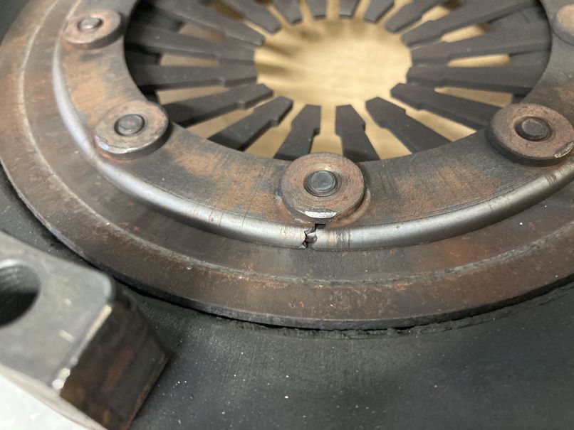

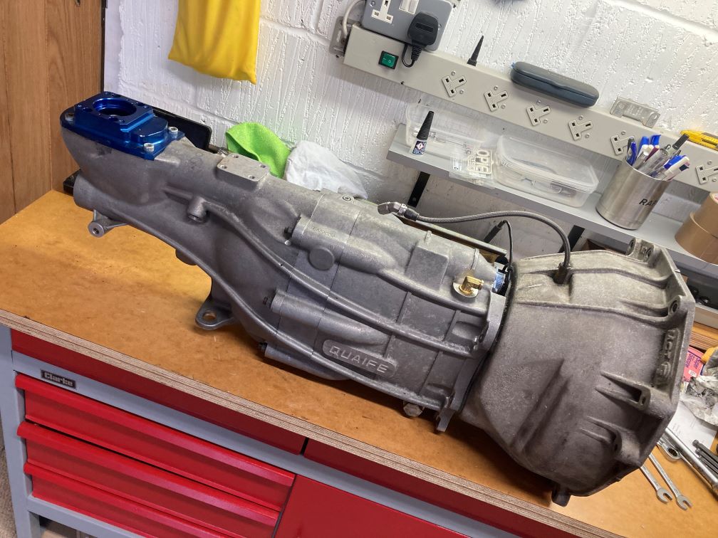

        Yes, for sure, definitely helps. Worth mentioning that it has a Quaife 60G too, which did have a tall 1st gear when I originally bought the gearbox (2.057). I subsequently swapped the diff from a 5.1 to a 4.6 diff and, combined with 15" wheels, it was a struggle to pull away in 1st and putting a lot of strain on the clutch. I had the gearbox serviced recently and changed 1st gear to a 2.4 ratio instead. It is much better now.

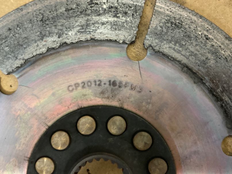

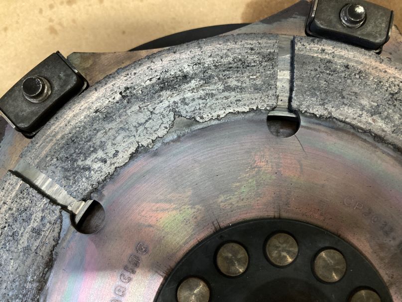

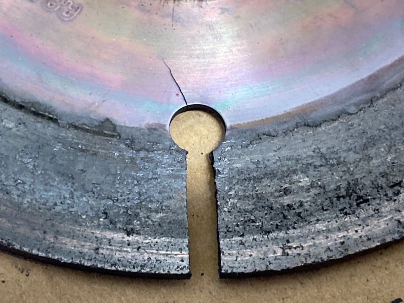

            Yes, I checked the clutch when I took the gearbox out to get it serviced and the 1st gear ratio changed. There were cracks in both plates and the cover had broken - so I had to replace the clutch too. I assume that 1st gear being too tall was putting extra strain on the clutch. It was the same as you described - just about able to pull away on flat ground, but any sort of a hill start just didn't feel good. Much better now with the higher ratio/lower gear.

              Blimey, yea that clutch was bad, wasn't it!
              • JonSegger
                • 520
                Yep. A good job I got to it when I did I think. That cover would have done a lot of damage if it had properly let go.

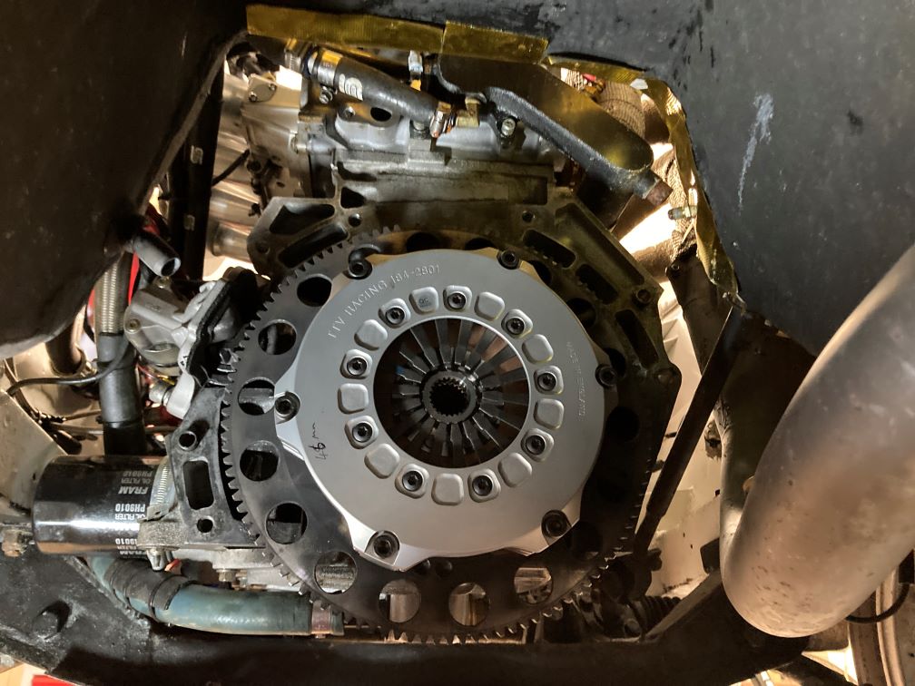

                    That's what it is - twin plate cerametallic. I went for this one (and the associated cover): https://cbradleymotorsport.co.uk/pro...-1x23t-x-5-6mm

                      I know there's probably no warranty as such but I might inclined in send photos of that directly to ttv. I suppose it's been in the car a fair while though hasn't it.
                      • JonSegger
                        • 520
                        That's the new one. The old one was AP plates and a Helix cover.

                          New one is a cerametallic clutch from TTV; old one is a sintered race clutch from AP.
