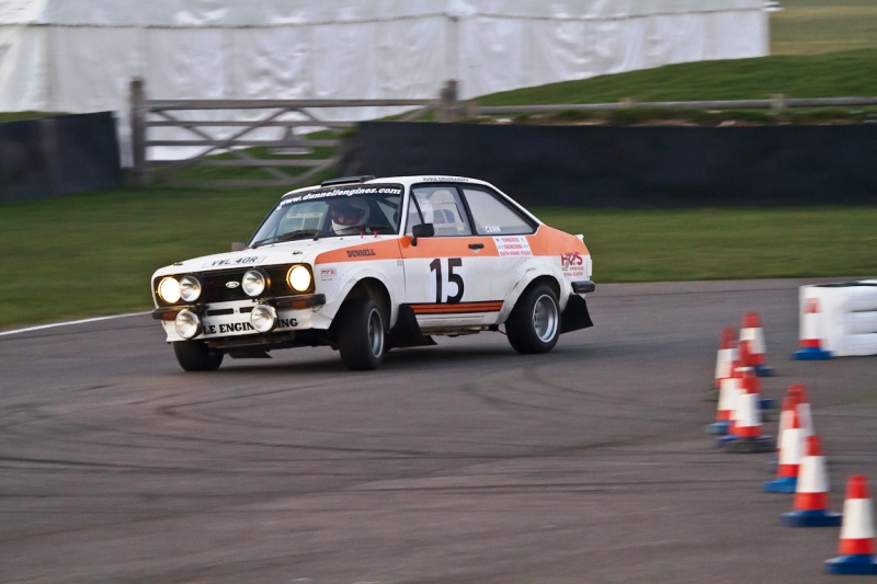

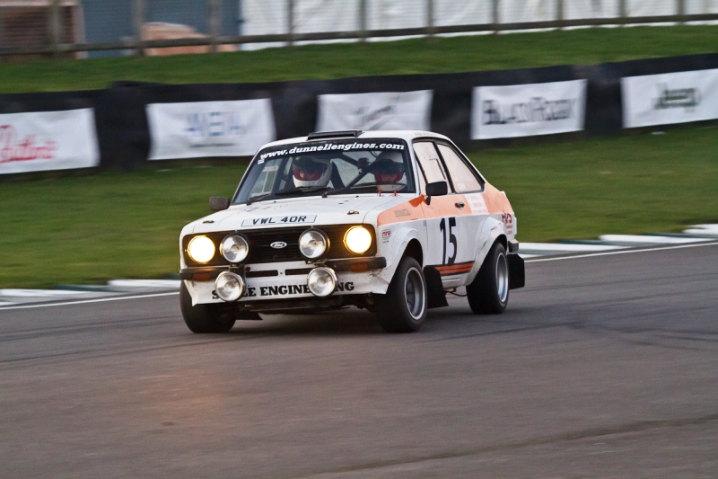

    Anyway, 11th Feb 2012 saw Mark and I competing in the South Downs Stages at Goodwood. Just like every time we've done it before, it was a very cold day. The oil temp gauge read -7.4 degrees centigrade when I started the car!
    We got through scrutineering without any issues and then it was time for the first stage. I felt pretty rusty if I'm honest - not having driven the car for a while, so I was pleasantly surprised that we were 12th fastest on the first stage. The second stage felt better and we were 7th quickest.
    It all went wrong on the third stage though. Some of the chicances were marked out with lorry tyres and as I went through one of them it I just clipped one of the tyres with my right front wheel. It whipped the steering wheel out of my hands and as I grabbed it again to re-join the circuit, I could see that I'd done some damage as my steering wheel was now perfectly upside-down. The yellow tape marker was now at the bottom. The car would still going in a straight-ish line, although I could feel that something wasn't right. We finished the stage taking it a little easier through the rest of the chicanes and then inspected the damage when we got back to the service area.

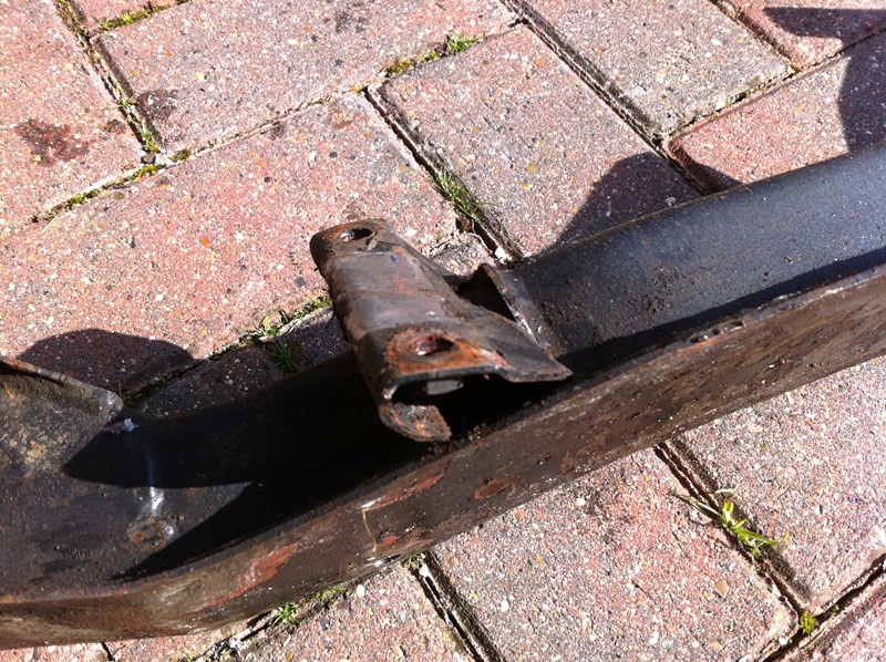

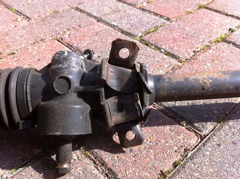

    The wheels were now toe-ing out somewhat and upon closer inspection we could see that the brackets on the crossmember that hold the steering rack were bent up and partly torn. There was nothing we could do to fix them, so we carried on for the rest of the day as it was, checking the rack mounts after each stage to make sure that the damage wasn't getting any worse. I had to be a bit more cautious for the rest of the day though as we couldn't afford to hit it again in case it pulled the rack off completely.
    The last two stages were in the dark, which was great fun. We finished the day 13th overall and 6th in class. Not brilliant, but better than a DNF which it could have so easily been.

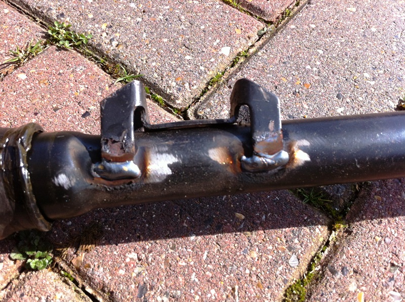

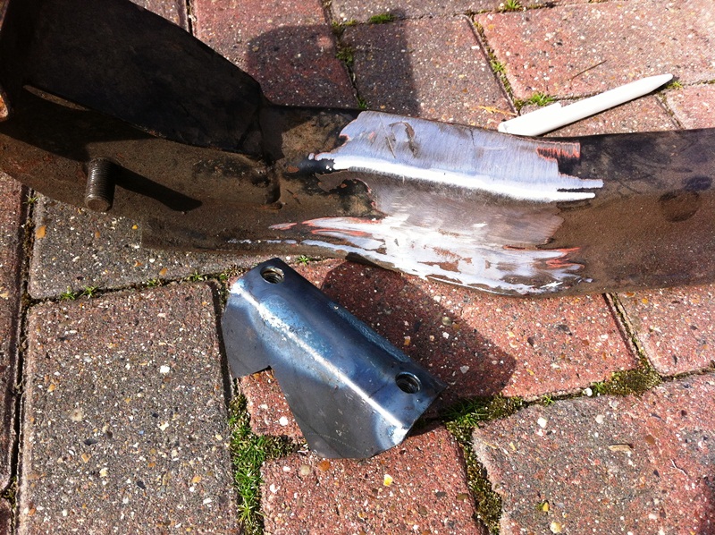

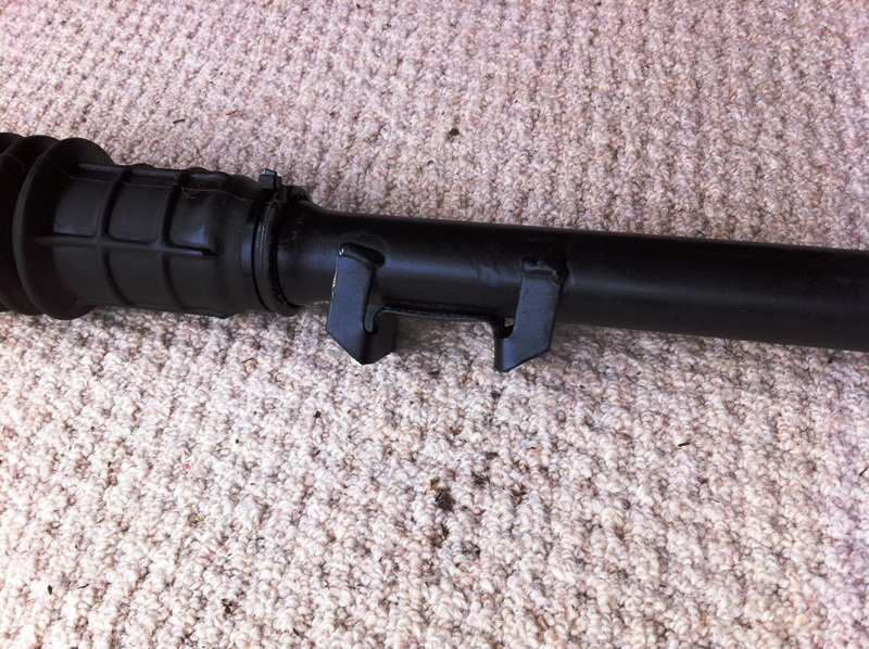

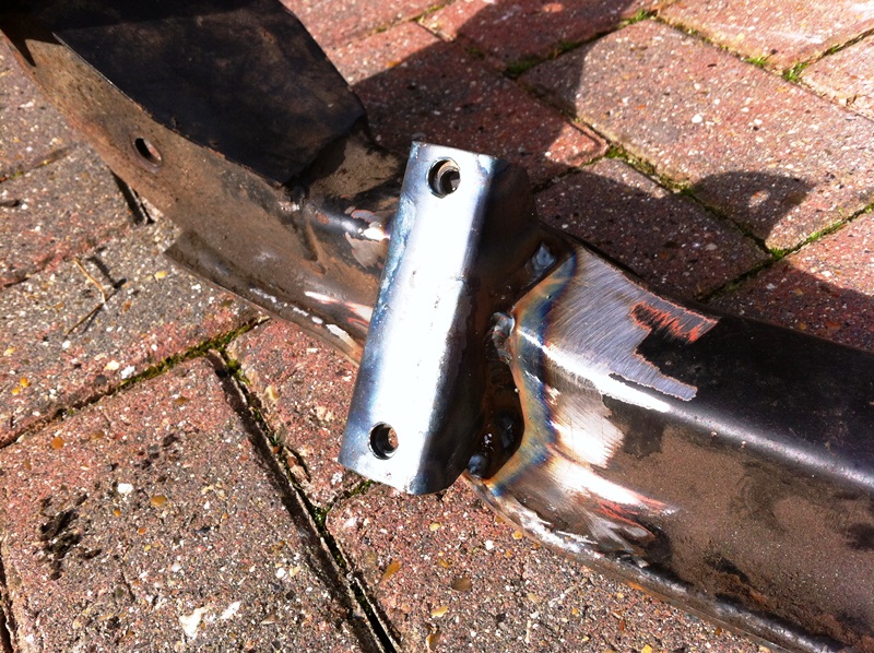

    So, this weekend I got round to repairing the damage to the steering. I had to cut one of the brackets off the crossmember and make a new one. I also had to repair the locating bracket that is welded onto the tube of the rack itself. I think the pictures show what I mean better than words:

      Sounds like it was a cold cold day at Goodwood mate, I bet you didn't have any oil temp probs there like some of the events we have done together!!!
      You must have given the rack a fair old clout, that's a fairly bent mount there!!! When I got my cross member, before I got it powdercoated I boxed them all in with extra bracing. Mind you with a knock like that it'd probably just bend a steering arm instead Glad you got to carry on and finish anyway. Cross member looks good as new again

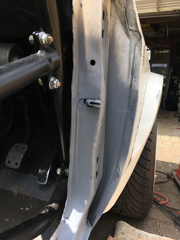

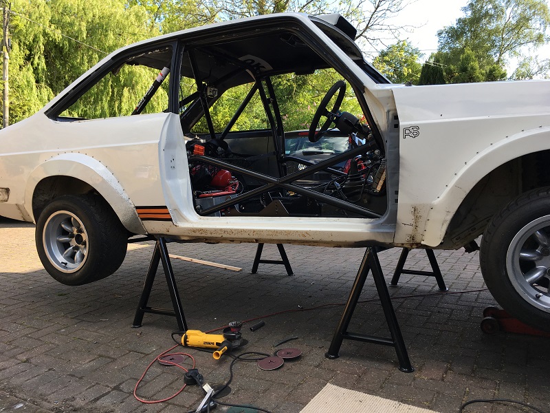

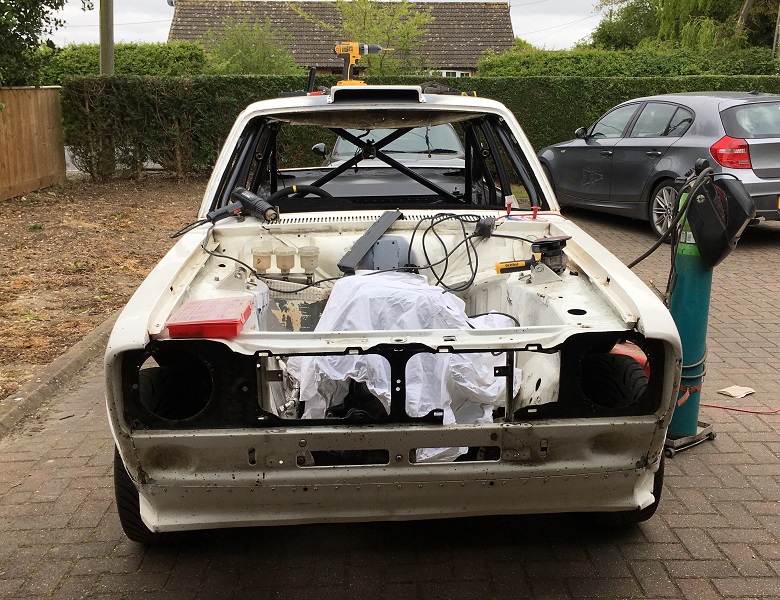

          I still have the Escort. We've not done much in the way of rallying for a few years though. One reason for this was that the MSA introduced rules regarding seats and belts having expiry dates. These went out of date for my car, meaning I needed to replace them if I wanted to continue competing. I just couldn't justify the cost at the time, given that we were only doing one or two rallies a year. It seems wrong to spend all that money and then only use them maybe 10 times if I'm lucky. The MSA then introduced a requirement for HANS devices, which also means new crash helmets. It was all too much, so we just used it for a few track days instead. A lot cheaper and still lots of fun.

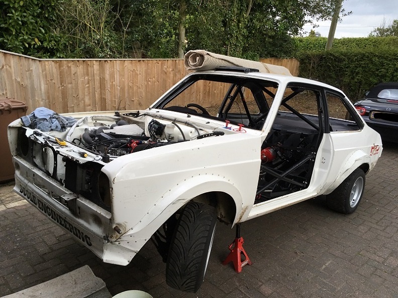

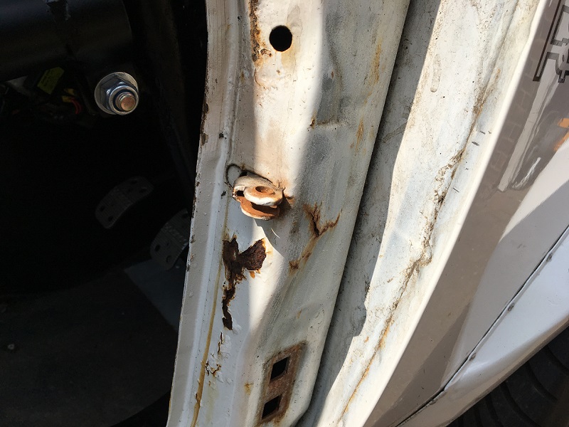

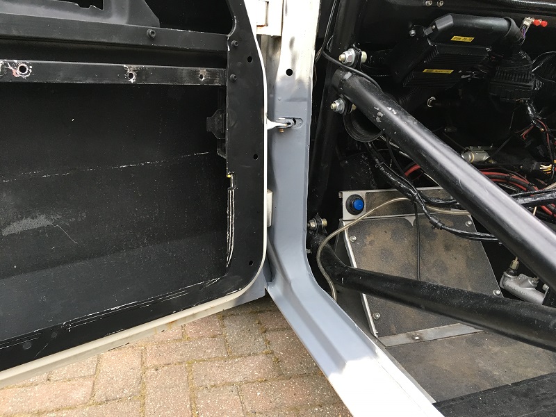

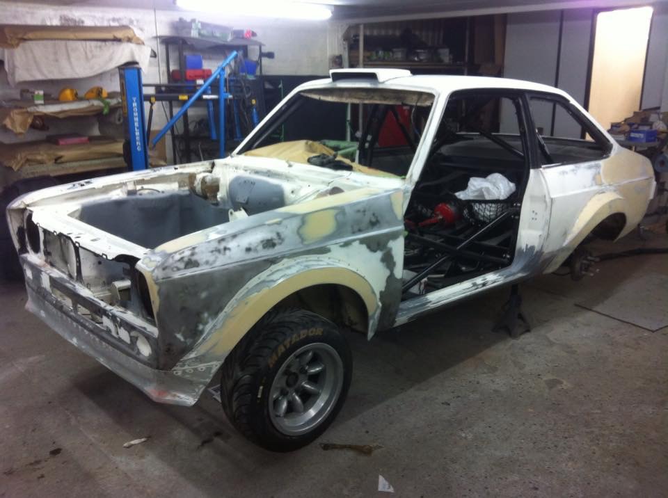

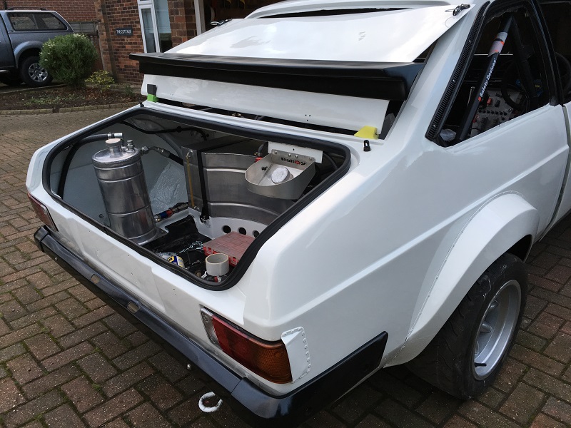

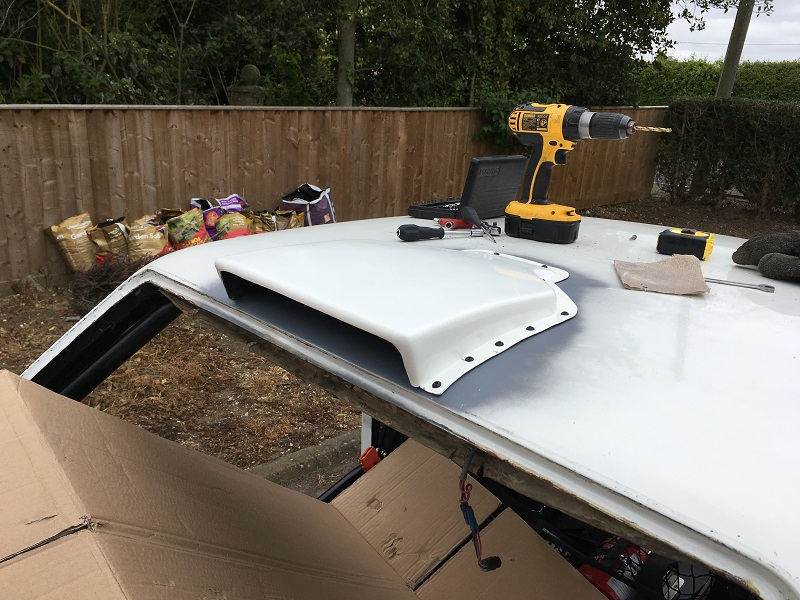

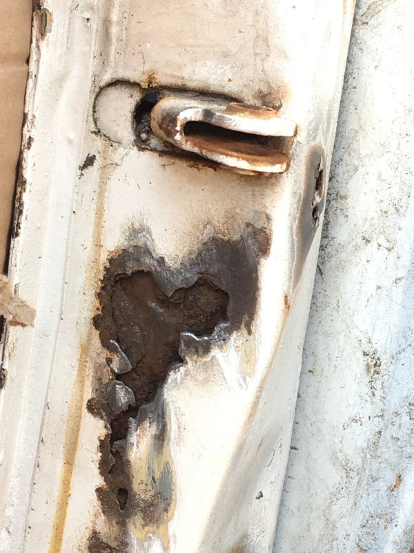

          As the car has seen a bit of action, it was showing its age a bit. It's a very solid shell, but there was a rust patch on both of the door posts (the only bits I didn't cut out and do properly when I built the car) along with some damage to the rear quarter. I also had fitted a roof vent which just didn't work properly because it sat too far back and the airflow skipped over the top of it. I couldn't sit it any further forward because the internals hit the roll cage. I'd added a dodgy extension to the front of the air scoop, which worked better, but looked a bit crap.

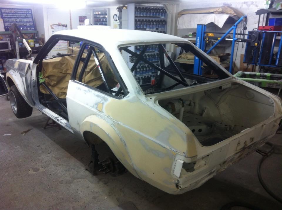

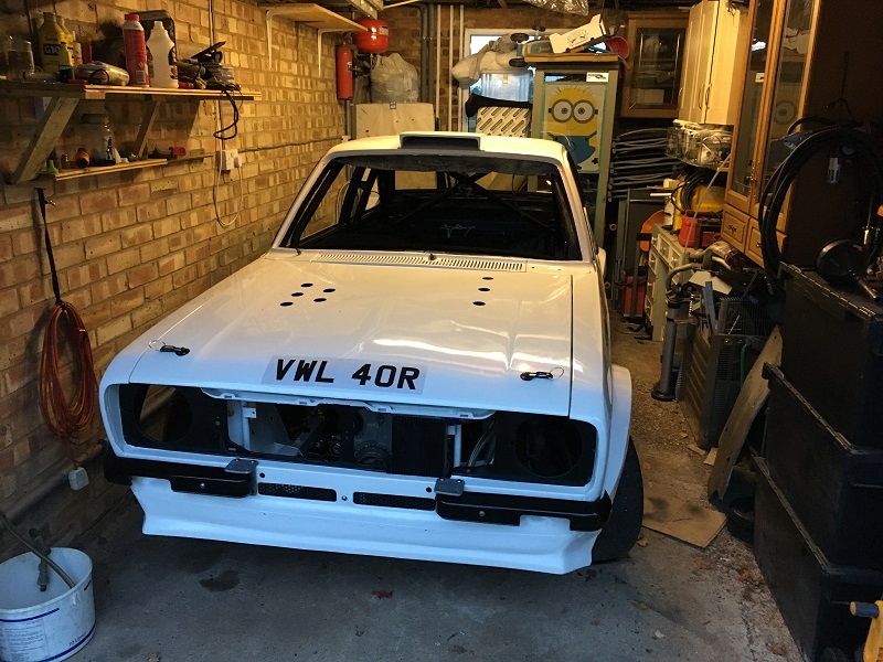

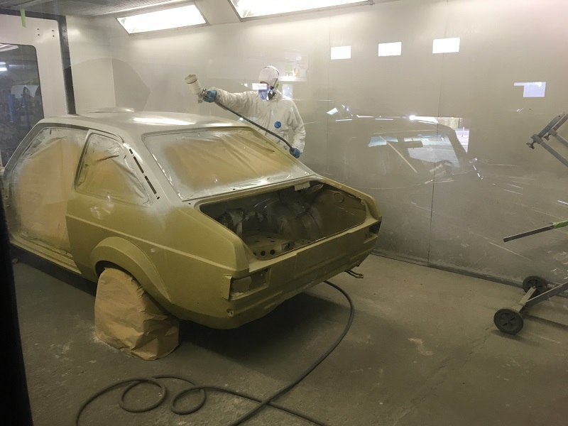

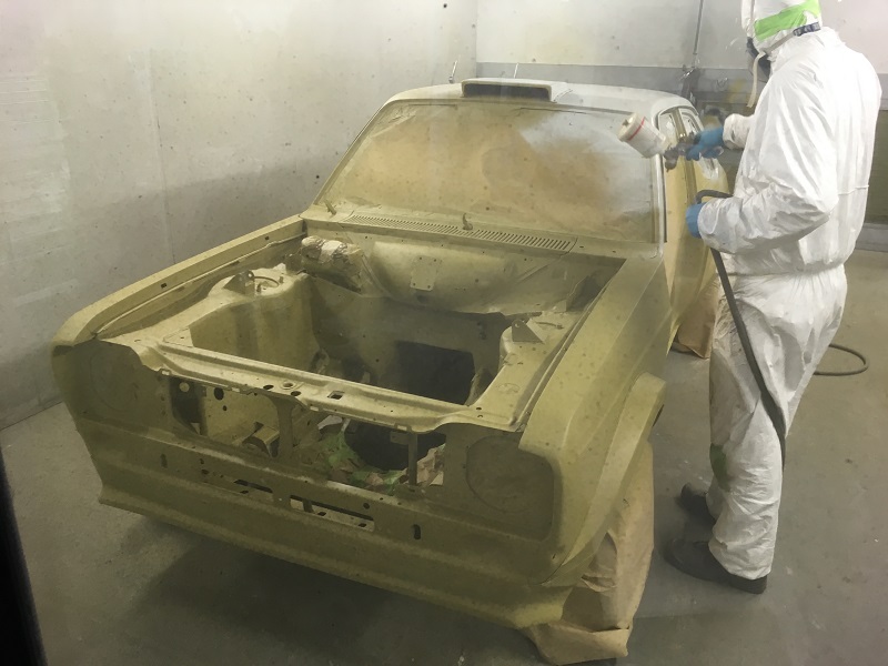

          So it was time for a freshen up. The main objectives were to give it a fresh coat of paint, fix the rust/damage and fit a better roof vent. So about a year ago the mini-rebuild began...

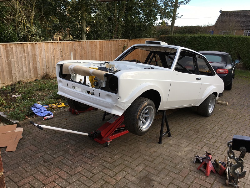

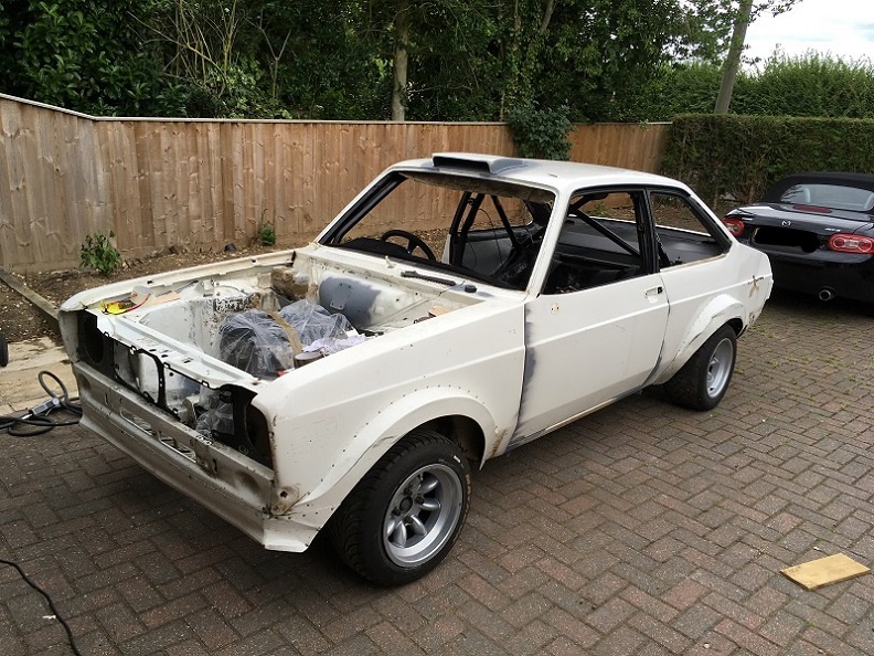

          First job, getting the stickers off (which took ages) and then sorting the door posts:

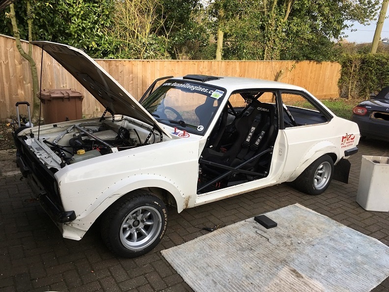

          New roof vent fitted:

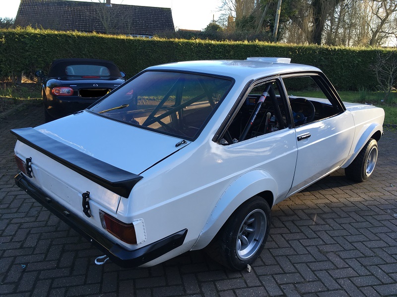

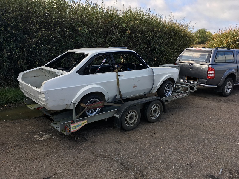

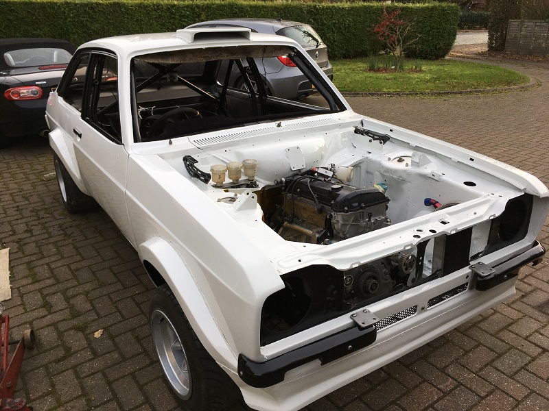

          Off for the respray at Scole Engineering:

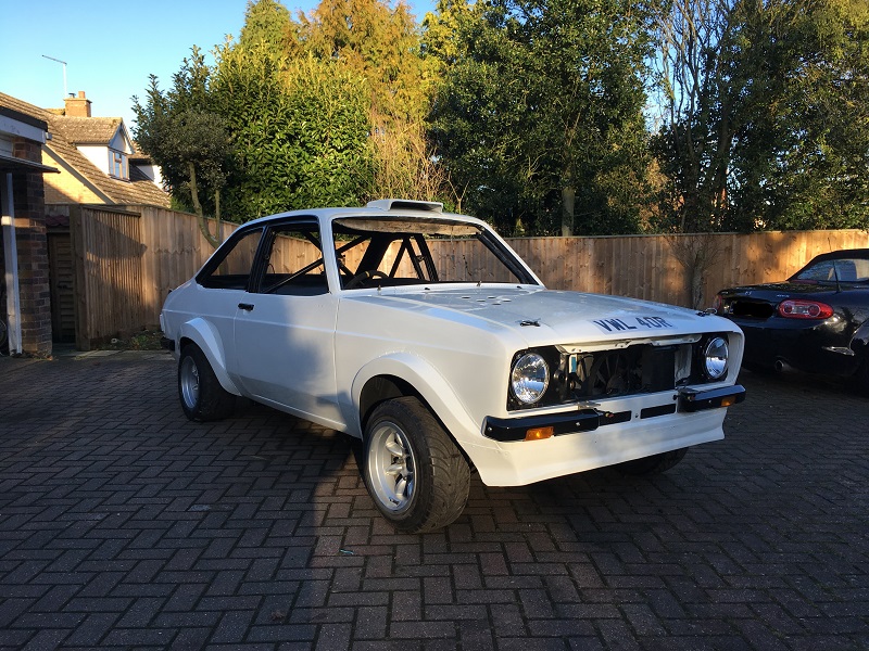

          Back home, looking fresh:
          It's taking shape now. Hoping to crack on some more over the next week or two.

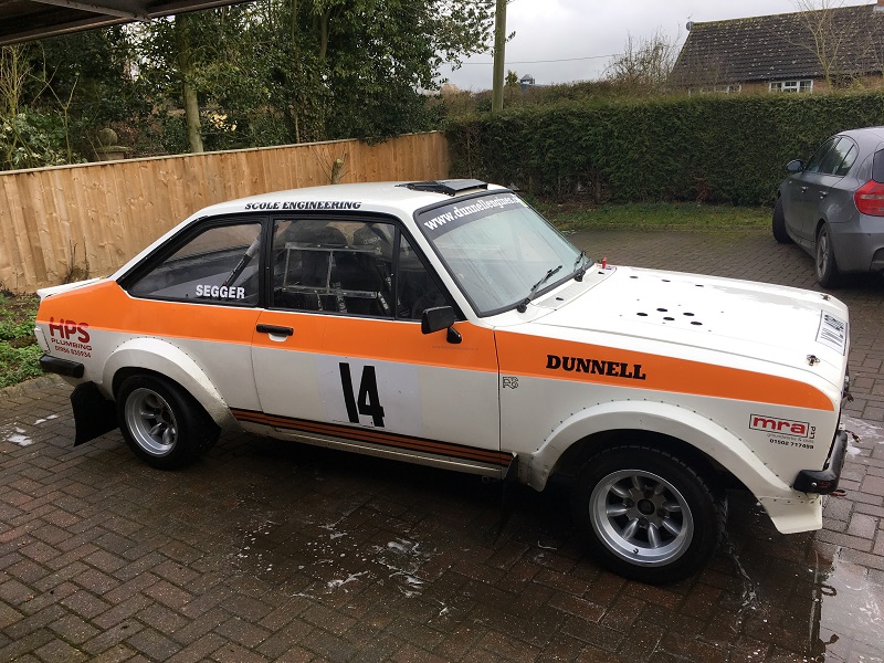

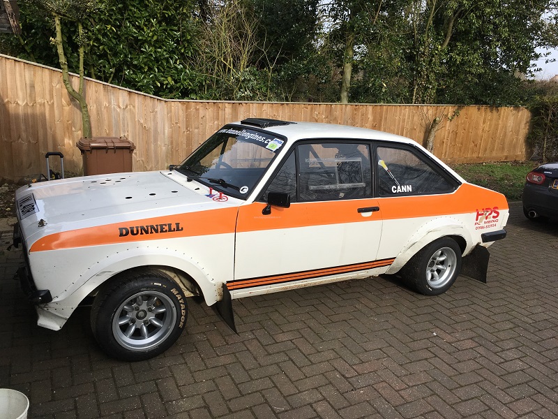

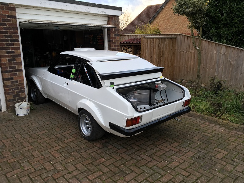

                      Just by way of a quick and long overdue update - I've still got this car. Still not been out competing in it, for reasons mentioned previously, but we have done a few track days. This is what it looks like now:
