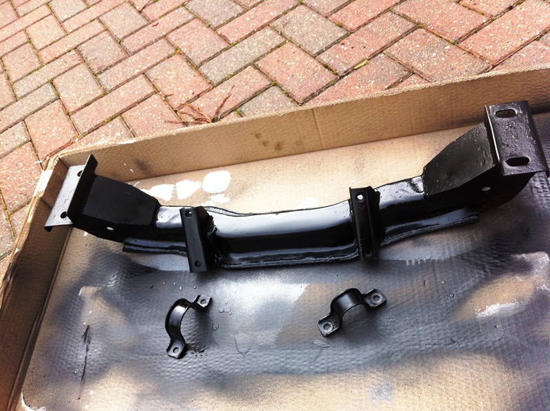

    So, this weekend I got round to repairing the damage to the steering. I had to cut one of the brackets off the crossmember and make a new one. I also had to repair the locating bracket that is welded onto the tube of the rack itself. I think the pictures show what I mean better than words:

      You must have given the rack a fair old clout, that's a fairly bent mount there!!! When I got my cross member, before I got it powdercoated I boxed them all in with extra bracing. Mind you with a knock like that it'd probably just bend a steering arm instead Glad you got to carry on and finish anyway. Cross member looks good as new again

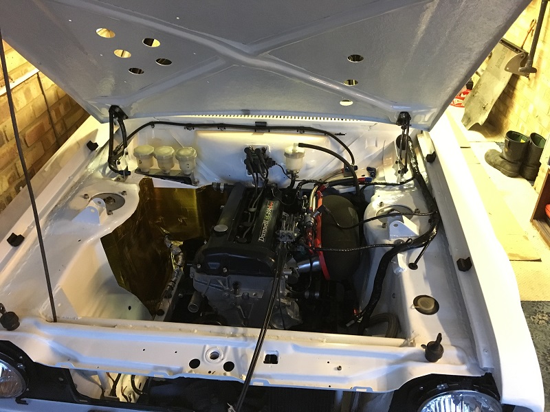

          As the car has seen a bit of action, it was showing its age a bit. It's a very solid shell, but there was a rust patch on both of the door posts (the only bits I didn't cut out and do properly when I built the car) along with some damage to the rear quarter. I also had fitted a roof vent which just didn't work properly because it sat too far back and the airflow skipped over the top of it. I couldn't sit it any further forward because the internals hit the roll cage. I'd added a dodgy extension to the front of the air scoop, which worked better, but looked a bit crap.
          So it was time for a freshen up. The main objectives were to give it a fresh coat of paint, fix the rust/damage and fit a better roof vent. So about a year ago the mini-rebuild began...
          First job, getting the stickers off (which took ages) and then sorting the door posts:
          New roof vent fitted:
          Off for the respray at Scole Engineering:
          Back home, looking fresh:
          It's taking shape now. Hoping to crack on some more over the next week or two.

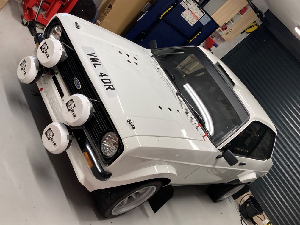

                      Just by way of a quick and long overdue update - I've still got this car. Still not been out competing in it, for reasons mentioned previously, but we have done a few track days. This is what it looks like now:

                        • 2437
                        Looks very nice mate
