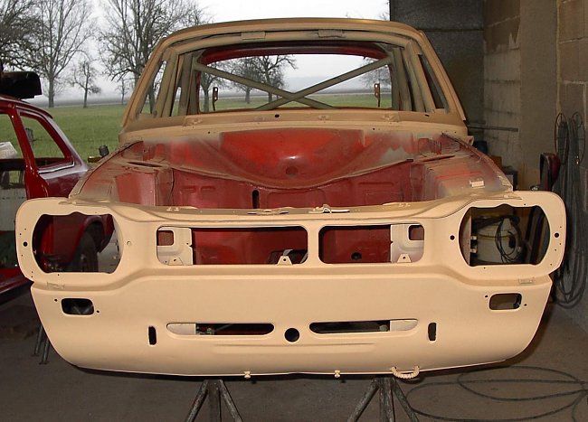

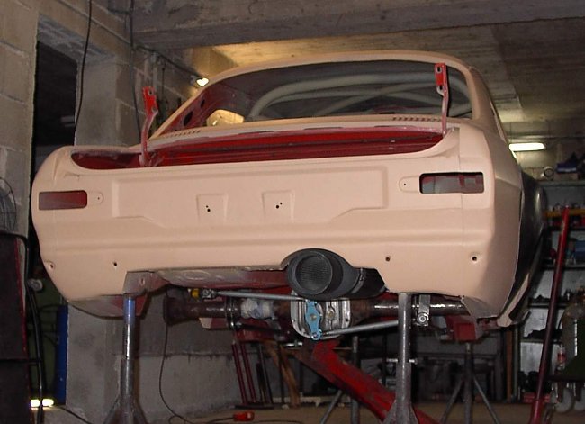

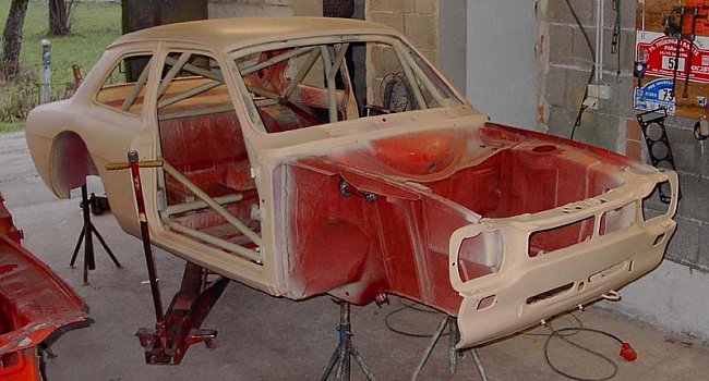

    Here i want show you some pictures and informations from my Escort MK1 Tarmac Rally Car from the beginning till now (project not complete finished till now because it get new painted and some new interior, details about the new interior later, hope in the early 2011 it get finished).
    At the beginning it was an 2,0 Pinto 8V engined car with 4 speed straight cutted gearbox, later then it get´s an Volvo M47 5 speed straight cutted gearbox.
    Now it is an nearly finished 2,4 16V Cosworth engined car with 6 speed Quaife 60G gearbox.
    Engine has 291,3 HP @ 7100 rpm and 305,2 NM @ 5500 rpm.
    Between 3700 rpm and 7700 rpm it is always over 250 NM.
    But let´s start with some photos from the beginning:
ID:	2045690Click image for larger version
ID:	2045691Click image for larger version

    Re: VDH Escort MK1 Tarmac Rally Car
    For what you want to use the car.
    Historically
    German group H
    I think it will be difficult. Large wheel arches in Group H are allowable?
    If the cage is a certificate or homemade?
    • VDH Racing
      • Sep 2010
      • 12
      Hi.
      Car is already used in German group H.
      It is long time ago that i drive a rally with the car because i work in China for my company since Nov. 2006.
      But i drive with the large wheel arches the 3 Städte Rallye 2006, this was also first rally with the Cosworth engine.
      The roll cage is "homemade".
      • Escort TC
        • Jan 2009
        • 428

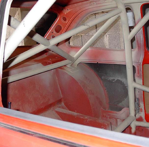

        If you work in China you do not have the new H-rules, perhaps. Since Jan 2010, no large tunnel and no more big wheel arches are allowed. Any changes above the door sills are not allowed as far as I know. I am not a large specialist in group H.
        The homemade cages must have a lot more reinforcements. (Double door struts, gussets, diagonals and more). Jan 2011 even new ones. Must you make even read the manual.

              • 360phil
                • May 2009
                • 176
                Car looks great. I like the extra vertical bar at the A pillar - WRC style.
                One comment - the door bar looks a smaller diameter than the rest of the cage - not the best place to save some weight?
                Looking forward to seeing some more recent pictures.

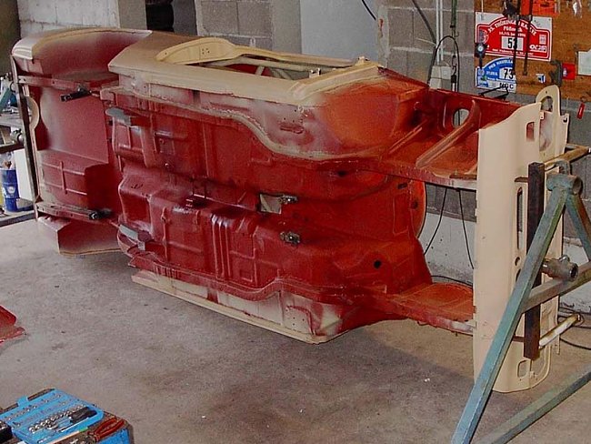

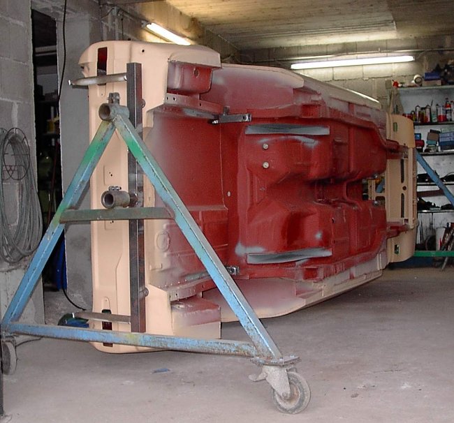

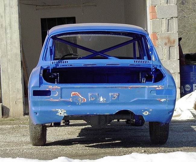

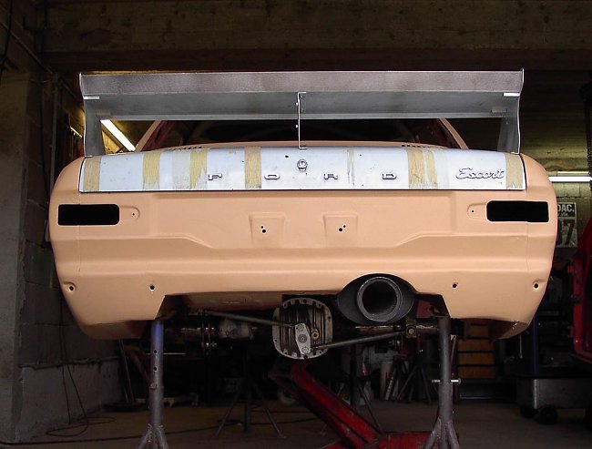

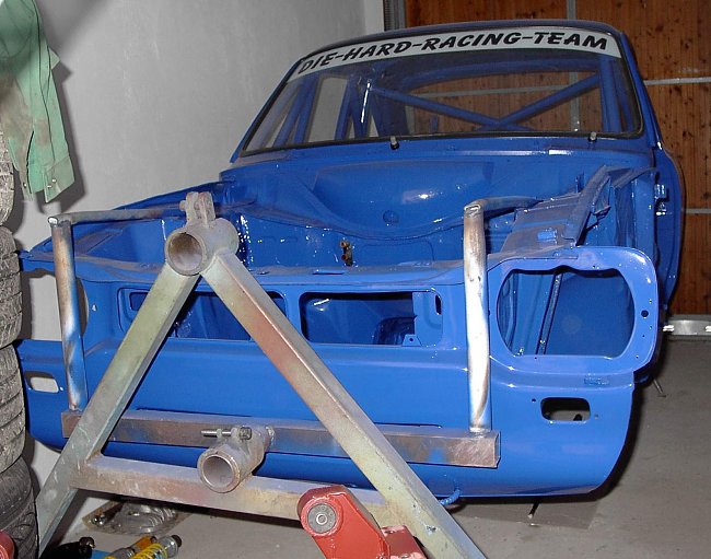

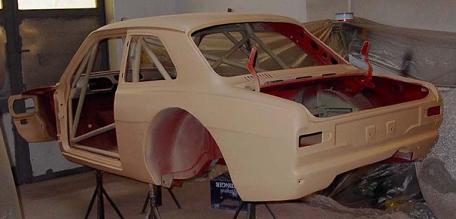

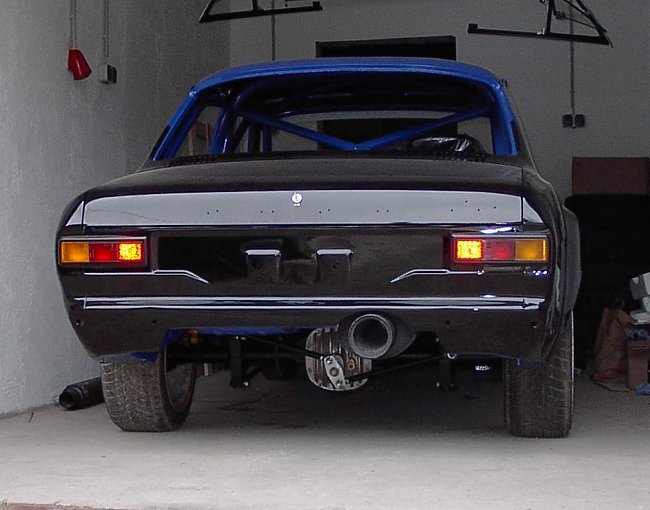

                    another picture from the bodywork at the very beginning
Name:	Boden vh grundiert.JPG
Name:	Front grundiert.JPG
Name:	Heck,Watt2 grundiert.JPG
Name:	Heck,Spoiler,Watt  grundiert.JPG
                    @ 360phil
                    the roll cage is only made with 40mm*2 & 50mm*2 pipes, no smaller size. same when you buy an rollcage from OMP or some other company... maybe it cheat on the picture

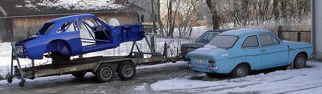

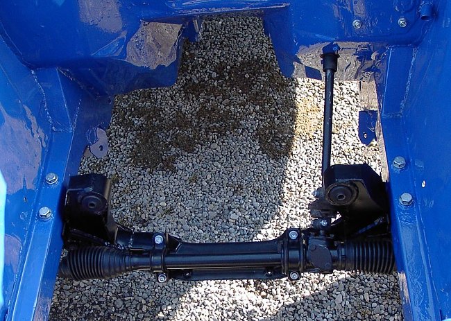

                      last but not least it comes the "big" day when i pick it up from first painting job :-)
                      i was very happy when i have it at home because it was a little bit "swinging" during the drive.
                      but i had only 3 kilometer to drive, so i drove not faster then 30 km/h (sunday morning, everybody was in the church expect me so the street was empty)

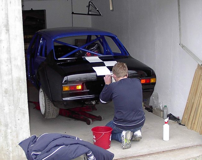

                          • VDH Racing
                            • Sep 2010
                            • 12

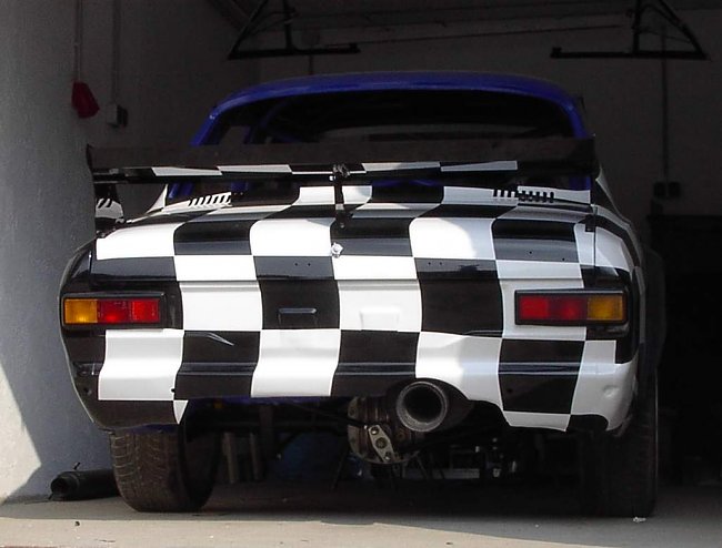

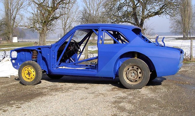

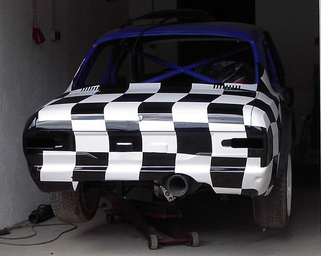

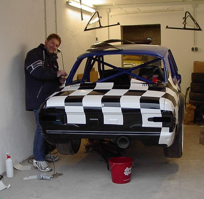

                            here pictures infront of the second painting jobs...
                            ... and also then painted!
                            but this was not the design what i want have so a friend must make some job.
                            a view stickers and then it looks better!
                            styling finished!!!
