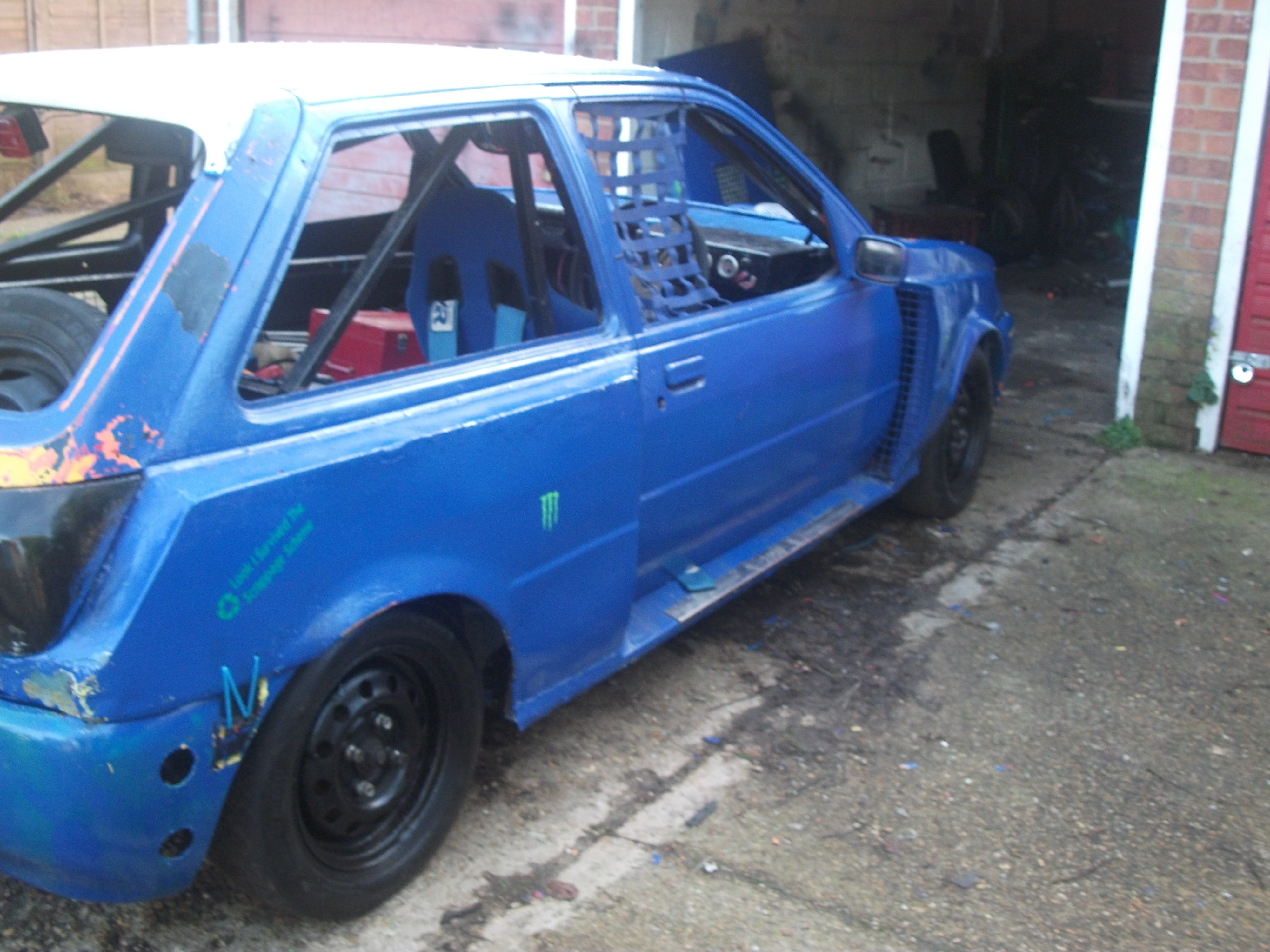

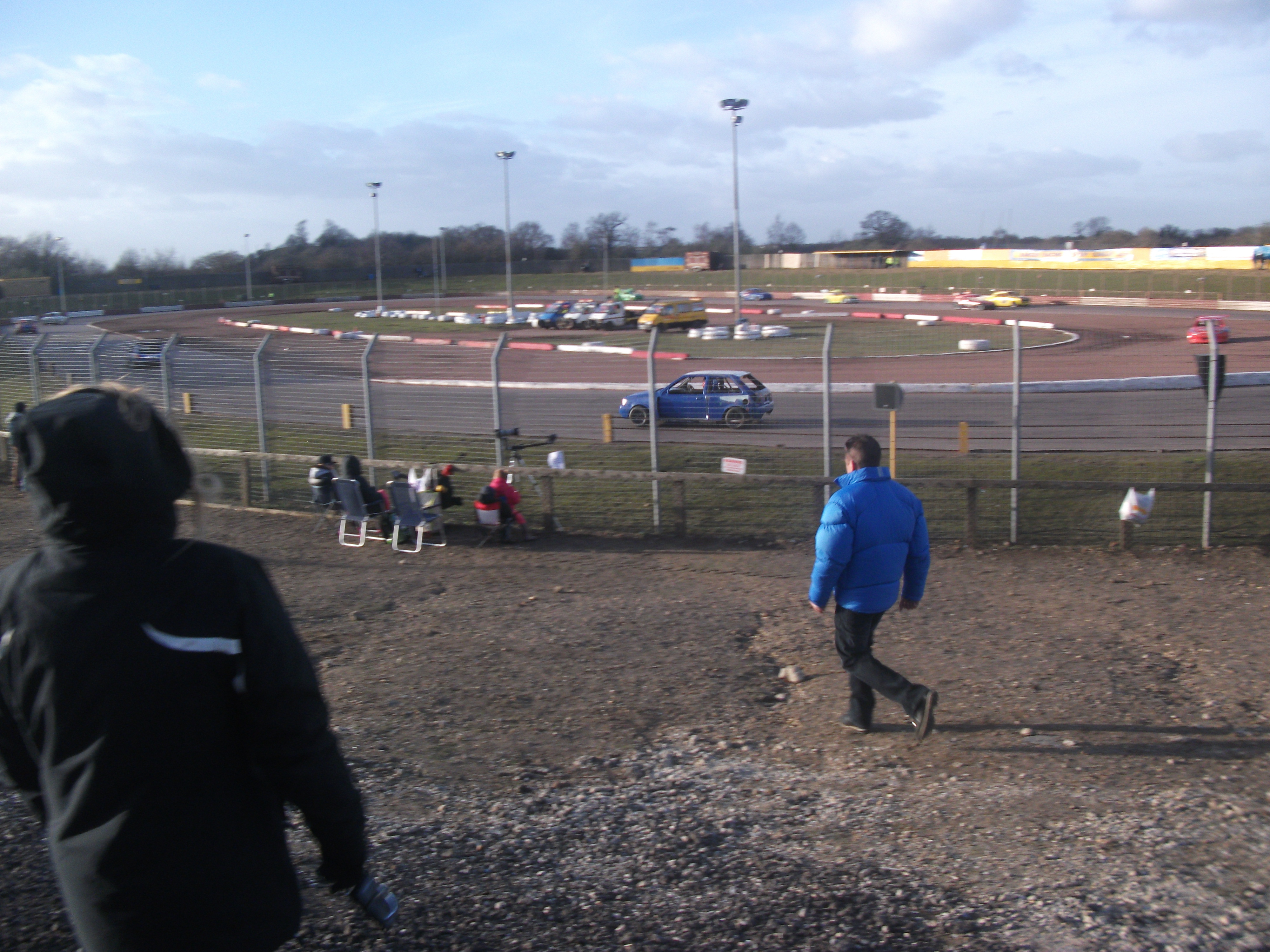

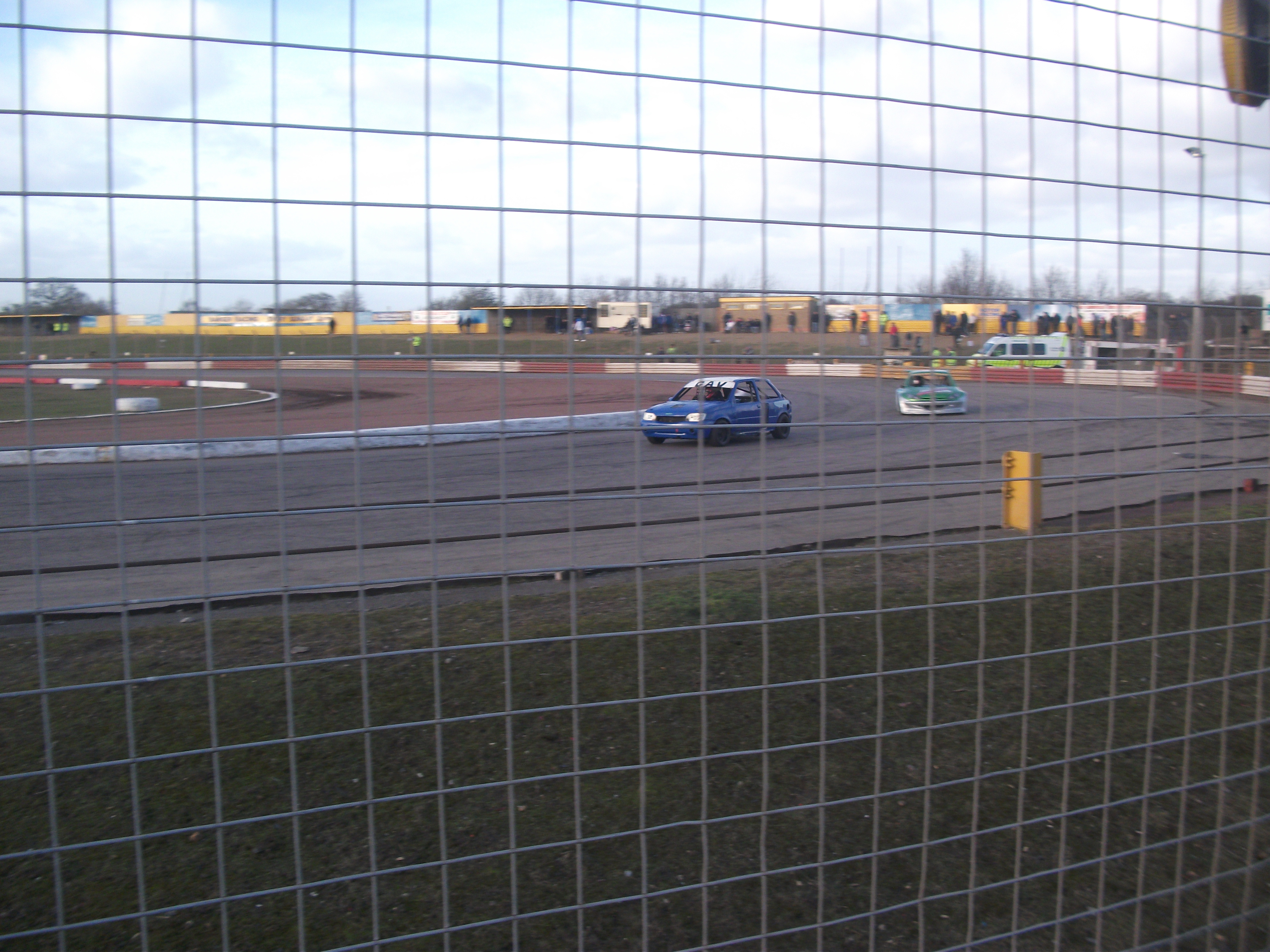

                              sum pics my brother done.this 1 with 8s
                              6s inside

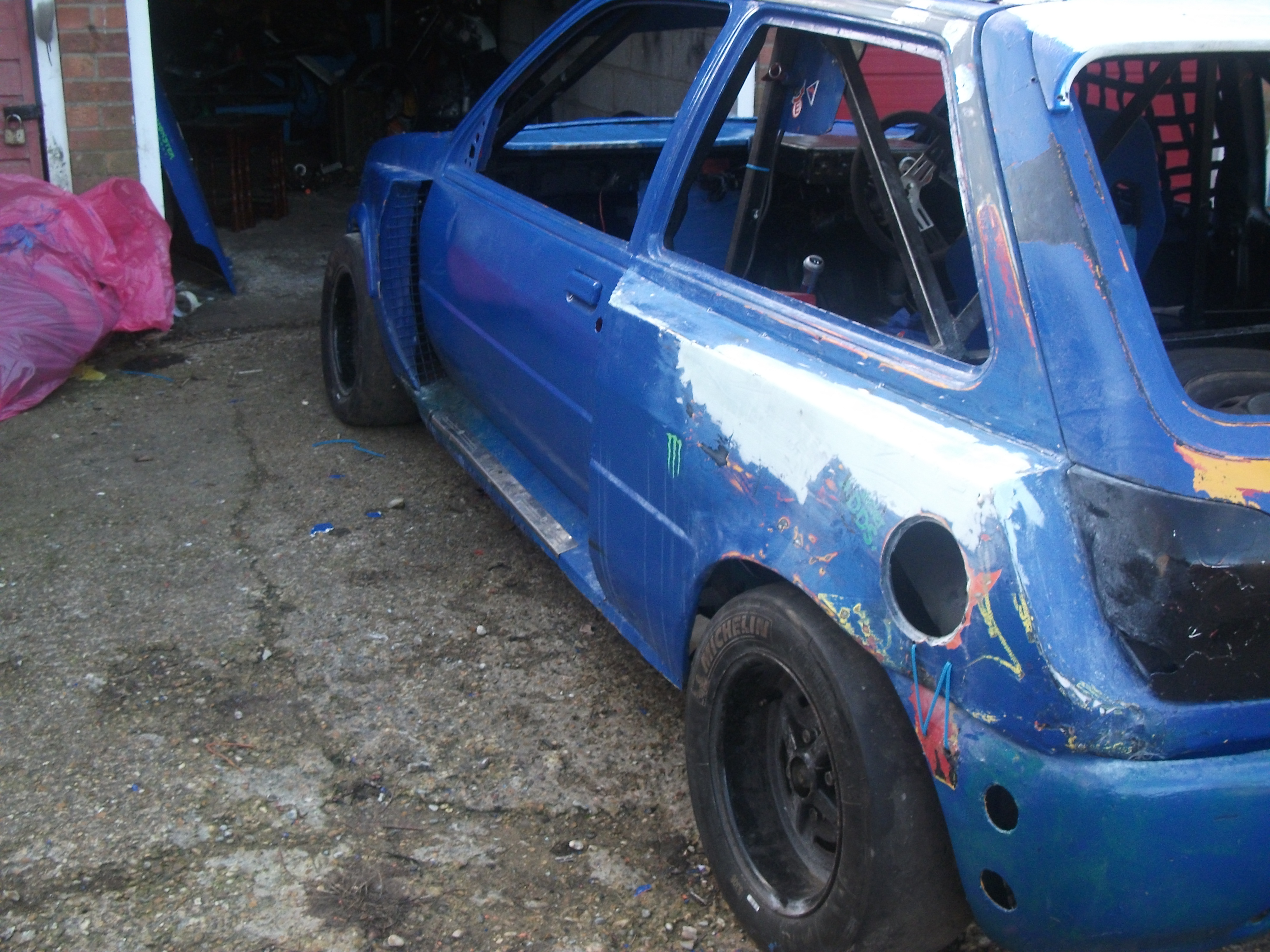

                                6s inside

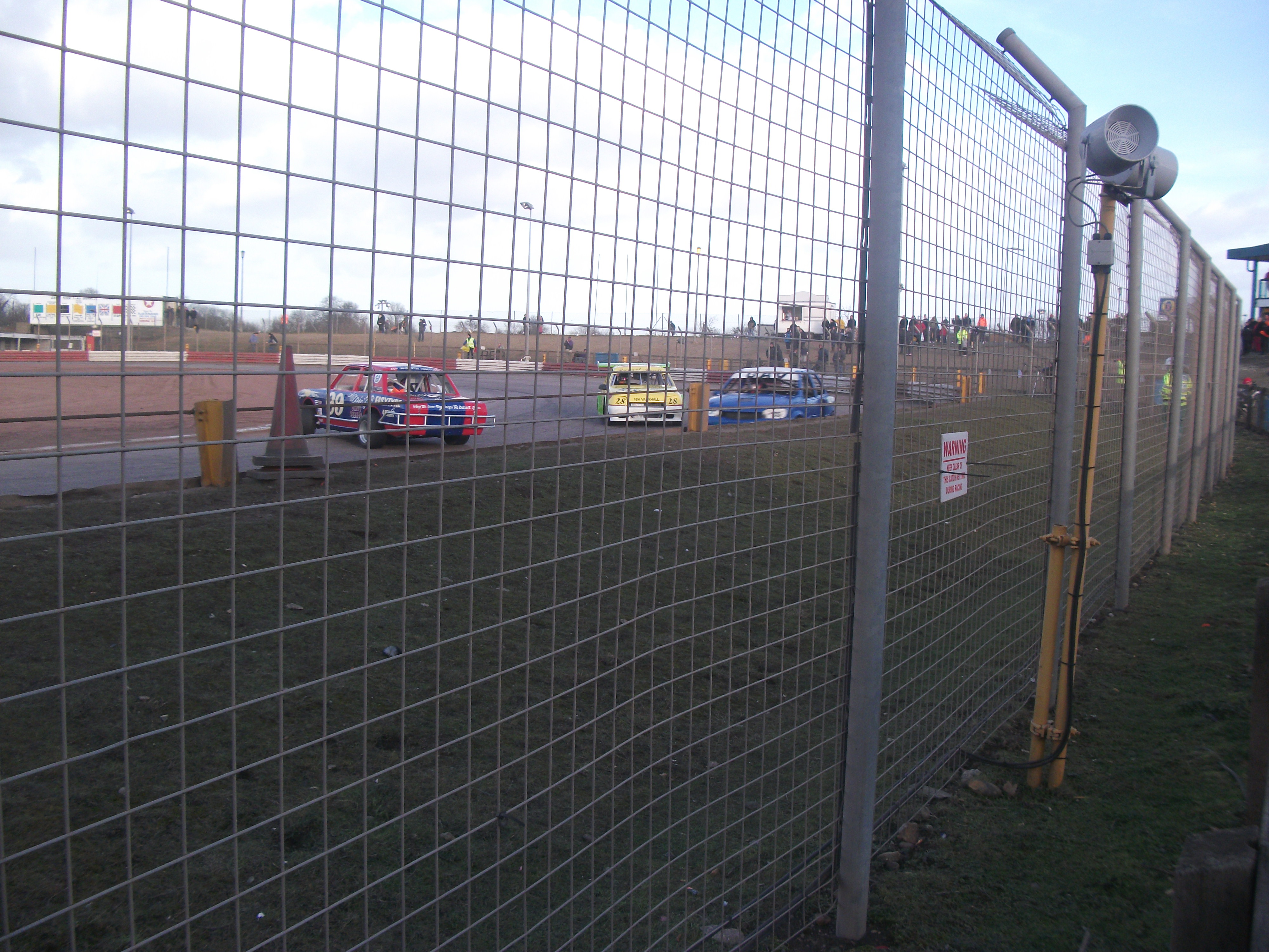

                                the spinner that caused me 2 bust a brake bracket
