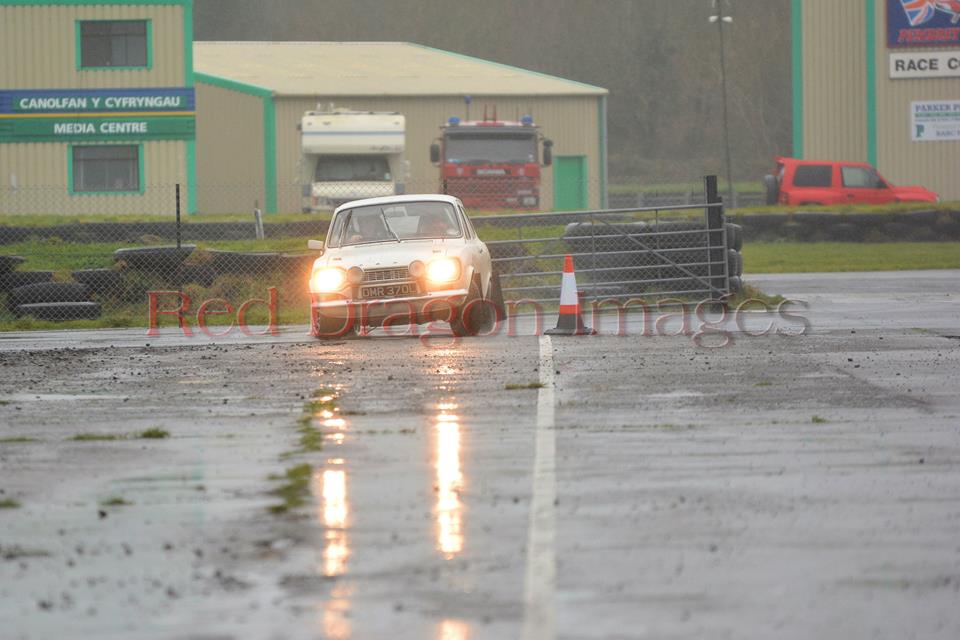

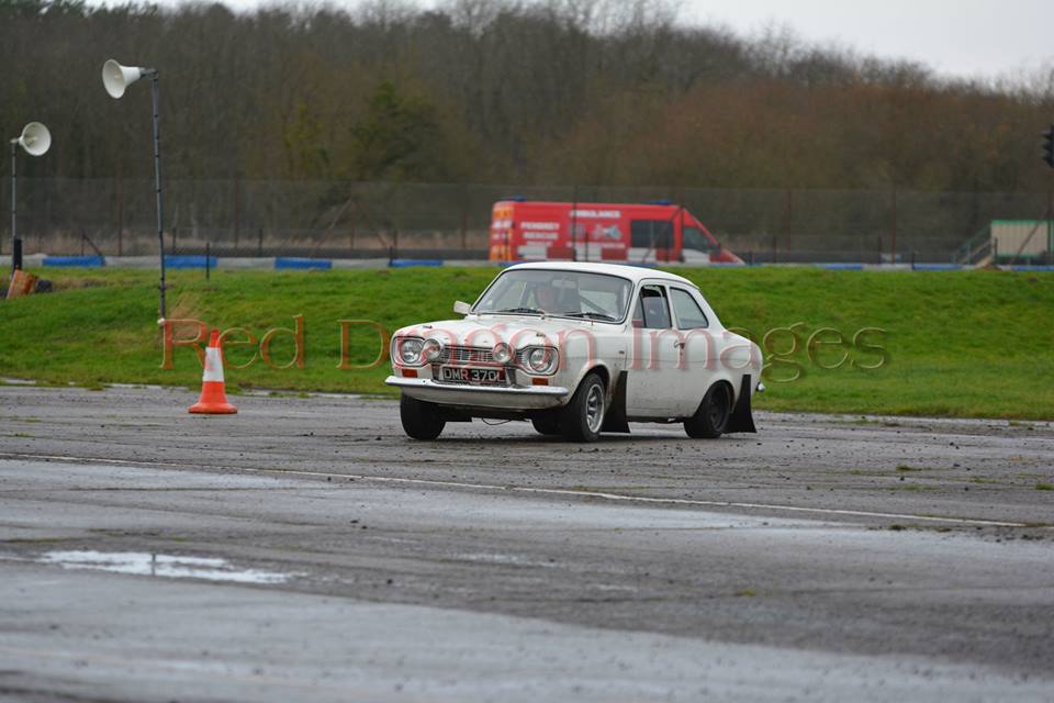

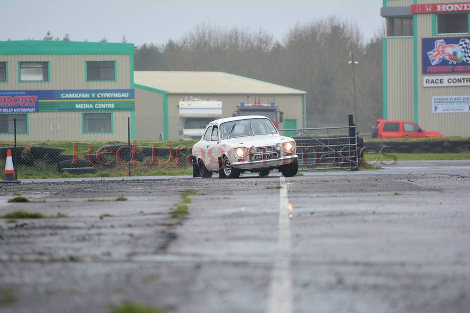

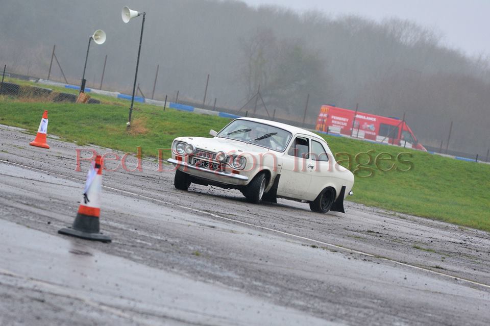

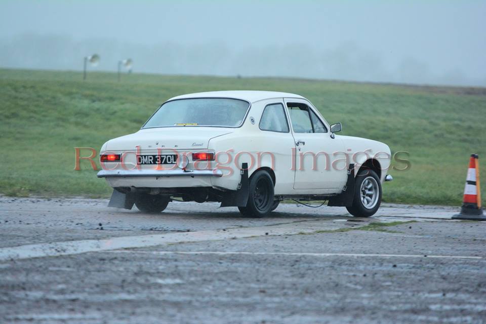

                            I did a Motorkhana at Pembrey Circuit yersterday. We used part of the main track as well for a change. The car is still cocking a rear wheel on tight turns if you it isn't sliding (haven't changed anything yet so as expected). It was quite a wet day and used 21's on the front and old cut slicks on the rear. I tried to keep it clean and tidy driving style but was difting everywhere but did manage to finish 2nd in class and 4th overall out of 60. I will invest in 220lb springs in new year.Click image for larger version

                                The only difference in set up from your car to mine is the lack of a front ARB, i run a pinto with r888 tyres, 190 front springs, 146 leafs., panhard and a twin cam arb.....rj TCA's etc. my car handles perfectly, occasionally lifts a front wheel but never 2, i would say you need stiffer front springs........i sometimes use 220ld with an ARB......your set up would be ok with road tyres but put soft rubber on and youll need to go stiffer., i also use +10mm Gp4 alloy hubs, the front end is planted and turn in is amazing with 185 tyres.
