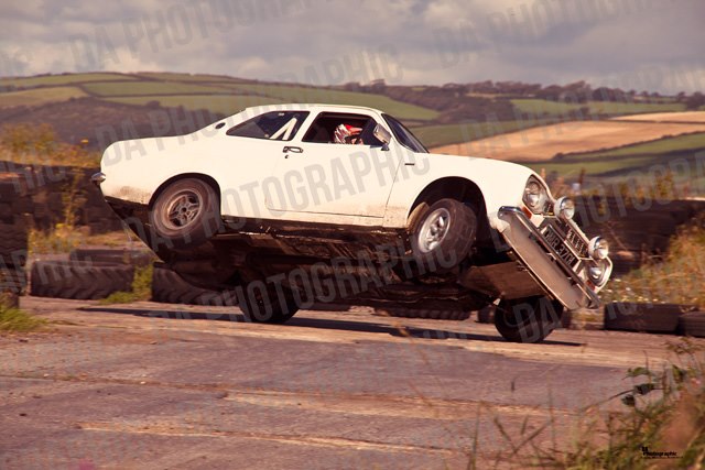

            • jonsey
              • Feb 2011
              • 147
              Re: Escort Suspension issues
              The photographer said it was alot higher than this in the previos photo, ut he only caught half the car.
                  I would only expect to see that sort of angle after launching off a bump on one side, not just turning .... unless it was .. left right left right left, setting up a pendulum effect.
                  You can flip most SUV's like that on road tyres..
                      The Photo is from a 180 deg hand brake. Probably driving straight for 20 metres in 1st gear. No object was struck and its nice flat but quite grippy concrete. Will have to take the shock off after the weekend as its going on the trailer ready for tomorrow. I'm tempted to wind them up a few clicks just to help the rear break tracion a bit.
