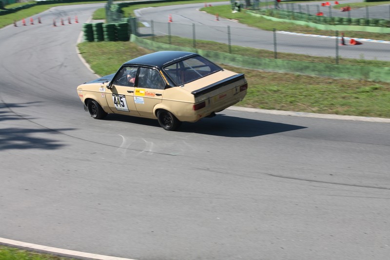

    We drove on German Masters Slalom yesterday and had the same problem as jonsey. I talked with someone who watched the race and he says we are wo soft with the leaf springs.
    Has anybody tryed to use leaf springs and a coilover spring together in the back??

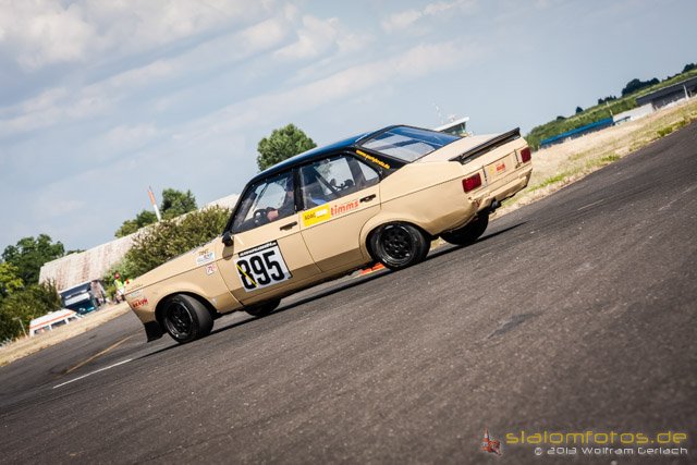

                          We tryed a harder leaf spring on the weekend and the car was nearly undriveable. It runs on two wheels in every corner. I really don“t get it where this is coming from
                          and from another event http://www.youtube.com/watch?v=Qem8vxFNS3Q from 4:29 on
