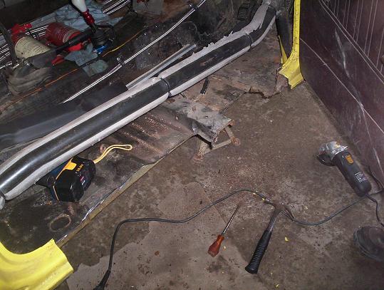

                  In a couple of weeks I'm back at Loton which will be the start of 5 events in 3 weeks, so I thought I'd better sort out the sills on Fly so she can be MOT'd next weekend ready for Millbrook
                  I'd bought inner and outer sills for both sides back in January but hadn't got round to fitting them as the MOT ran out on the day of Goodwood, but today I invited a friend round (who's a lot better welder than me) to weld them on

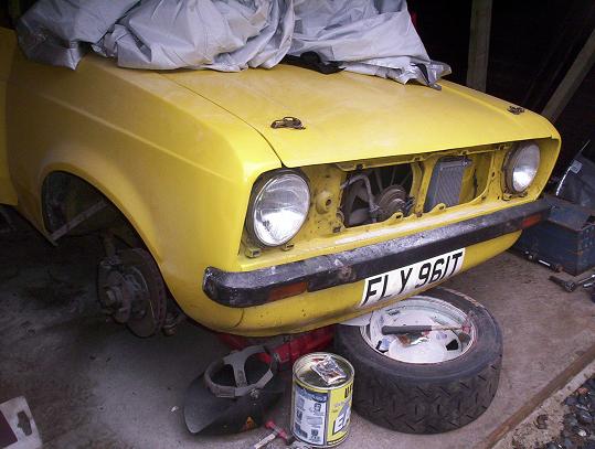

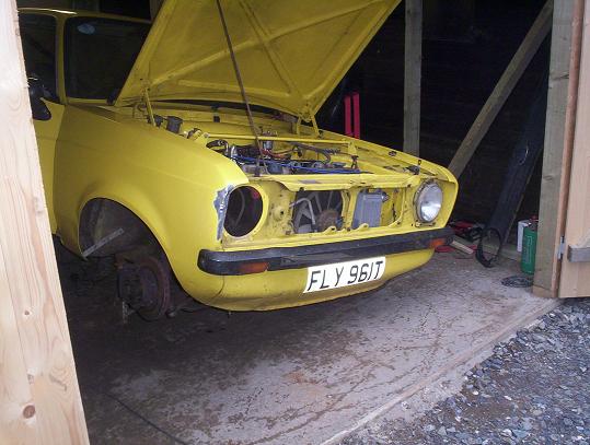

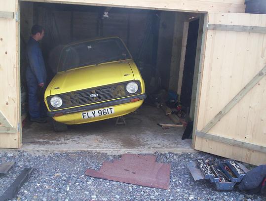

                  Jacked Fly up to get some access - still got to paint the new garage though

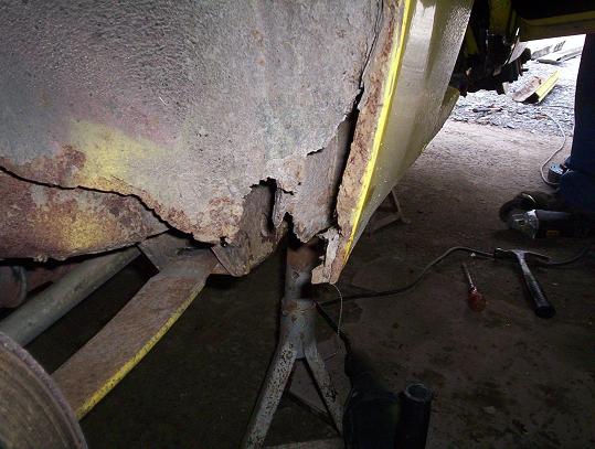

                  Found the passenger side wasn't too bad and I remembered fitting a new outer sill about 6 years ago, so my friend just added a couple of large patches

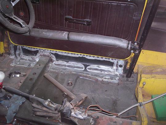

                  Driver side had been patched extensively for last year's MOT but the bottom of the outer sill was rotten again, so the whole inner and outer sill between the rollcage reinforcement plates was cut out
                  And the rear inner arch will need a large patch
                  And my friend used to work in a bodyshop so I got him to knock out the small dent in the front wing from Fat Albert last year
                  By this evening, the whole inner sill was back on, so tomorrow its just the outer sill, the rear inner arch and a bit of filler in the front wing, then I'll underseal and hammerite everything in sight

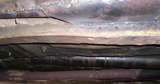

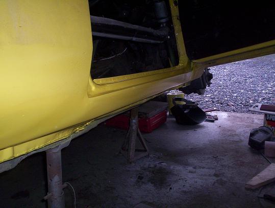

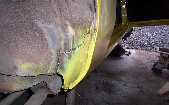

                    All the welding was finished yesterday, so today a bit of filler and paint went on
                    Front wing looking tidy again
                    Rear inner arch repaired
                    Inner sill
                    Outer sill

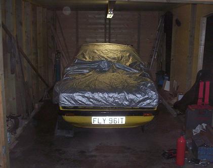

                    And finally painted over the rust on the front bumper and put Fly to bed for the week
                    All ready now for the MOT

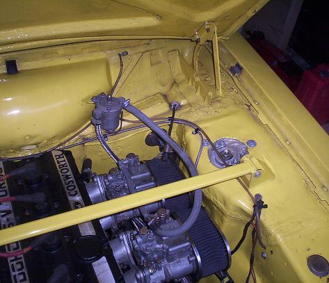

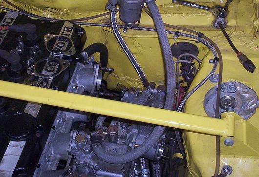

                      Fly passed the MOT on Sat without any problems, but while underneath inspecting her we did notice some fuel dripping from the rear carb where it joins the manifold
                      So I ordered a set of Misab plates from Burtons and they arrived this morning
                      So I spent a couple of hours removing the K&N's and the rear carb to fit a pair of them
                      And all back together again
                      All a bit of a tight squeeze but I've always preferred a large set of K&N's to any other filters
