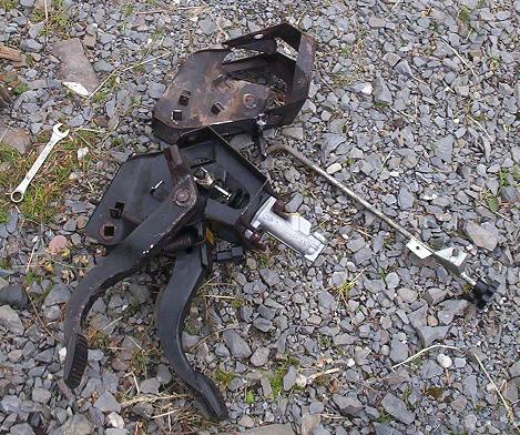

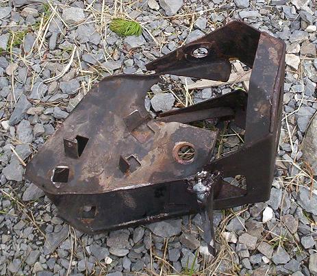

        I had a day off today to get everything ready for Pembrey tomorrow so I spent most of it changing the pedal box
        I'd bought a secondhand Gartrac one off a fellow Turbosporter last October and when the old one was out of Fly I could see a lot of differences
        The one in front is Gartrac and its all a lot more substantial. More significantly, the master cylinders mount horizontally instead of at a slight angle, and there's no need to cut 8mm off the rods as they are further away from the pedal
        Having a close look at my old one, I could see another break in it, and the bias bar & brake pedal bush were seized up so I think every time I braked, the brake pedal itself was binding instead of the master cylinders
        Because the Gartrac one has moved the cylinders, I had to extend some brake pipes but it all went together in the end and is well bled
        I'll discover how the bias is set in 1st Practice tomorrow
