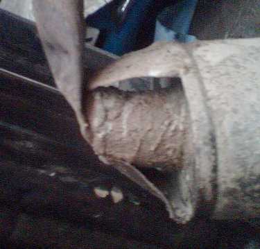

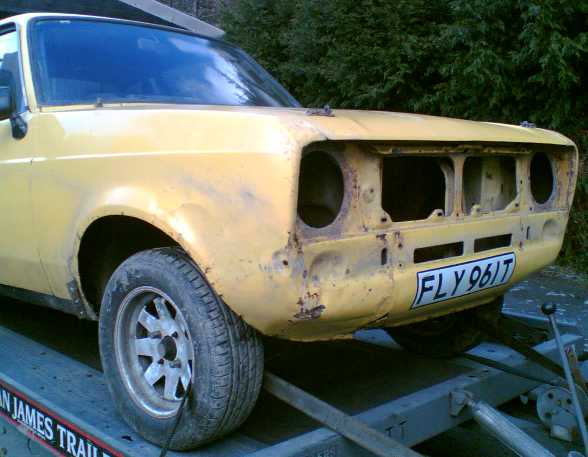

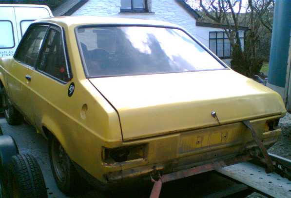

                              Discovered why Fly wouldn't rev too well after damaging the exhaust - I'd reversed into the tarmac bank so hard it had pushed the silencer forwards and bent the panhard rod, resulting in this...

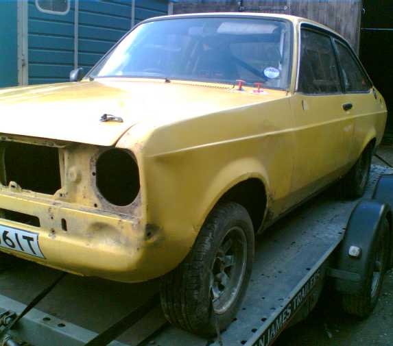

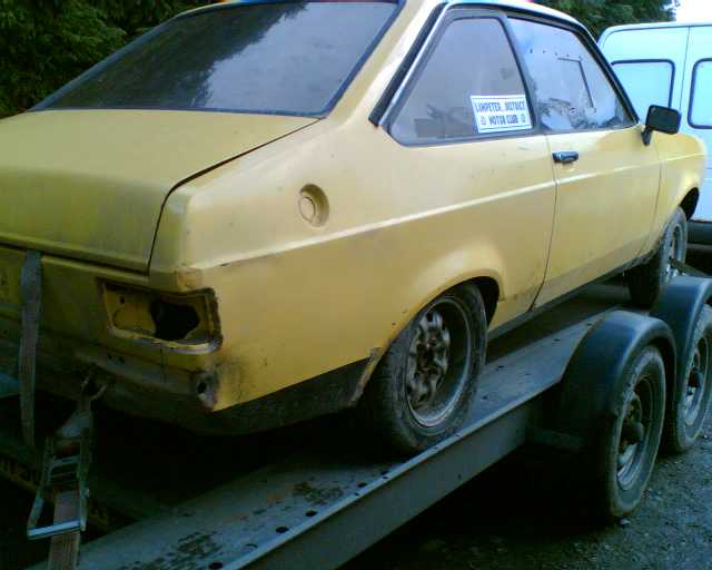

                              Anyway, took some pics after I'd stripped Fly to a rolling shell to go to my friendly bodyshop
                              Always look so different in this state, but should be back in a couple of weeks looking nice and shiny again
                              In the meantime, a local fabricator is making me a new rather narrow axle casing, after discovering that my baby atlas was in fact only a narrow atlas I need something a few inches narrower to fit my 8" slicks
                              Then I'll have a few weeks to put it all back together for my first Sprint in late April

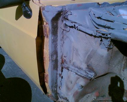

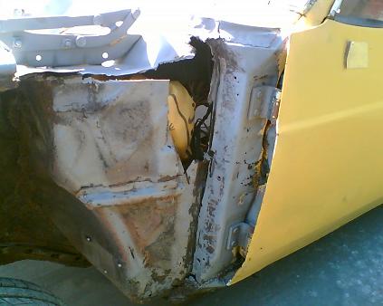

                                Had a call from the bodyshop a couple of days ago to go and have a look at Fly - they'd taken the old panels off and found a few 'problems' underneath so suggested I take her back and weld everything up before the new panels go on
                                Picked Fly up this morning after the engine bay and surrounding areas had been sandblasted so I can see how much there is to do
                                The good side
                                A few more problems on this side - not even attached to the door pillar anymore
                                No wonder it was a bit drafty on night events!
                                And the strut tops are rusting through from underneath the repair panels, the edges of the bonnet slam panel have disintegrated and the lower front inner wings are mangled where the front panel welds on
                                Looks like I'll be busy tomorrow - only 5 weeks to go before the first Sprint!
                                Although it's been at least 12 years and countless rough events since the last set of front wings and panel were fitted so she hasn't done too bad
