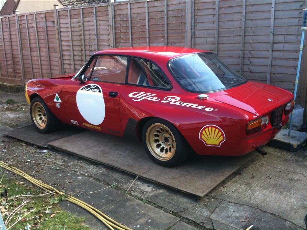

      I went slightly bonkers after Xmas 2014 and also been offered good money on my classic Wolseley 12/48 series 3 . With this in mind , I started to look around for another interesting vehicle to replace the Wolseley when sold. However , having seen an ALFA ROMEO 2lt GTAm replica but with standard engine and suspension , I thought one of these wouldn't come up for sale very often ------------- yes , I bought it. Still got the Wolseley though so not popular with her indoors !
      Having caught the Alfa bug when buying my 159 2.4 ti tow car , I've just bought GTAm 15X8 Repro alloys and R888's AND stiffer springs with Biltein shocks , adjustable top arms for camber tweeking too. [ATTACH=CONFIG]73782[/ATTACH][ATTACH=CONFIG]73783[/ATTACH][ATTACH=CONFIG]73784[/ATTACH]

Name:	IMG_1167 (Large).jpg
ID:	2014926Sadly the 2lt NORD 105 engine has gone pop ! ----- ---- I've got the new lowered uprated springs and shocks/ARB fitted plus adjustable top wishbone arms and new wheels/tyres. I've set the camber/castor and toe up which has transformed the handling. Then I warmed it up along the local carraigeway before intended oil/filter service for about 3 miles . It was doing this and nearly back home when power dropped off and white smoke bellowed from the exhaust !!! I assumed it was water vapour/head gasket issue BUT there's no water on the dipstick and no oil in the radiator , also it didn't boil either. I drained the oil anyway , changed filter and refilled . Started her up with a struggle and she ran on 3 cyl's . Left it ticking over while I washed the car without any hint of white smoke then after 15 mins it smoked again , bigtime. Switched off to find it had eaten 2 lts of the new oil !!!
                  Had a chat with other Alfa NORD guys and one suggested head gasket but around an oil gallery/O ring . There's no knocking at all either so not a bearing issue fortunately. Who's the best ALFA 105 Nord head man for a rebuild/upgrade ???
