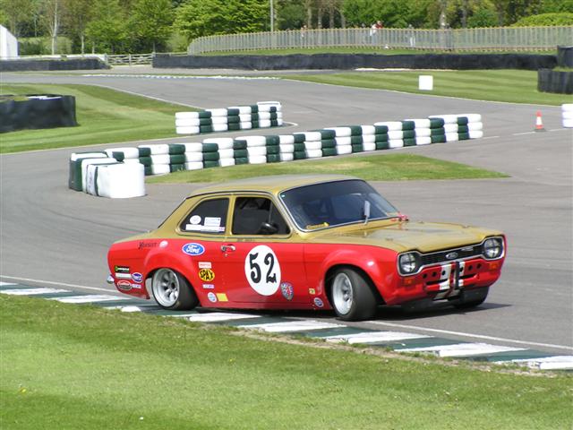

      [QUOTE=Stylussprinter;1693229]The pics ..
      space framed Escort trying hard to beat my time , exiting Goodwood's chicane. 15th May 2010.
      QUOTE]
      I'd say he wasn't trying hard enough (or maybe trying too hard) Out of interest I looked up both of your times,he did a best time of 102.24, you did a best time of 95.48..........Last time I was at Goodwood in my Escort I set a best single lap time of 98.76 . I ran in modprod class 9 btw

        Re: Stylussprinter's Stylus
        [QUOTE=Pushrod King;1734339]
        Originally posted by Stylussprinter
        The pics ..
        QUOTE]
        That's a really quick time in a '' real '' Escort without coilovers and normal weight etc . I'm around 3 sec's off my best ever single lap at Goodwood but that was a few years back . My best flying lap is 91.8 sec's but NOT in recent years .

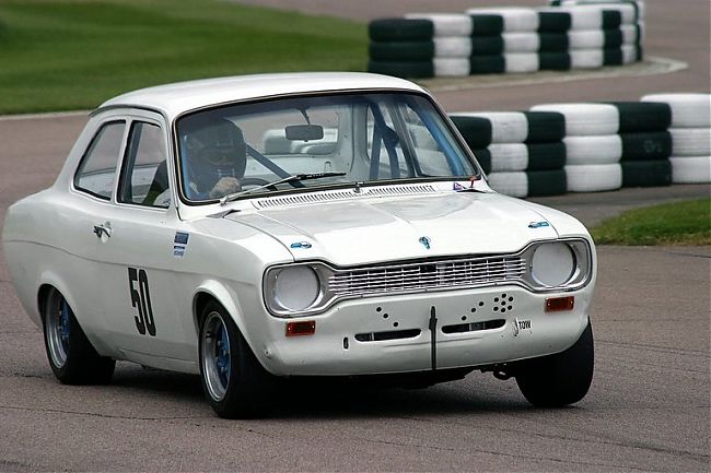

            Here you go:
            I won my class in the all circuit championship and both acsmc championships in 2007.That was on 6" wide wheels and with a 1700 crossflow,I Think I'd be even faster now with 8" rear and 7" fronts and the new 1800 crossflow.

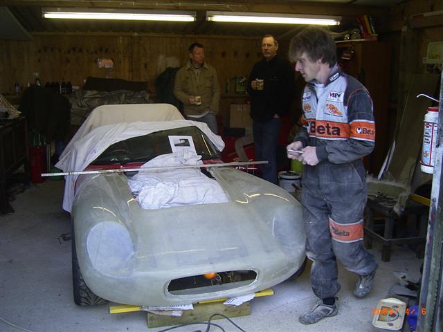

                      The pics ..
                      18)Tim Benbow SSC Stylus manufacturer making the first cut . I'd already designed the hinge system to allow full opening before the body came .You can see he's in thinking mode ---- think twice --- cut once .
                      Hi Mate
                      I was reading through your thread with interest as a good mate of mine had a very nice Vauxhall powered Stylus and I was interested in your starting problems when bugger me this last pic, there is my dear friend Andy Bailey who as I'm sure you know passed away last year very suddenly of cancer. RIP Andy
                      Made me laugh though as he always had a cuppa in his hand
                      So how did you know Andy? Do you know his bruv too?
