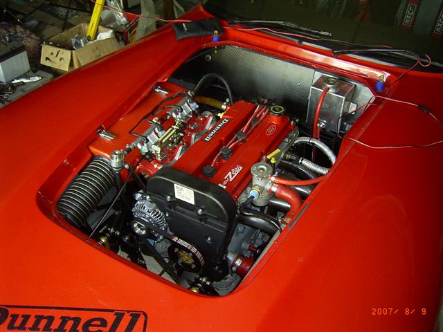

    Engine is a 2lt zetec which I built with Dunnell head,cams,verniers,engine mgt. Sump,flywheel,clutch,rod bolts from Raceline.It runs on Weber 45DCOE's and is turning out 170bhp @ the wheels. Apart from re-jetting , changing chokes to 40's from 36's at first build and fitting full radius trumpets , the engine is the same now as in 1999.

            Wooow very nice you have any engine shots Gary?

                    Got pic's of repaired car plus engine shots but can't upload on here . I'm used to uploading via a browser to '' my pictures '' on the PC so stuffed

                        The pics ..
                        1)flip open after repairs showing my kevlar engine guards cut from second hand floor panels and gold heat reflector over heat mat , curticy of a friend in F1.
                        2)2008 Abingdon chicane with engine upgrade but still sporting a one piece body.
                        3)upgraded engine just collected from Paul Dunnell . This is my original block and head that ran on 45's until 2006

                        10)upgraded engine installed before body damage with own made airbox fitted to house 115mm's trumpets.Air pipe 100mm's to grill filter.
