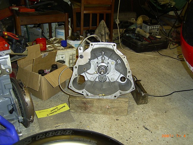

                    Haven't got the engine out yet but once I'd removed the flipfront then tried the clutch pedal , I noticed the gearstick move a touch. Looked in the cylinder -- it was only half full plus had gel type gunge around the edges , so got underneath to check the box rubber mount with a bar ------ the box moved a couple of mm's away from the bellhousing face . I'm assuming now that either the housing has cracked around a bolt or bolts have sheared and this misalignment has allowed the input shaft to put the box bearing/seal to a leaking position. Hence the oil leaks and juddering.
                    Today she's coming out so we'll see for sure .
                    • Stylussprinter
                      • Sep 2006
                      • 347
                      Re: Stylussprinter's Stylus
                      Engine's out , bellhousing's intact but there were '' NO '' bolts holding it to the box . How they came loose I just don't know --- I'm a bit heavy handed spanner wise as a rule plus they were threadlocked. Two bolts missing(out through the two holes in the ally housing I guess)and two bolts hanging around in the bottom --- one in front of the flywheel the other behind it . Flywheel's chewed up pretty badly too so it will have to be replaced. The clutch cylinder was half full and bits of gel type stuff in there and the actuator pipes weren't tight either , hence the hyd oil along with the box oil absolutely everywhere. The input shaft had no real play in it so not sure why the oil was leaking out but once I take the actuator apart to check it maybe it will be obvious .
                      Haven't removed the clutch yet but can't see any springs broken so it's possibly ok . Gearbox may need a rebuild .
                              H'mmm , I'm still not sure we're talking about the same bolts so have attached a photo showing bell housing to box '' 4 bolts '' that dropped out .Click image for larger version
Name:	Hydraulic conversion.jpg
                                Ah ok, i used to lose engine to box ones. You can still use the nordloc washers on the others though, they stop any vibration shaking the bolts lose. I would keep an eye on the engine to b/h bolts too still though.
